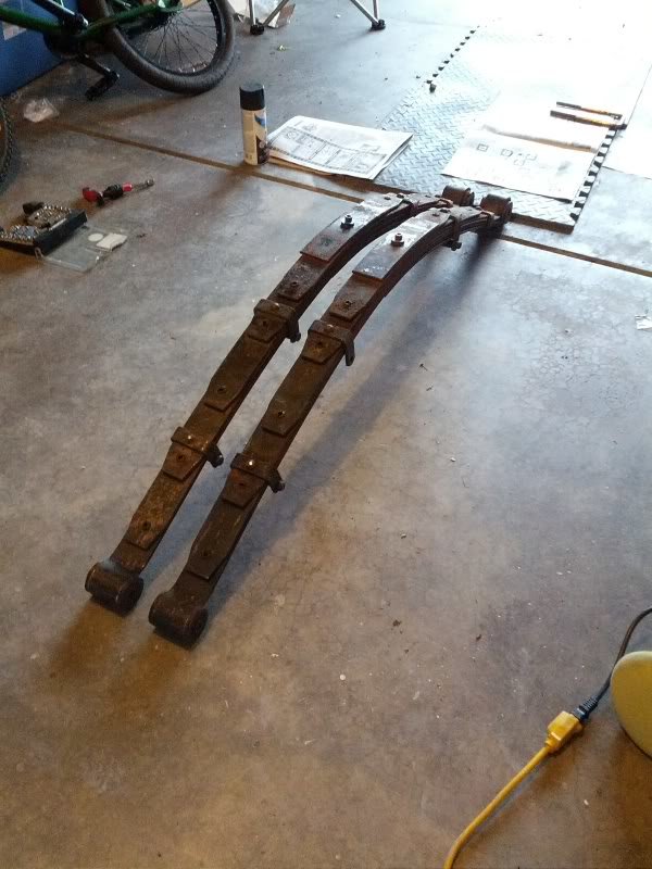

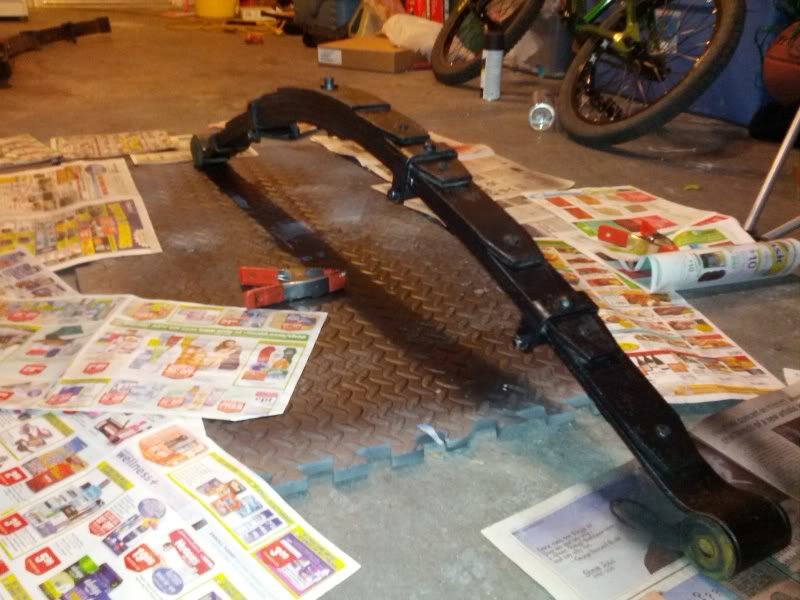

    Rusty all poos came in today. IMG_20120412_154236_7c7d26730caa00a55e26f895fa700e79682ec2bc.jpg
    Cleaned em up with a drill and wire brush attachment and repainted, good as new.
    Let us all rejoice.

    weird they were rusted but owell. those are a good choice for sure

    Steven said his had surface rust within a month, so apparently all pro needs some lessons on paint selection lol.

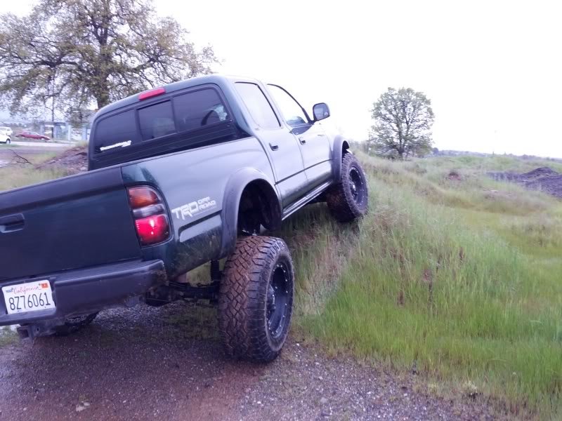

    Weird I checked this one minute after you posted lol. Yeah man went to Anderson and worked in my cousins shop. Finished a bit ago but had to rush to dinner had people waiting on me lol. Made a quick stop on hilltop :)

    Need to extend my bumps a little more. The leafs have more negative arch than I would like when stuffed.

    what are you thinking? bout half inch or more?

    Half inch should suffice. Have any more square tube scraps?

    yeah, easiest might be to just double up some 1/4" plate i have and weld that to the existing bumps.

    How big are those spacers your running?
    Any rubbing issues?

    Top plate spacers? 10mm. I rub frame at full lock. Everything else has been cut or hammered down.
