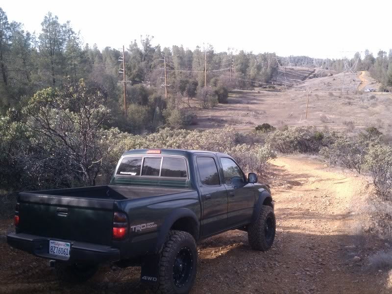

    No mods recently unfortunately, hopefully have enough for a leaf pack soon though. Figured I'd throw some pics up from today at least. Enjoi

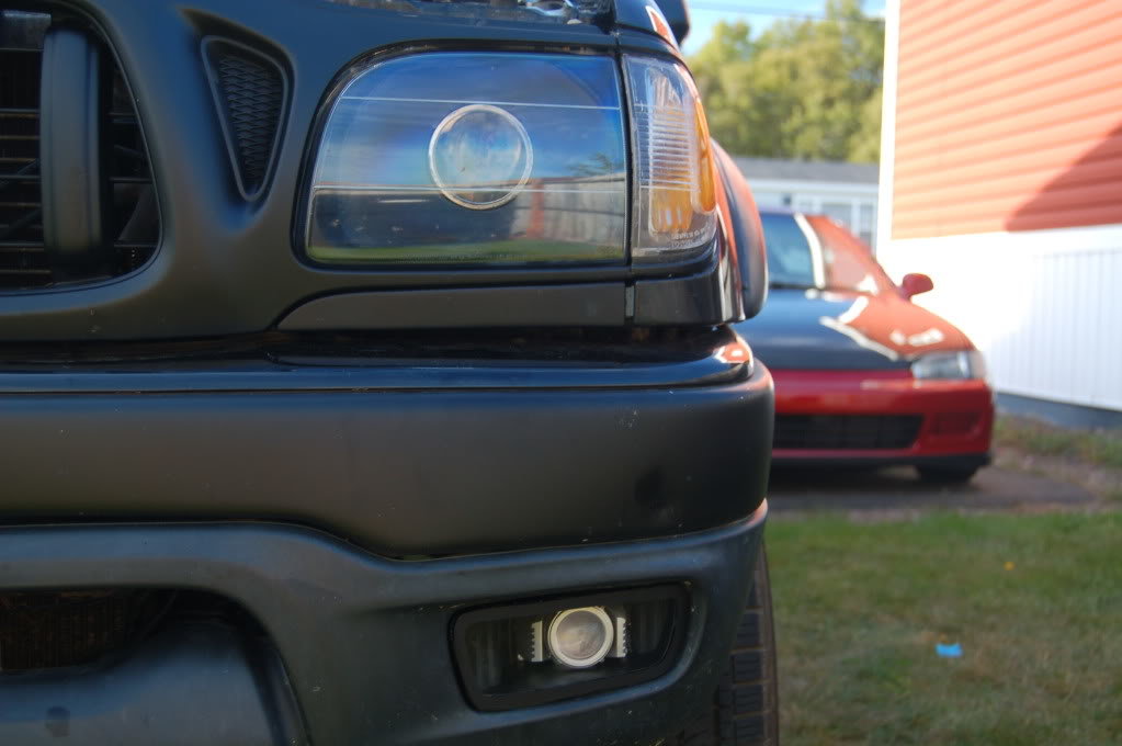

    This is the only picture I have of the fog light retro atm.

    Nice, looks badass. You need to take some output shots lol.

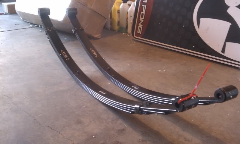

    Finally getting a leaf pack. Bought some downey leafs from a member on the forums. Now have to decide what height I want out of them. 2.5" with 3 leafs, or around 3" if I leave the overload in. Can also add the 4th leaf for closer to 4" but that will wait until I get longer shocks :) . Right now I'm leaning towards 3 leafs with overload in...5100's may limit downtravel a bit though.

    A package arrived today...

    You will need to relocate you shocks like I did for full travel.
