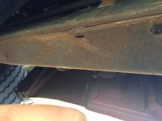

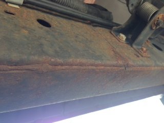

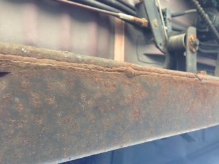

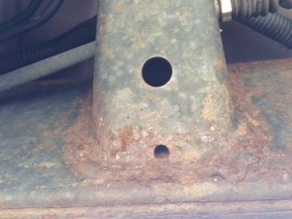

    Took a couple of pics of my '04 frame. Long story short, I'm the second owner. Called Toyota USA, I'm not covered due to the fact the original owner did not do the warranty work by 2011. First owner says he never received any notice....either way, I'm on my own. Not whining, just want to get it under control.
    I just want to take precautions...so here are a couple of pics. Guy at my work says he restores cars and not to worry....But I worry. I started grinding today just to see how it will go.
    Please give me your input....I did the hammer test and it's strong...just some minor flaking in the rear.

    That looks like its just surface. Get ahead of it before its a problem.

    I would coat the frame before it gets worse

    Check the front hanger of the leaf springs. It tends to rust out before the rest of the frame.

    From the pics, that we have seen; the frame looks to be in good shape.
    Take another look, as KenLyns mentioned; and with a small ball peen hammer, lightly tap that area.
    But look good so far.

    It's ugly but it looks like normal surface rust. Our Honda CR-V has double the miles of my Tacoma in Utah winters, and the subframes still look brand new, not even a speck of surface rust. I wonder WTF Honda is doing different?

    take it to a good body shop and have as much of it that is visible sandblasted and have them shoot a coat of POR on it then a couple coats of any color paint you can get for a decent price to lower the cost of the repair. The POR and blasting is going to be a couple hundred plus a couple hundred for labor. Your frame is in good shape now but will deteriorate really fast if you don't stop it now. The inside of the frame is already rusting out and you can do almost nothing to stop it. Your main goal right now is to stop the outside of the frame from getting any worse. with a good blasting and POR you will get another twelve to fifteen years out of it.

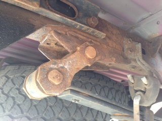

    Mine looked way worse then that when I had it replaced

    Thanks guys. I think I'm going to just have to drop the $'s to get it sandblasted and coated. It's cheaper than buying a frame.
