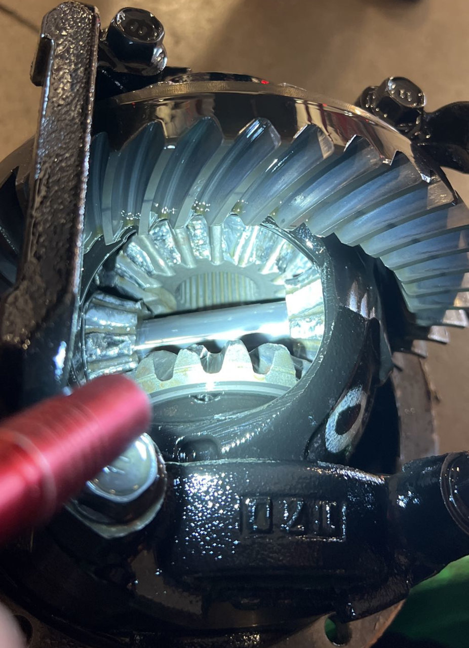

    Fun week camping. Fun day on the trail. Got to a ledge I got 1/2 up and slipped on.. (So, I had the throttle down, wheels were slowly spinning, but probably sped up considerably when I lost traction, then hit the ground and stopped.. just a few inch drop) it made a clunk sound. I got up the ledge and heard a couple other 'clicks' on the rest of the way down the trail... They weren't that loud.. Got to the trail head and put it in 2wd. The drive shaft spun, but the wheels didn't.
    I put it in 4wd and used the front wheels to slowly drive me back to civilization. Was about 60 miles.
    Toyota dealer was the only place open at the time, so I took it there (and their website made them look like an independent shop. I was surprised when I arrived). Several days later, they decided it's probably best for me to have the work done somewhere else. I have aftermarket gears (different ratio ring and pinyon). I don't think they were comfortable getting in and replacing the gears.
    I'm in a different city.. Had to remotely find a gear shop. Had to find someone to tow it from Toyota to the gear shop. It all went very well.. At least so far. It's at the shop now. They specialize in this sort of thing, and seem to have the situation under control.
    I should have told them to put a locker in there, instead of new spider gears. Called and checked, and they've already got the parts on the way.. Maybe next time.. (heh, hopefully there is NEVER a next time).

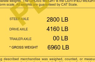

    Always.. It can't really be removed. (w/out a lot of work and disconnecting things, etc. It's not like factory, anymore.. (camper or truck))
    And, I recently had it weighed...............
    So.. I'm definitely pushing things. But I've been on much rougher roads than the one that broke my truck.

    Damn. My 3500HD is 7600 lbs...:rofl:
    It may never happen again. I do agree that if you had a locker, less skinny pedal would be needed to accomplish the same terrain.
