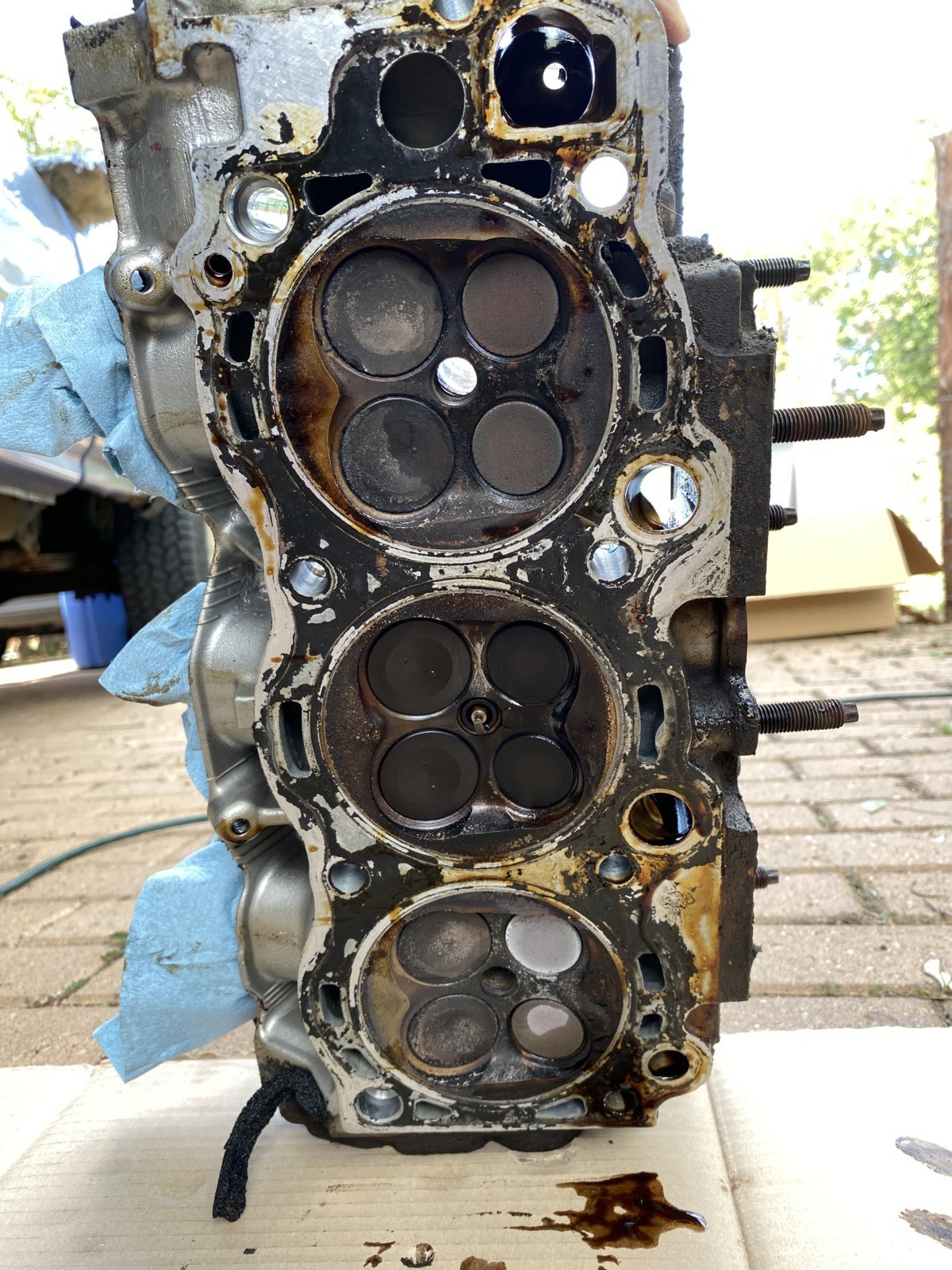

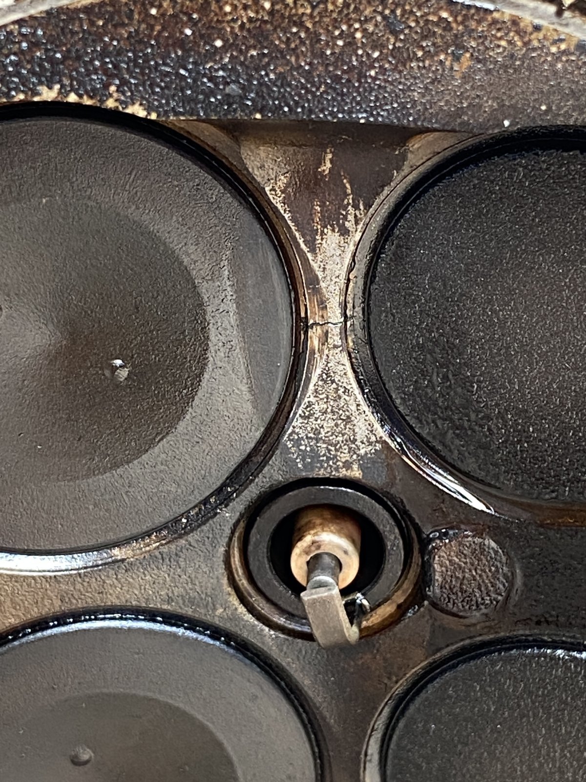

    Update: pulled heads yesterday, found a crack between the valves. Looks like I’ll need to find a new one. The other is getting machined and tested this week.
    Looks like the bypass pipe was not the complete issue. But I am wondering if one is the symptom of the other? Is that possible?

    Did the coolant level ever get low? If the leaking bypass pipe was ignored and the coolant got low enough to overheat that could crack the head
    Or it just cracked from bad luck. Who knows

    The coolant did get low multiple times over the course of two years but I was pretty good at monitoring it. And I would only notice it low every couple months, so it was a very slow leak. It must have gotten too hot just a minute too long cause if I ever noticed the temp gauge start to creep up I would stop immediately. Maybe that repeated cycle finally cracked it. This truck has had 3 owners so who the heck knows if it ever overheated during their ownership.
