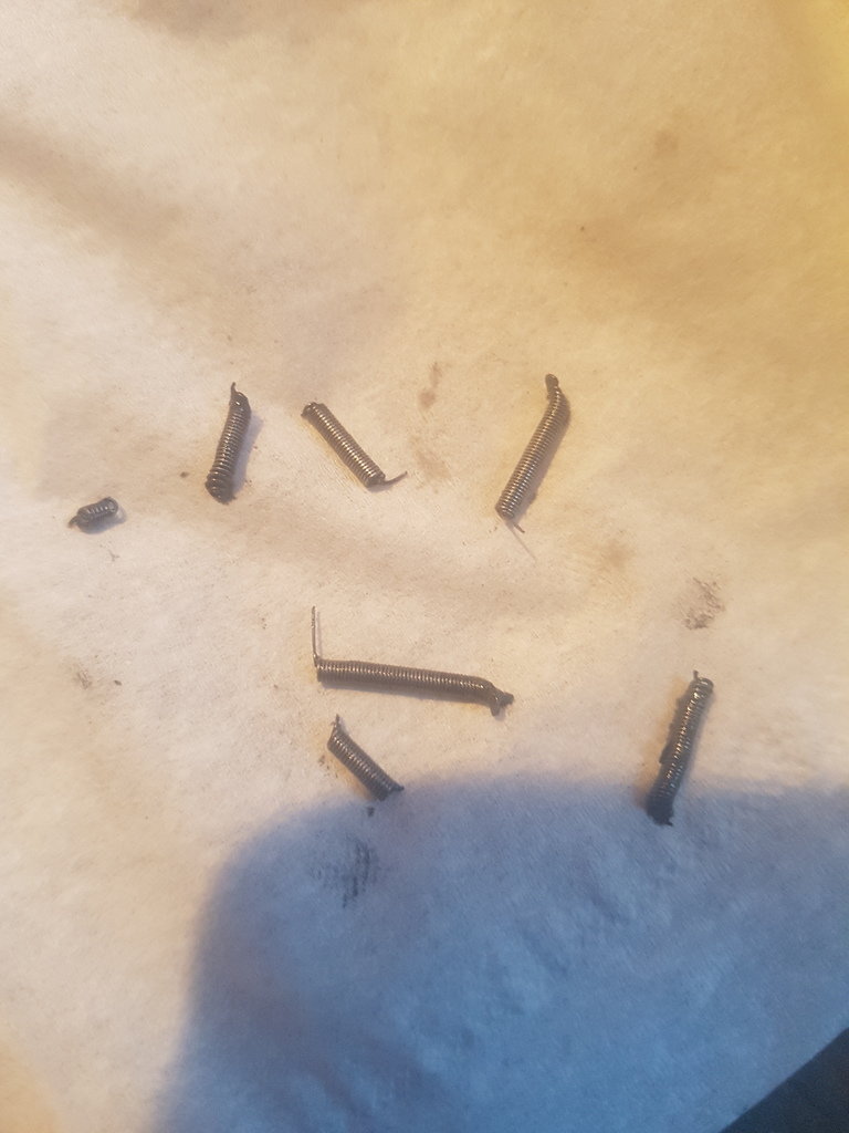

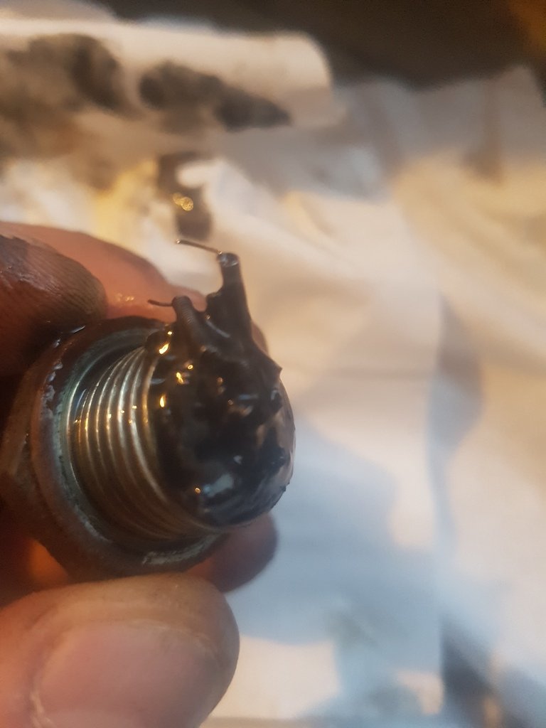

Look what I found on my rear diff drain plug

    looks like youre getting new gears for christmas

    Yeah, that's not supposed to be there.

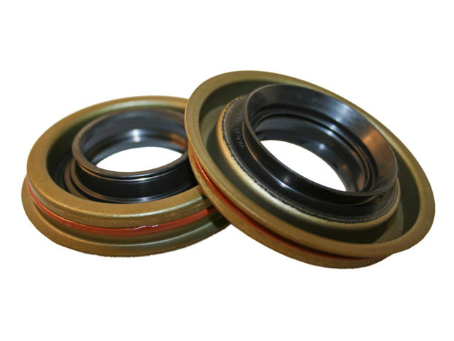

    I'm assuming it's from an axle seal

    There little peices of springs. I'm guessing from the axle seal since iv noticed a bit of oil
    In the rear right rim

    They do have that look of the lip seal. That or something like a limited slip or Aussie locker went bang.

    That’s what I was thinking they looked like, little springs.

    It's an open diff . How involved are these seals? Someone quoted me 600 a side Canadian

    That person is not your friend. Prolly get that done for 50 to 75 each side here in Atlanta parts and labor. You do need to replace both seals.

    Are those worm gears?

    It's kind of a PITA but not really a super technical repair. You have to pull the axles completely out, which means removing the drums and shoes, disconnecting the hydraulic lines and parking brake cables. Seems kind of high but it's a fair amount of work since you have drain and refill gear lube, bleed the brakes. It's something you could do yourself if you have a Saturday and maybe a buddy to help.

    I agree with @tomtom, bearings depends on miles/km and condition. When you pull the axle you can assess the bearing but if it's never been done on a 2001 I'd expect to do it.
    The inner axle seal isn't a bad job but replacing the bearings and outer seal is a step up in pain and you'll need a press. Still probably not worth $1,200 but getting closer.
