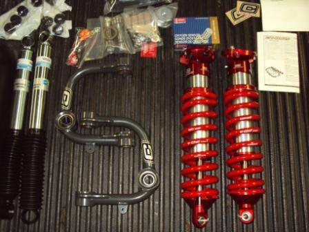

    My new suspension from Wheelers Offroad just came in heres what i got
    -Camburg 2.5 Coilovers
    -Camburg uniball Upper Control Arms
    -Bilstein 5100's
    -also my rear o2 sensor from autoparts warehouse came in to
    For some reason some Tootsie Pops came with the Bilstein 5100's.
    Going to start the install of everything tonight and work away at it for the next few nights after work. Im missing the spanner wrench for the coilovers but hopefully wheelers will send one up to me.

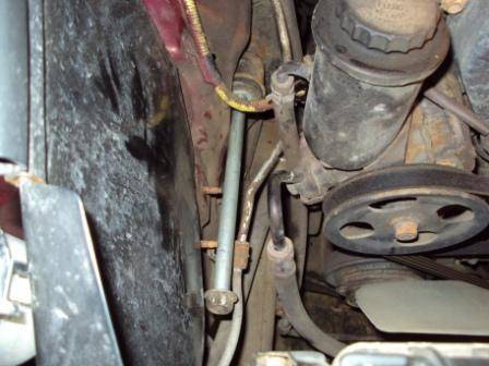

    you should pick up one of these too. it will help when you get bigger tires on there

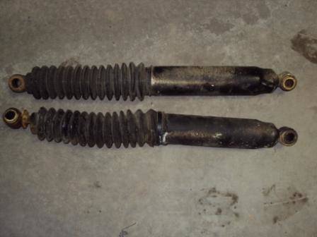

    just finished installing the 5100's and put in the new o2 sensor, heres the old pro comp shocks covered in undercoating

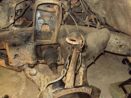

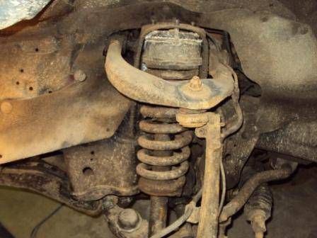

    continued on the install tonight heres what i started out with
    and heres where i finished off for the night.
    removed the ucas and coils from both the driver and passenger side. I spend at least 2 hours removing the ball joints,ive never seen balljoints not want to come out that bad. Another pain in the ass was getting the bolt out that holds the uca on the passenger side. I had to cut and bend some of the wheel well out of the way,move the washer fluid jug,and move a couple of brackets that hold a wire and some AC lines to the wheel well.

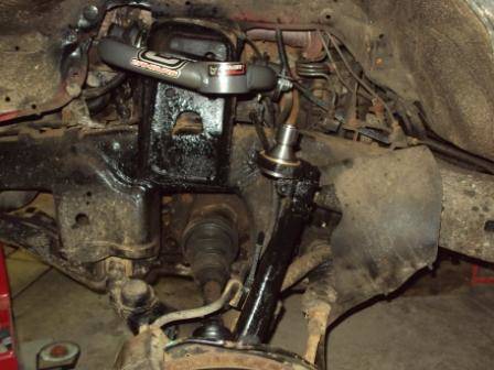

    worked on er again tonight. got the new UCAs and the slug adaptors in on both the driver and passenger side. heres what it looks like now
    the driverside uca seemed to put up more of a fight goin on then the passenger side did. theres no wiggle room at all so its kind of a battle trying to line up the M14 bolt with the 4 washers and the sleeves. Had to trim a bit of the inner wheel well to allow for articulation of the UCA. So Far so good though, i should be able to finish it all up tomorow night.
