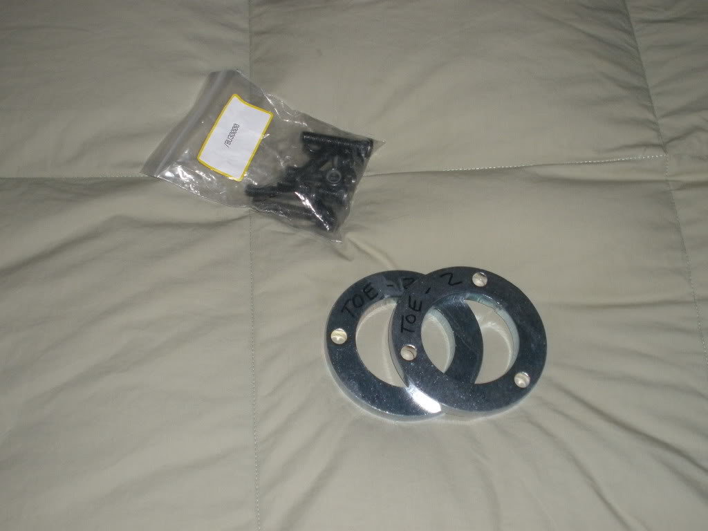

    Just arrived from the UPS man
    My Trim Packers
    good to go now anyone have a write up on how to install these

    Actually, those are "Lift enhancers". Trim packers install under the spring seat on the shock. :)

    pretty sure with how tall your bolts already are man.....we can take the coil back out and set these on top, then put them back in. coil assembly may not even have to come all the way out.

    X2. As long as he already has 10mm of threads showing on his studs, they would go right in.

    yeah man.....we left the "studs" in there from when we took out his spacer lift and installed my old coils and 5100's.................them sumbitchs are about an inch and a quarter long! plenty of thread!!:D

    Well, Shit. Its gonna take longer to jack up the truck and remove the tires than to install them. :)
