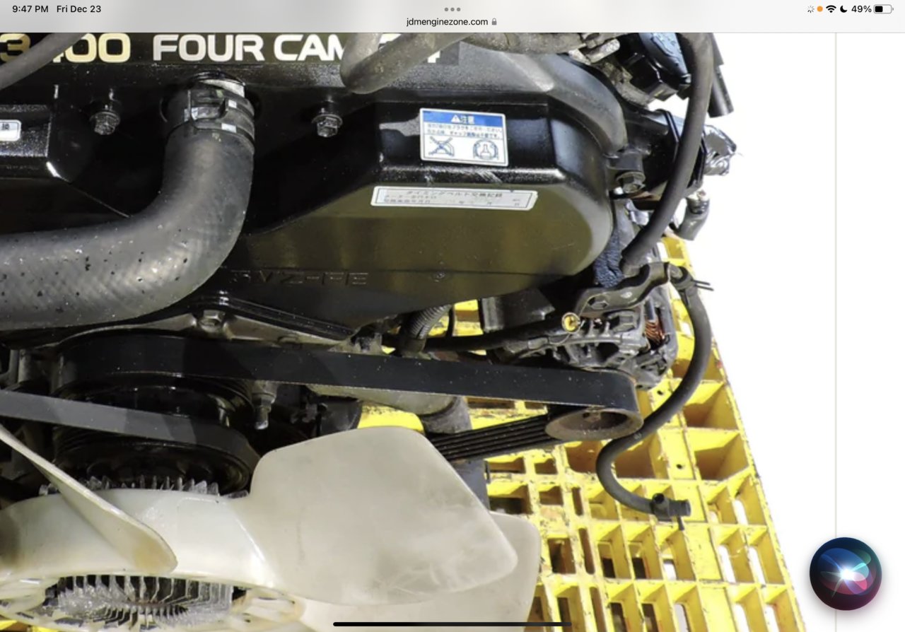

  8. Dec 23, 2022 at 8:19 PM
    02hilux
    02hilux What do you mean there’s no road, I’m here
    Sep 14, 2016
    #197244
    6,350
    Planet: EARTH
    It will be point less not to provide a 6 rib crank pulley if the SC pulley is 6 rib.
    Bivouac likes this.
  9. Dec 23, 2022 at 8:21 PM
    02hilux
    Sep 14, 2016
    #197244
    6,350
    Planet: EARTH
    Yes OP, wait until these folks decide to upgrade and buy their used charger. Nothing wrong with buying a used charger.
    95% off these folks bought used first gen as well :rofl:and the amount of $$ they spend to keep it dated far exceed the charger.

  11. Dec 23, 2022 at 8:23 PM
    02hilux
    Sep 14, 2016
    #197244
    6,350
    Planet: EARTH
    Don't answer the question I ask. Pointless to have a 6 rib pulley of your still running a 4 rib belt. The purpose of more rib is to prevent belt slippage.

    Easy, just figure out how to get a 6 rib crank shaft pulley for the superchargers 6 rib pulley
  14. Dec 23, 2022 at 8:31 PM

    i have a feeling the 6 rib is just on that unit because its a pulley they had laying around to show off. i bet they'll ship with 4 rib

    You're making it sound so easy. What about the alignment of the AC and Alternator pulley? It's not a 1 belt system, it's a 3.

    More than likely it will be a 4 rib pulley and because the rotors will be much larger pushing more air I bet the stock pulley will be close to 4” and that will not be a problem slipping, will have to see

    If your not aware the Japanese 3.4 JDM motor actually runs a 6 rib belt in the same place we’re the USA version runs a 4 rib belt.
    The problem trying to convert this is the fan bracket snout is a different length than the USA bracket and you can’t get that bracket here.
    The JDM motors are all setup with the 6 rib belt, so there is a way if someone wanted to do it
