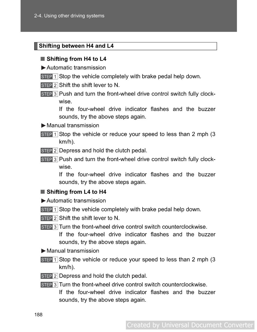

    Clutch in for Manual trans, Neutral for Auto trans.

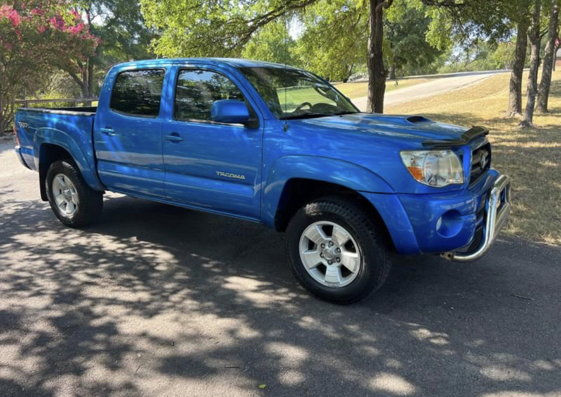

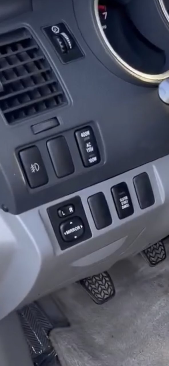

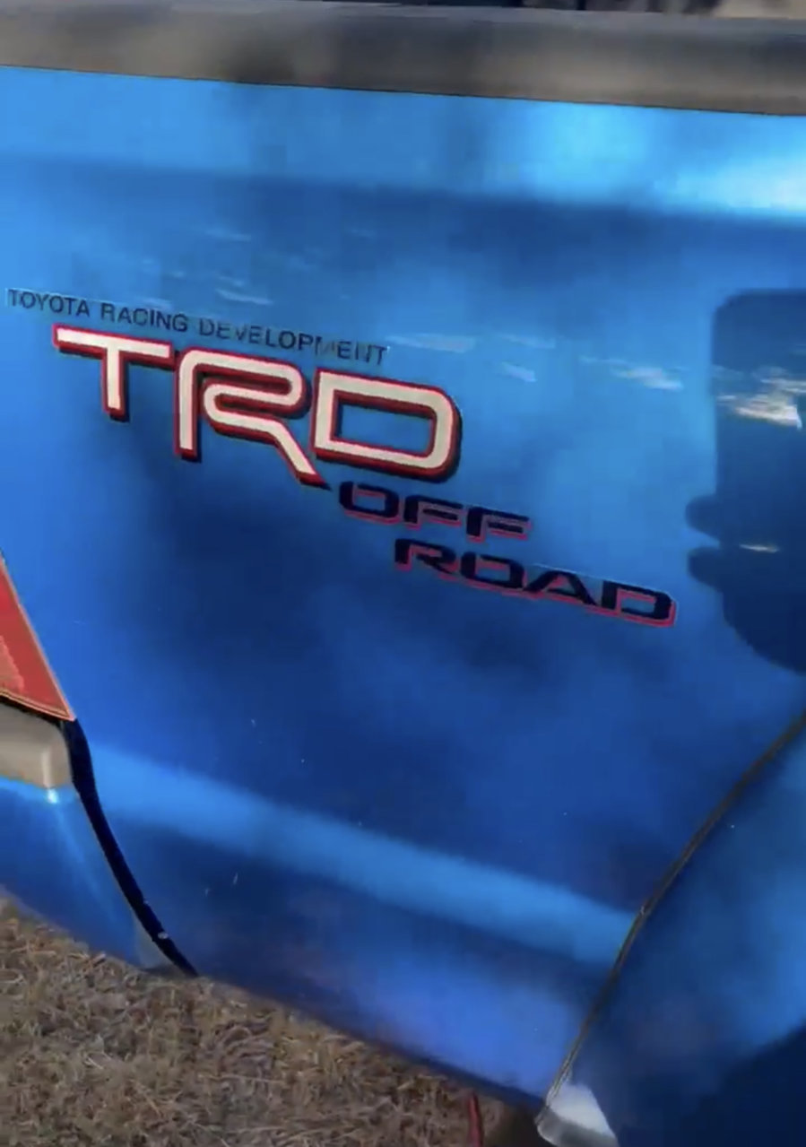

    One issue I have is in photos/videos I’ve been sent it says it’s a TRD Off-Road but it’s missing the Diff Lock button next to the 400W/100W button. Is there a TRD Off-Road that didn’t have the electronic locking diff?

    No. All Off Roads come with a rear diff lock

    Nope all TRD OffRoad trucks have the E-Locker, it's actually exclusive to TRD OffRoad models.
    Not uncommon to see non TRD trucks with TRD stickers.

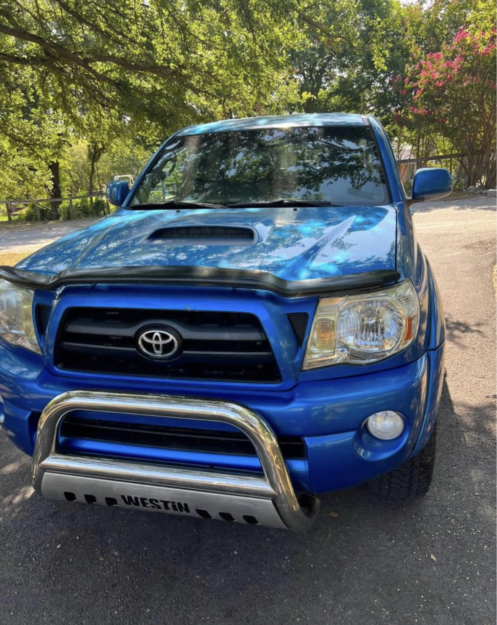

    Being it has a color matched rear bumper and inverter but no locker I'd say it's more likely a TRD Sport, does it have a hood scoop?

    The diff locker button could have been removed. Not sure why, but possible.
    More likely that it’s a sport though.

    Can always look under it and see if it has the locker motor on the rear diff.

    Maybe y’all will notice things in these photos I don’t. What’s the hood scoop mean?

    Sport rims and hood, probably a TRD Sport
    The scooped hood is unique to the sport. Although many are known to swap hoods. We have threads for it on here.

    It's a sport with Offroad decals.

    So, other than the electronic locking diff (which I’m bummed about) what else am I missing on the Sport? Or what does the Sport have that maybe the OffEoad doesn’t?

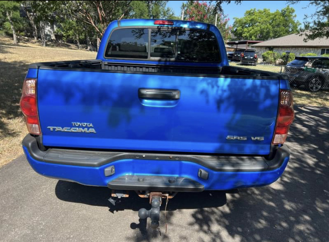

    Receiver hitch is kinda rusty looking, make sure you take a good look at the underside of the truck.
    Looks pretty clean otherwise.

    Mechanically the only difference is the locker, Sport models have a mechanical limited slip diff and the shocks are tuned a bit different.
    Otherwise the differences are just visual (color matched mirrors & bumpers, hood scoop, wheels, etc).
    Now on 09+ models the OffRoad trucks also had A-Trac which was an enhanced traction control mode that used the brake system to stop any wheel that loses traction and allow the truck to move if at least one wheel has traction.

    Looks like I’ll also be missing out on the cool set of buttons below the climate controls with the USB/Aux spot as well.

    Those weren't on earlier 2nd gens, I think 09 is when those were added.
