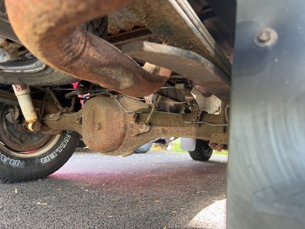

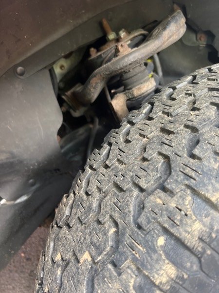

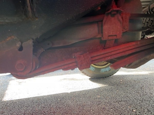

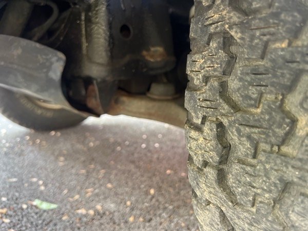

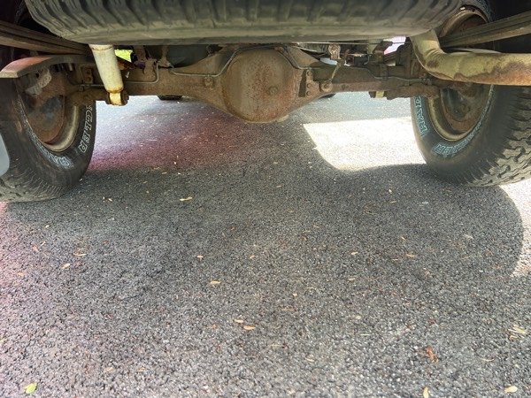

    Looking to buy one..
    Hi guys,
    new to the tacoma forum, but I've been looking for a few months for a first gen.
    I found a '98 with super low miles (55k) and a damn good price (11k).
    But it looks like there is rust underneath and that just scares me.
    Is this enough to worry about? I live in NC and they don't salt roads here so I'm guessing it wouldn't deteriorate further?
    Thank y'all for any advice!!

    Those pictures make it tough to tell. There definitely appears to be some sort of coating on it, could be rust. I'd look in person or ask for better photos. Being in North Carolina is a good sign. Check the carfax too.

    Not too hopefully wear thin on y'all generosity in advice... but I got more photos...
    It does seem like the actual frame is solid. But that maybe that axle looks bad?
    Appreciate any thoughts ...

    your 3rd member definitely needs some TLC. I use Rust Stop from Ace Hardware and then paint everything black.

    Just surface rust remove as much as possible then prime and paint.
    Here just sitting outside the damp climate surface rusted a almost perfect truck .
    Even new steel in the rack will rust if not coated in my shop never exposed to winter chemicals.
    Even so your frame should see attention to help it last for ever.

    Worth checking the breather valve on the rear axle to make sure the cap still jiggles. I doubt yours has rusted solid based on the pics, but if the breather valve stops working it can push gear oil past the axle seals. Congrats on the purchase!
