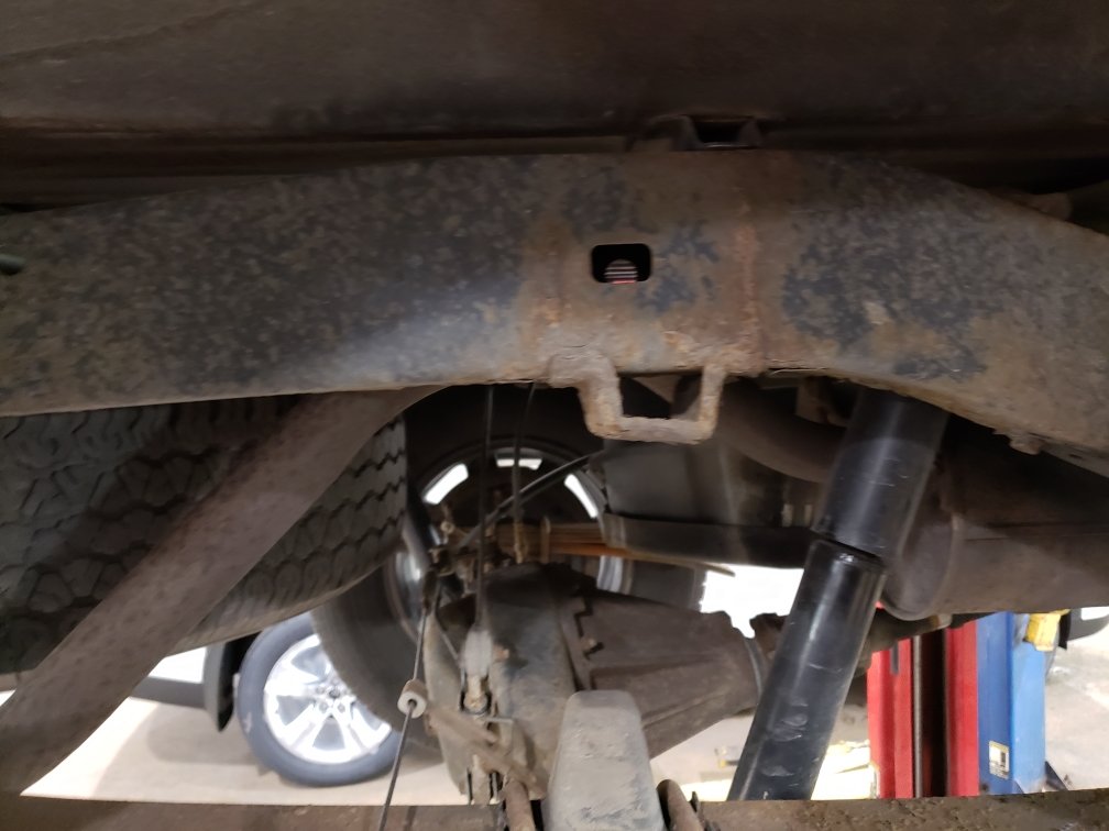

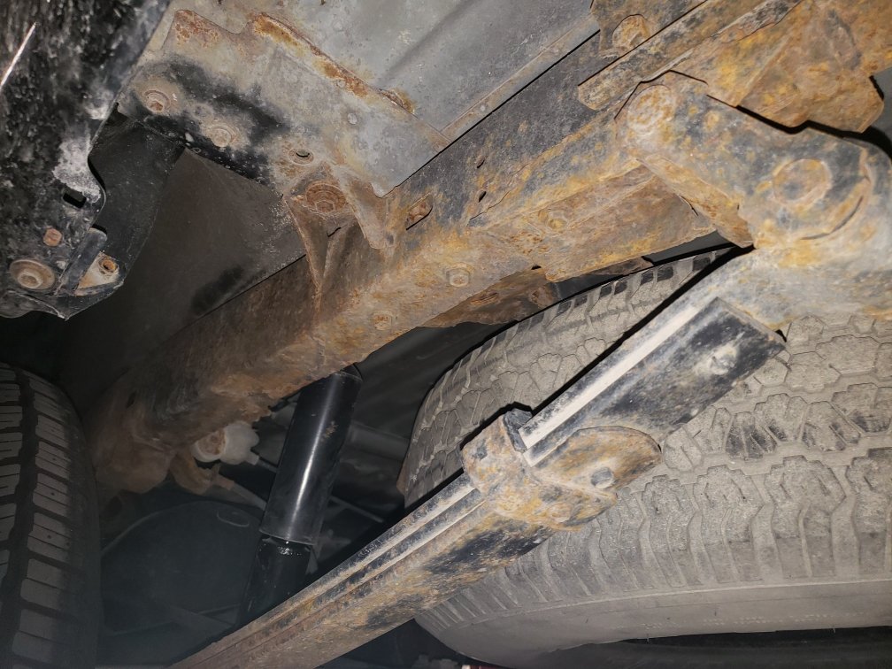

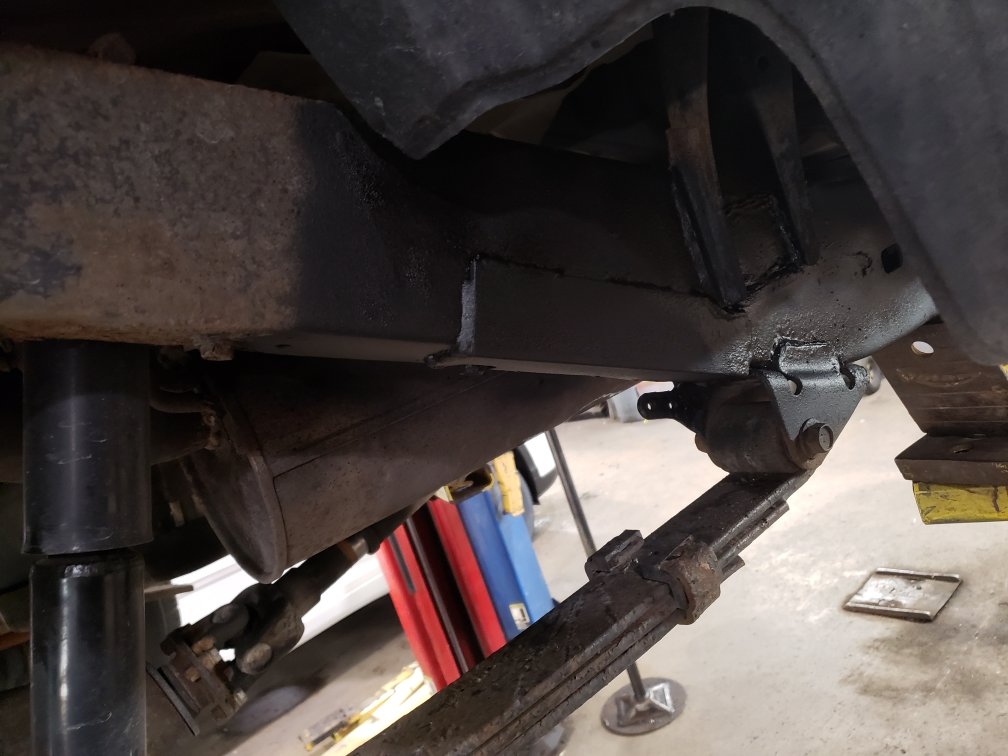

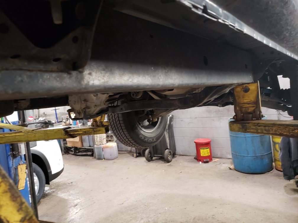

    Curious what you guys think of this rust. It's going to be a farm truck for my dad and I. Was hoping to get a lot of years out of it but I'm a bit weary.Attach21346_20190103_162034.jpg Attach21347_20190103_162054.jpg Attach21348_20190103_162121.jpg Attach21349_20190103_162133.jpg

    I'd skip it. Looks like the frame has been repaired due to rust already. It's only going to get worse

    I wouldn't necessarily say that using angle iron to path a frame is an especially legit way to patch a frame...
    You can see it doesn't even match the shape of the frame at the rear. Not the best patch job, but not the worst, either...
    I guess it depends on what you intend to use it for. A trail rig? I wouldn't worry about it since you're likely to hack it up and weld on it anyway. A daily driver? I might hesitate.

    There are VERY few Tacomas that even have a chance of qualifying for the frame repair (it's actually an extended warranty, not a recall). There are VERY specific things that had to have happened for even 2004s to qualify, and they're only good for 15 years past manufacture date, which there are only a few 2004s left that would qualify for that. i think the fact that the frame was repaired, and obviously repaired poorly (used angle iron!) would void any sort of replacement anyway.
