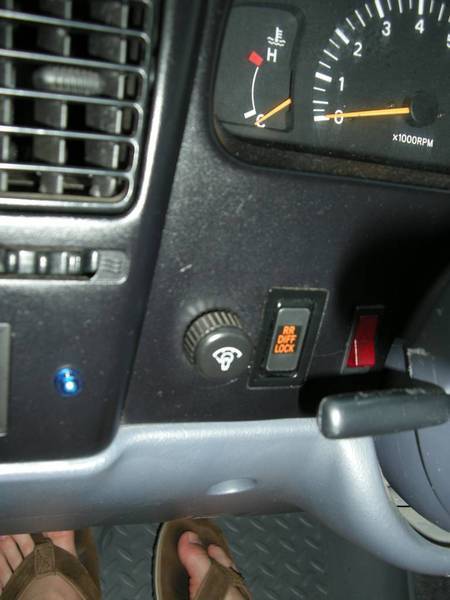

    Hi new to the forum and tacomas but far from new to yotas. I'v owned a rav, 3 supras (still have one) and an alltrac. Im looking at a 98 xtra cab 4x4 and wanted some input. Truck show no rust underneath and sounds like it has mostly been garaged. What questions should I specifally ask about and what should I look at. It has 140k on it, what maintinence should it have had by now? and what can I expect to need to do? Also the truck has no trd decalls but has a button to the left of the steering wheel on the dash. I think I read it will say rr lock or something if it has the e-locker but if I remember right it said something like clutch lock or something with a little light. Is this the locker? Has the original clutch but wasnt soft and felt great as did the tranny which shifted super smooth. I appreciate the help and hi everyone.

    Thanks, so I read up a little further and sounds like it is intact not the trd and the button I saw what the clutch disengage for starting. So what kind of rear end do the regular 4x4s have is it an open diff or just a regular limited slip without the electronic stuff. If its open can it be changed? The sup is my summer car so I mostly need the taco for hauling and snow, which we get a fair bit of here.

    It seems to be an open diff. You can add a locker in the rear if you wish!

    So no go on a locker, I dont plan on off roading the truck really but It will see its share of rough dirt roads and trails and definably tough snow. Looks like its quite a bit of work to change over to the e-locker what options are there for limited slip, I want something street friendly because this it where the truck will spend a lot of time. To me 4wd without at leas lsd is well not real 4wd I guess or am I placing too much importance on this for what I plan to do with the truck
