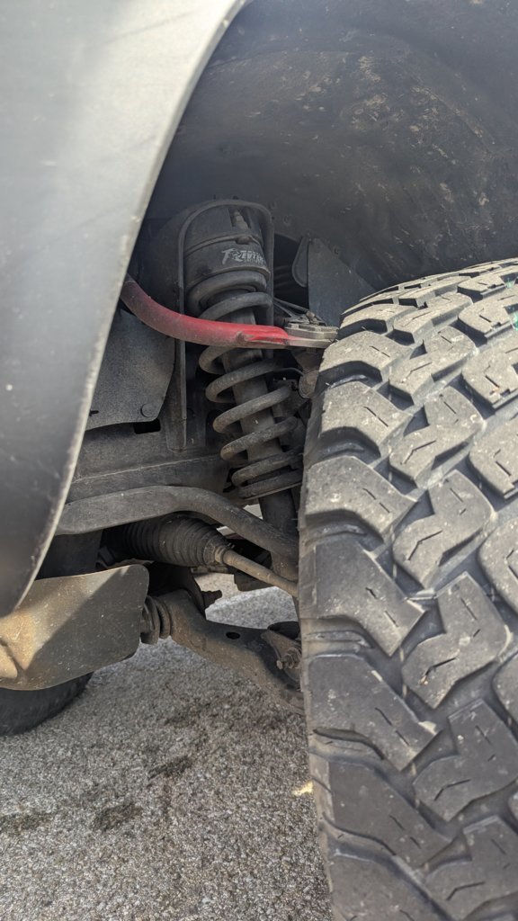

    Well since you don't believe me..
    YF_Ryan[QUOTED] likes this.

    There is a pic in this thread now...

    Double blocks! That’s wild.
    YF_Ryan likes this.

    Honestly surprised that even drives somewhat ok lol, no hate but im glad nothing has failed catastrophically. Could we see a pic of the whole truck? When you jack it up by the frame do the wheels droop down at all??

    I kinda wanted to ask that same question. I can't imagine the front suspension would move when it was jacked up.

    it drops just a little maybe about an inch in the front and a little bit more in the rear. I have had to replace the Carrier Bearing twice so far... I don't care to take any more pictures of a setup that i am not proud of....
