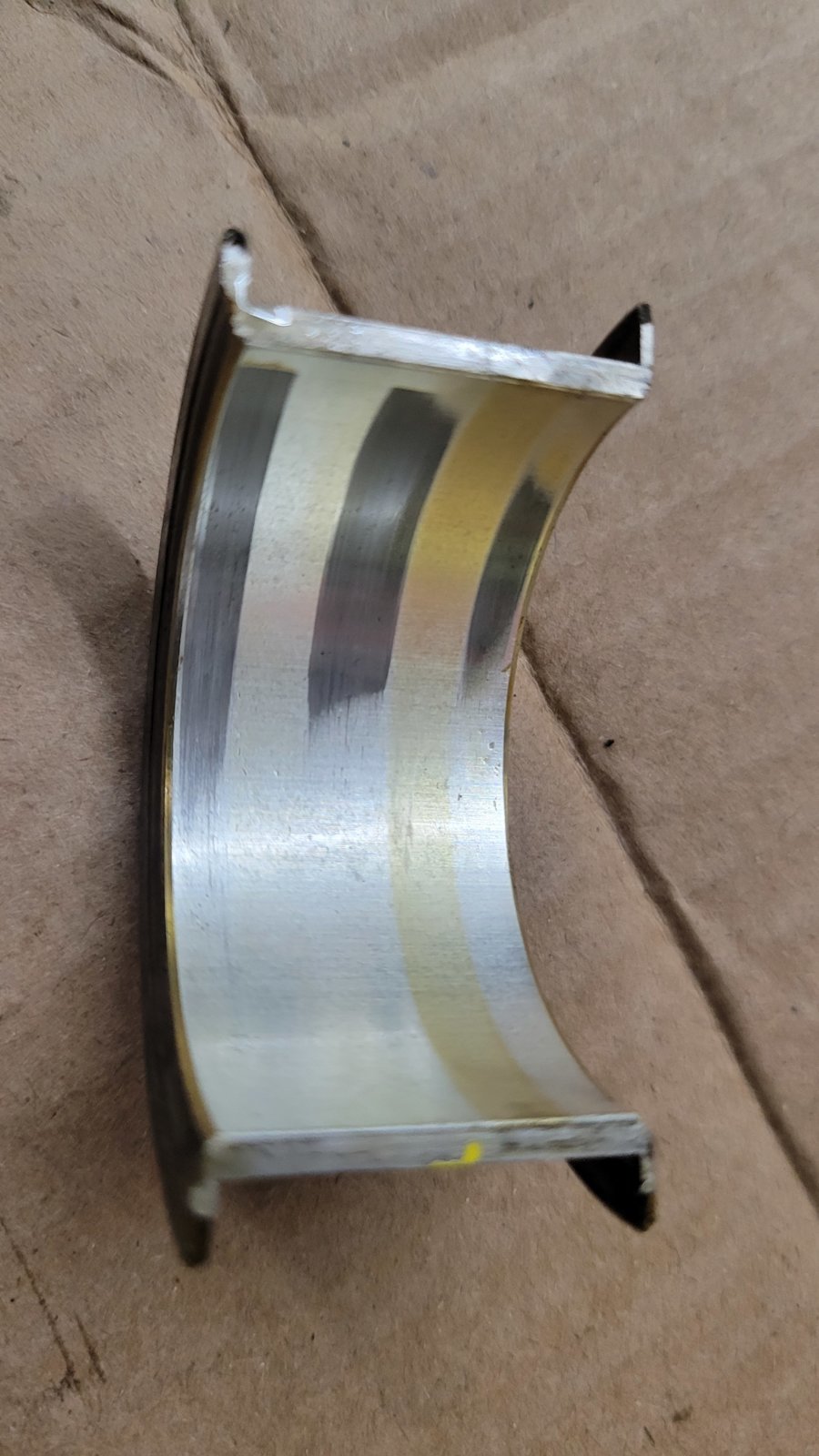

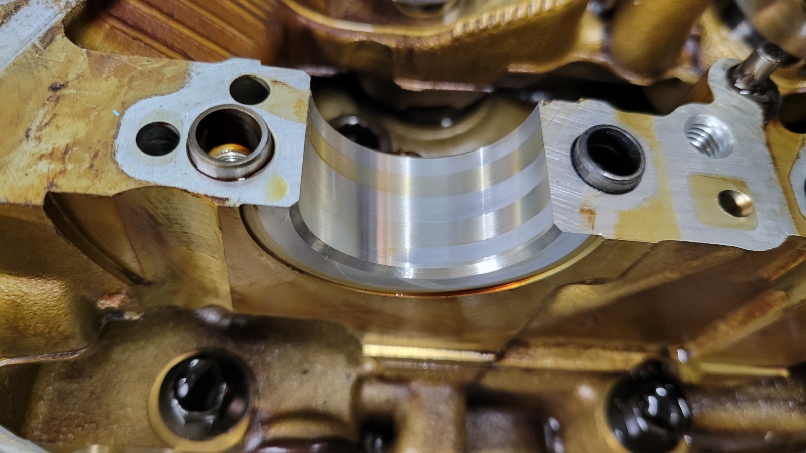

    Got the heads off, does the wear on these cam bearings look normal for a 1gr-fe? Coming from zero personal knowledge. You can barely feel a difference with your fingernail.

    I would say so but I’m not sure if I can tell from a picture with my limited experience.

    Pop that thing back in, no worries with that. How many miles on that motor?

    Yes, that is what I call stage one levels of wear on the cam bearings. Replace them now while you have it apart.
