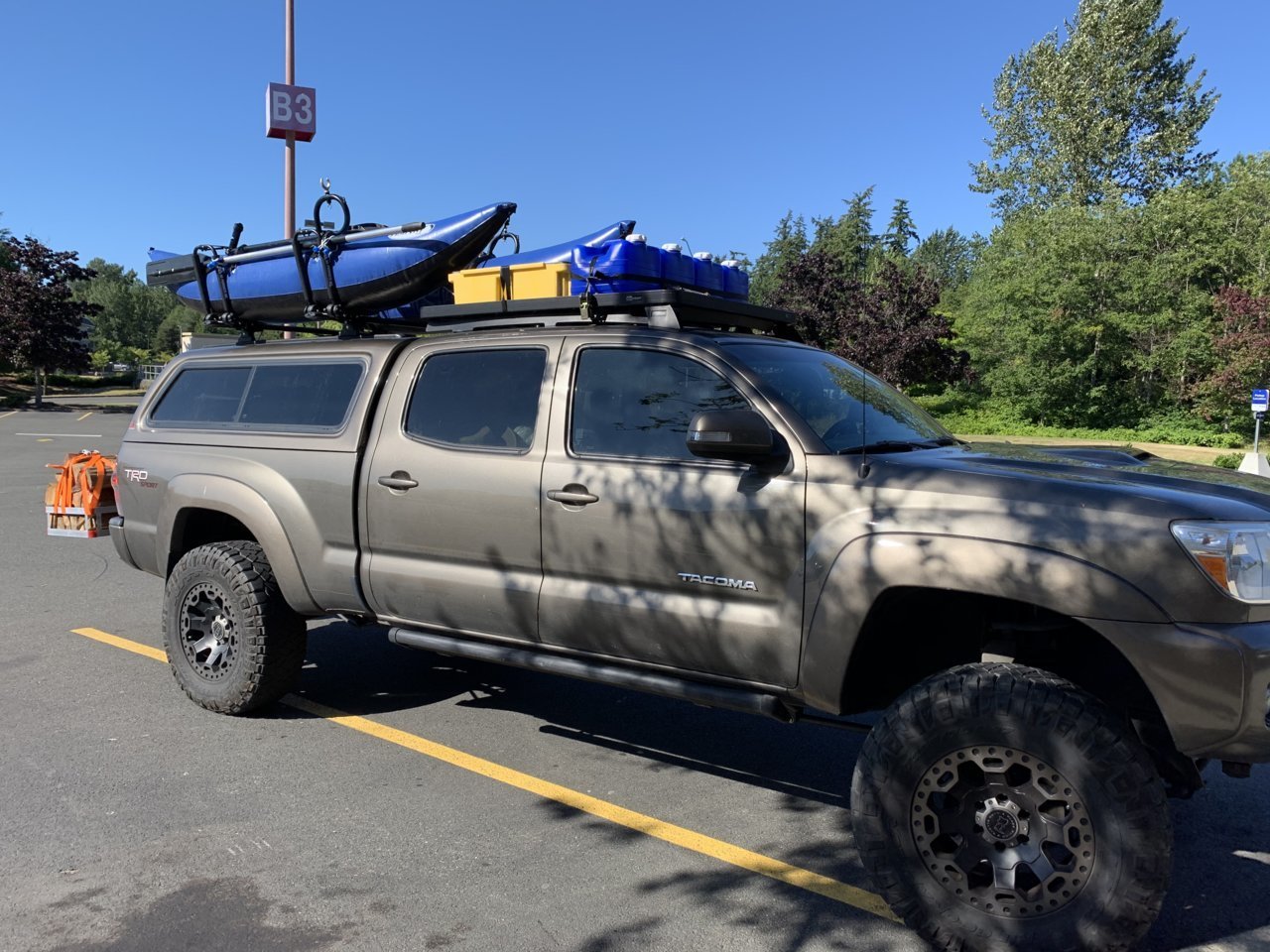

    I built my own out of 4” abs. I was going to go 6” but decided to fit them under my roof rack. So I built two, one for each side. Each unit holds about 4.5 gals. They are held in place with 4 (2front,2back)24” industrial strength zip ties crisscrossed. No rub on cap. Pressurize them with a CAT brand battery pack/jump starter/air station. They work great and built both for a little over $150.E6E16E39-8F2C-4439-9001-6BEEC617942A.jpg

    Thanks. They have worked great. No major issues. I think I might eventually add a schrader valve to the other end of the unit for a couple of reasons. 1. Easier access to my inflator 2. When I’m on an incline I lose a little pressure.

    So each tank gives 3-4 showers (1+gallons) each using a limited flow sprayer and the wet down, soap up, and rinse off method. If just me hunting or fishing I tend to use some of the water (1 gallon) to wash down the boat and or boots/waders and clean hands, or fish. Nice thing with these is that I can pull water out of a lake, creek, or river in my collapsible bucket and fill them up quickly while filtering through some filter medium. I carry 16 gallons (4x4gallons) of potable water in addition to the 9 in the pressure tanks. So 25 gallons total, 16 gallons drinkable. Here is a picture of how I carry the other 16. Tanks not pictured because I built them while out on this trip.
