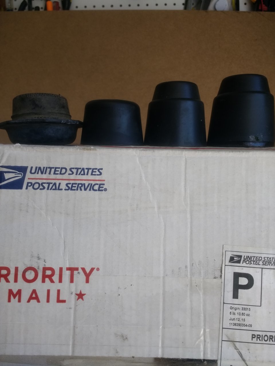

    Here is a write up on theBump stops made by Curtisaka @Plastics Guy .
    Here is a side by side picture of the stock rock hard bump stop of a 2nd Jen Tacoma followed by the first then the second and finally the third prototype .[​IMG]
    As you can see the first was too short the second was better but the compression rate of the rubber was to fast or soft( I don't know the proper term but Curtis knows his rubber) . The third prototype was the right blend of rubber durometer and size.

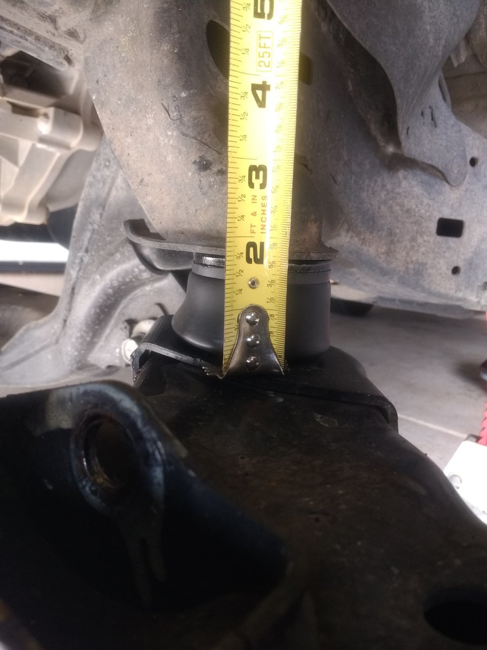

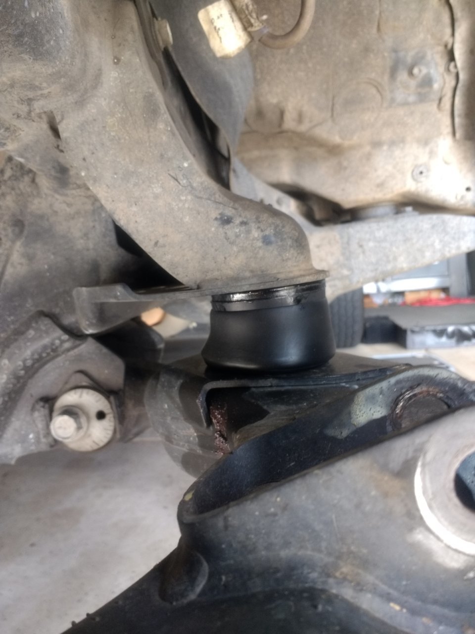

    Below is a picture of the second prototype Under full load and the shock removed. As you can see the bump stop compresses all the way down to one inch but was too distorted for Curtis is liking.
    [​IMG][​IMG]
    As soon as I sent these pics to Curtis he called me back and said I am making another set that will be firmer that that set . We spoke for a while and during that discussion is when I realized the knowledge that he has about rubber compounds and the passion that he has to bring a good quality product to the Toyota community .

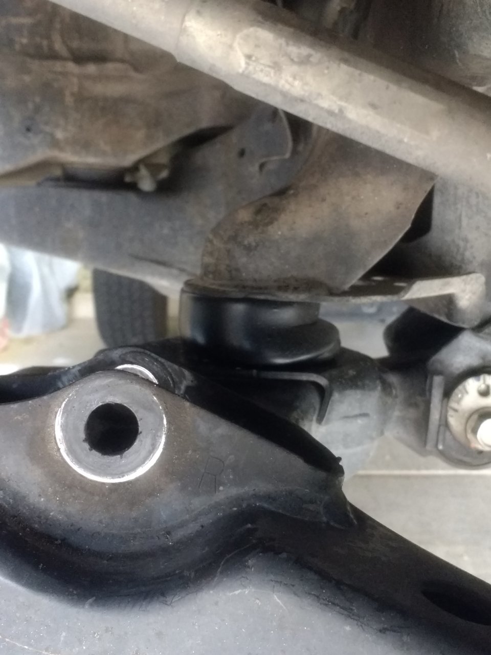

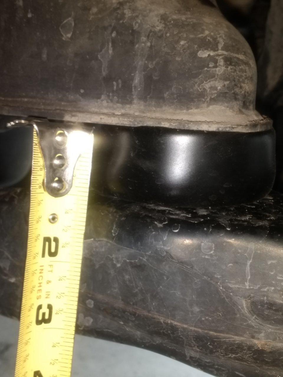

    Below is a picture of the 3rd prototype. It compresses down to 2 inches full load shock removed. At full load it keeps a perfect shape.[​IMG][​IMG]

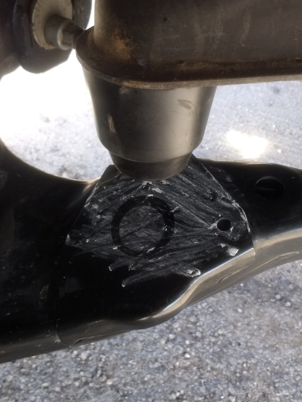

    I did a little testing on these and could not feel the bump stops hitting the lca. That is until I got out and checked . I had put chalk on my lca platform to verify contact and they did hit but I felt nothing on the cab . The test consisted of a 40 to 60 mph through a G-out . Well to my surprise there was some compression and then some uncompression. I was not planning on it but a little air time was achieved. Below is a pic of the contact made by the bump stops and a video of thetest run. [​IMG]
