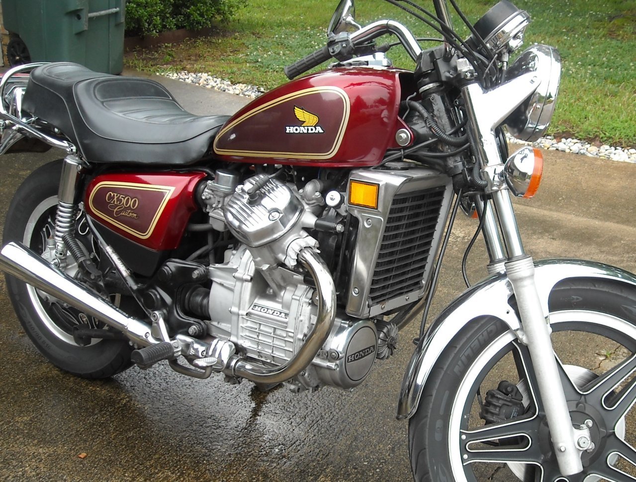

    FWIW, when I restored my bike, see avatar.
    I polished the valve covers, radiator side cover and the clutch cover (directly behind front wheel). These parts were clear coated with a 2K Urethane automotive grade product. The work was completed in July 2011.
    Your front fork won't see much "debris", mostly bug impacts and an occasional thrown road stone.RHSidePostPaint (2).jpg
