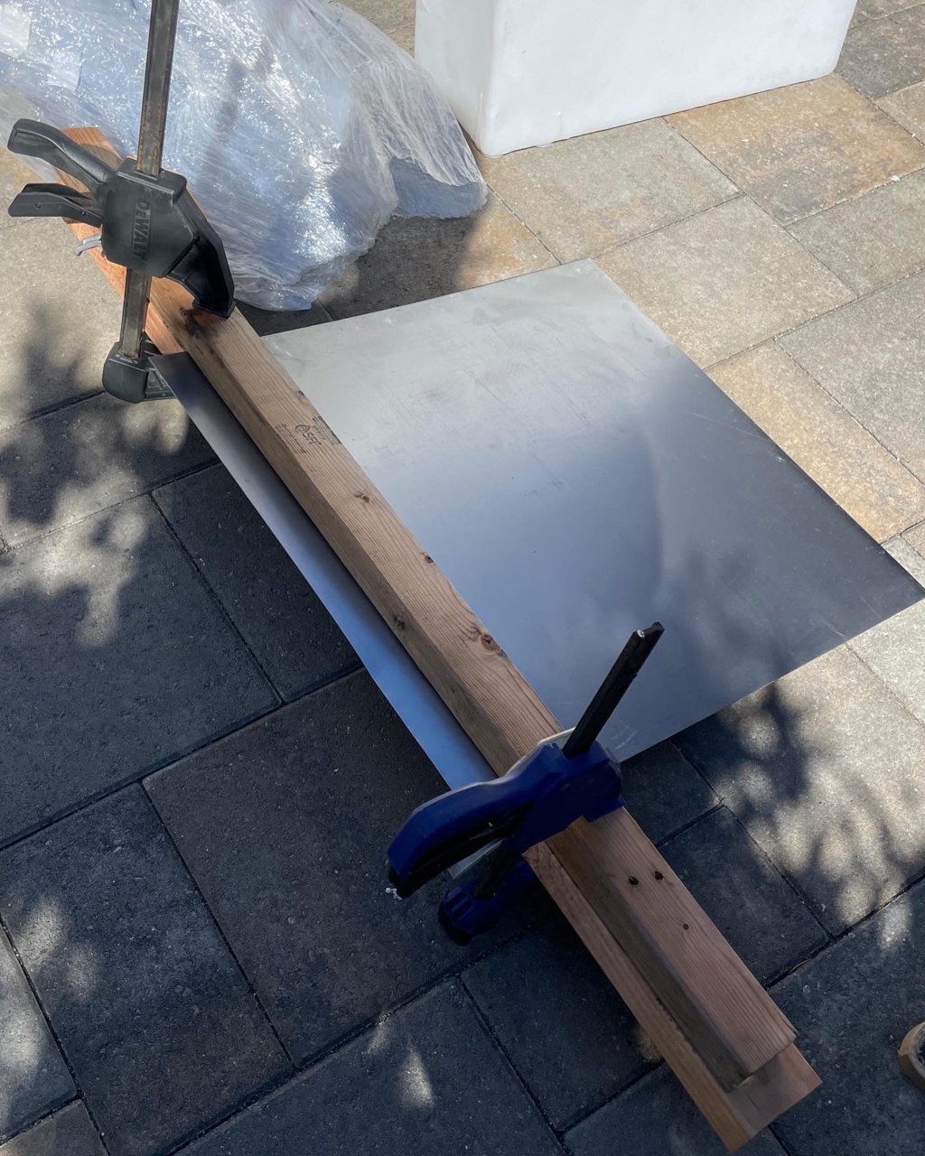

    You could probably just order a sheet of steel in the dimensions you need. Just a square right? Drill holes and paint it, done. You could do it.

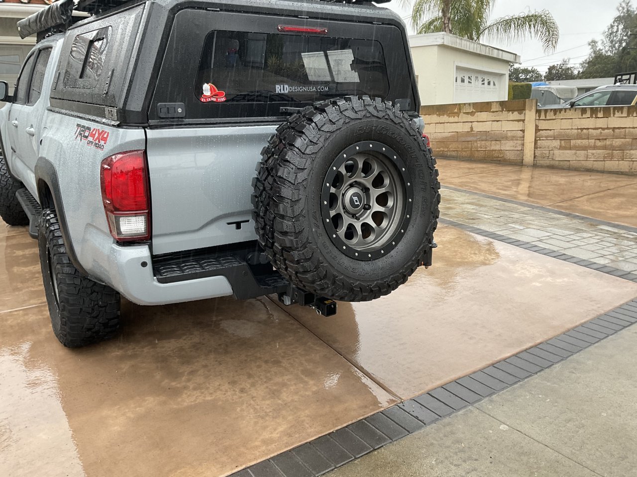

    nope but this will….

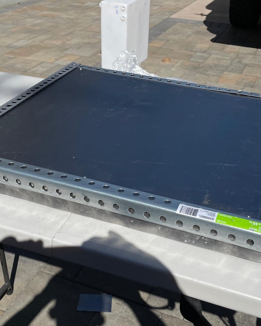

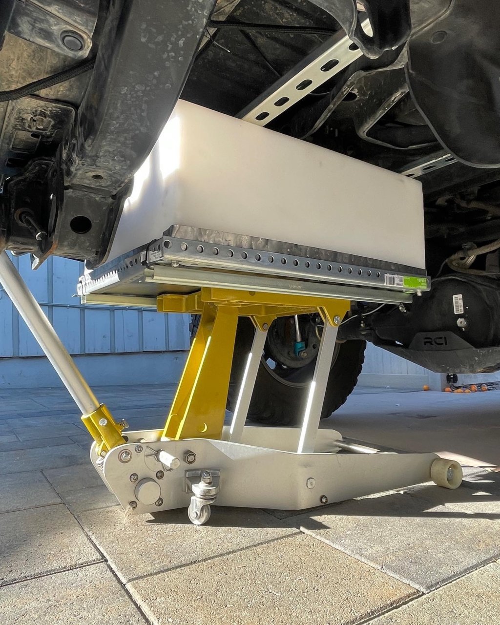

    So thanks to YouTube and everyone’s motivation on Tacomaworld, I ended up fabricating my own skid plate box and mount. My buddy did the hole cutting and got this project completed , mounted, and installed.

    Looks good, showers for everyone! Read up on how to sanitize a drinking water tank and lines- most RV websites show how. Also important- have a good drain in it, you don’t want standing water.

    No. Fresh tank is consumption which is what this case is. Grey/black are used in trailers. Grey is sink & usually shower (though some do divert shower to black instead) and black is toilet. For camping, a 5gal bucket makes a good grey tank that you can go dump away from camping spots.
    @imovelives, you may end up deciding that the spare tire rack would allow the tank to be higher up if it is removed. I don't know about you, but I know I have hit my hitch on the ground before. If that occurs, you have enough of the back side of the tank hanging below the hitch that you may cause a good bit of damage.

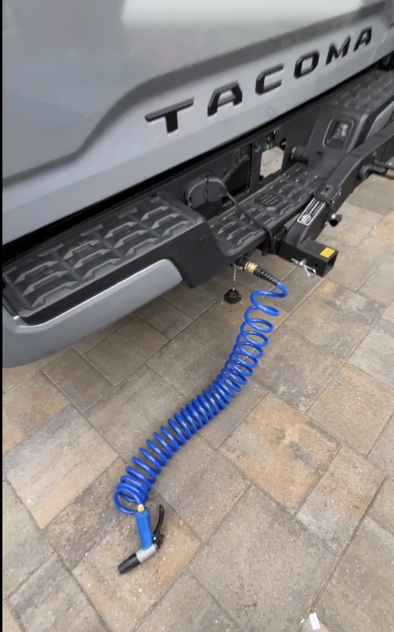

    Happy wife happy life. My wife likes to take showers when we are out in the middle of nowhere. It will hold 14 gallons. Last time we went out, I took 3 gallons plus another 4 and ran out on day 3.

    It’s a fresh water tank. I painted it black because I didn’t like the white to stand out. I used raptor liner.
