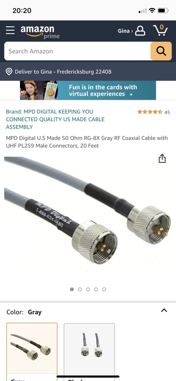

    Just out of curiosity where you able to get a WRS measurement and would be willing to show a picture of your set up? My Wouxon KG 1000 arrived and now I’m looking for the best location (hood or rear tail light) for reception. I’m looking at the 33” for daily driving and the ghost for off road.. any recommendations or suggestions? Also what grade of coax did you go with? I was thinking of

    I am using some generic RJ58 that came as part of a 90* 3/8" NMO mount. Coax cable is nothing special or particularly difficult to manufacture. I wouldn't spend big $ on super high grade stuff for 50watt radio applications. The quality of the termination and terminal hardware makes a bigger difference. I am sure there are differences between the really nice $$$ RJ58 and the basic $ RJ58, but I doubt it makes any measurable difference in this application. Heck, even coiling or wrapping the cable up doesn't make any difference in TX/RX performance for 50watt GMRS stuff. I do plan to cut the coax and re-terminate it when I have the dash apart this fall, but only to satisfy my OCD about clean routing and such.
