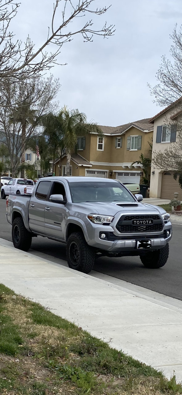

    So I have a 2019 Tacoma 4x4 sport and Im thinking of buying a lift kit that won’t make my tires look small compared to the lift. I have 275/70/17 ko2 all terrain with a 1inch spacer in the front. Are there any recommended lift kits (no spacers) that would lift my truck around 3 inches?
    I also looked into the bilstein 5100 and they lift around 2in. Would that even make it look more lifted compared to the 1inch spacer I have on it already?
    sorry if doing this wrong thanks in advance

    Man, that looks so good already as it sits.

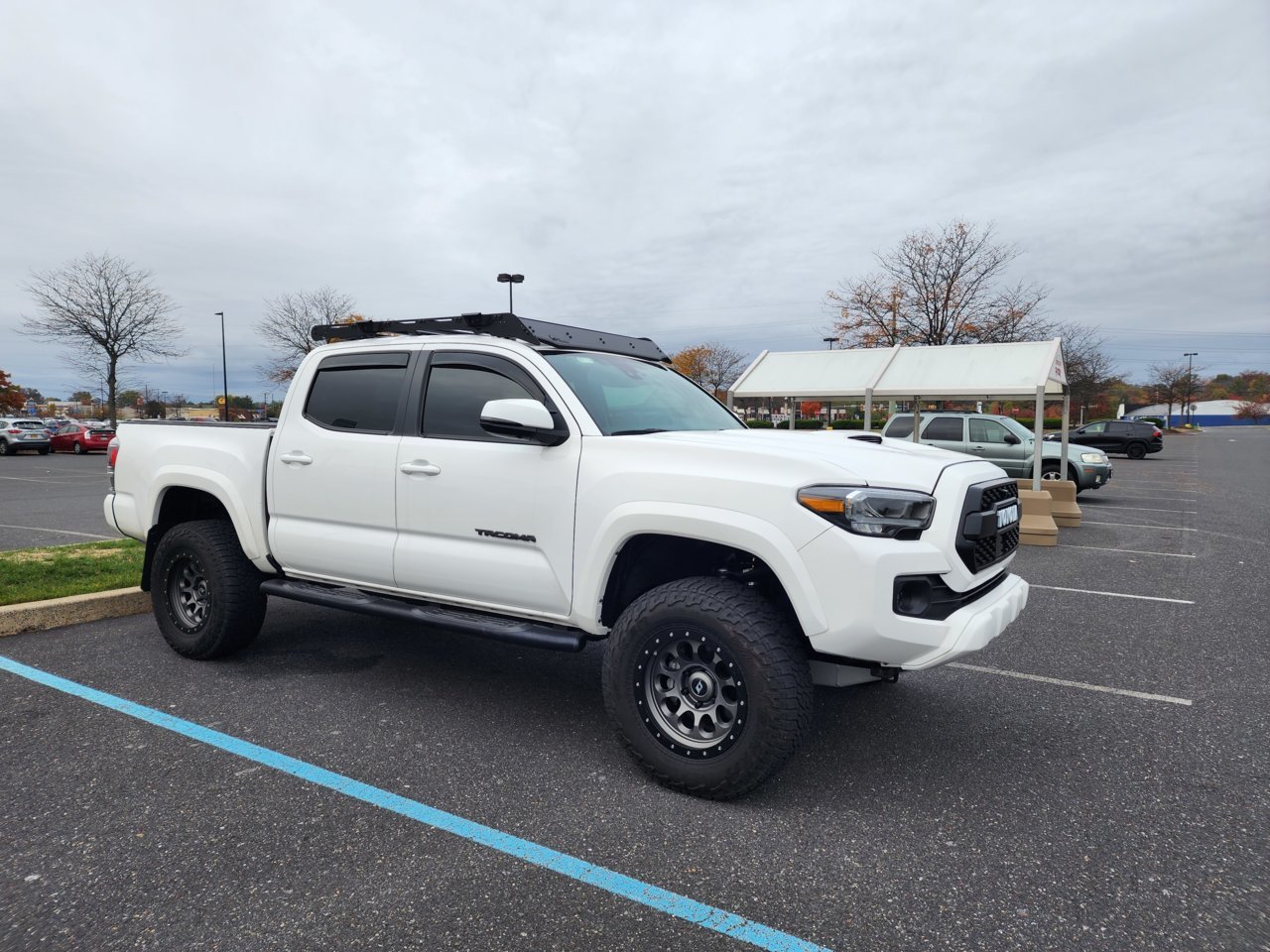

    I got 6112/5160 with headstrongs 1.5 aal with added half inch shim on 265/70/17. I had the tires from previous wheels and before lifting it. Lol

    304
    looks like your truck is leaning back. i would lower the front by a half inch or maybe 1 inch. otherwise looks good as it is
