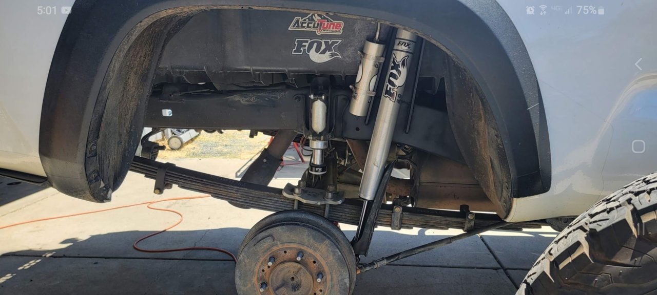

    All of them.
    Icon rtx, fox 14" 2.0 and Fox 2.0 air bumps. Screenshot_20220206-170153_Photos.jpg Screenshot_20220824-134952_Photos.jpg

    Strange. I gained about 1.5 inches of up travel going from wheelers superbumps to fox 2.0 bumps

    When your doing the fast stuff are you on the bumps all the time?
  17. Aug 24, 2022 at 11:11 AM
    #17
    Vegasstunts
    Vegasstunts Well-Known Member
    Dec 27, 2019
    #314287
    751
    16 TRD sport
    All of them.
    Kinda ya. You can hear them clacking back there but it's not super loud or anything. Just noticeable.
