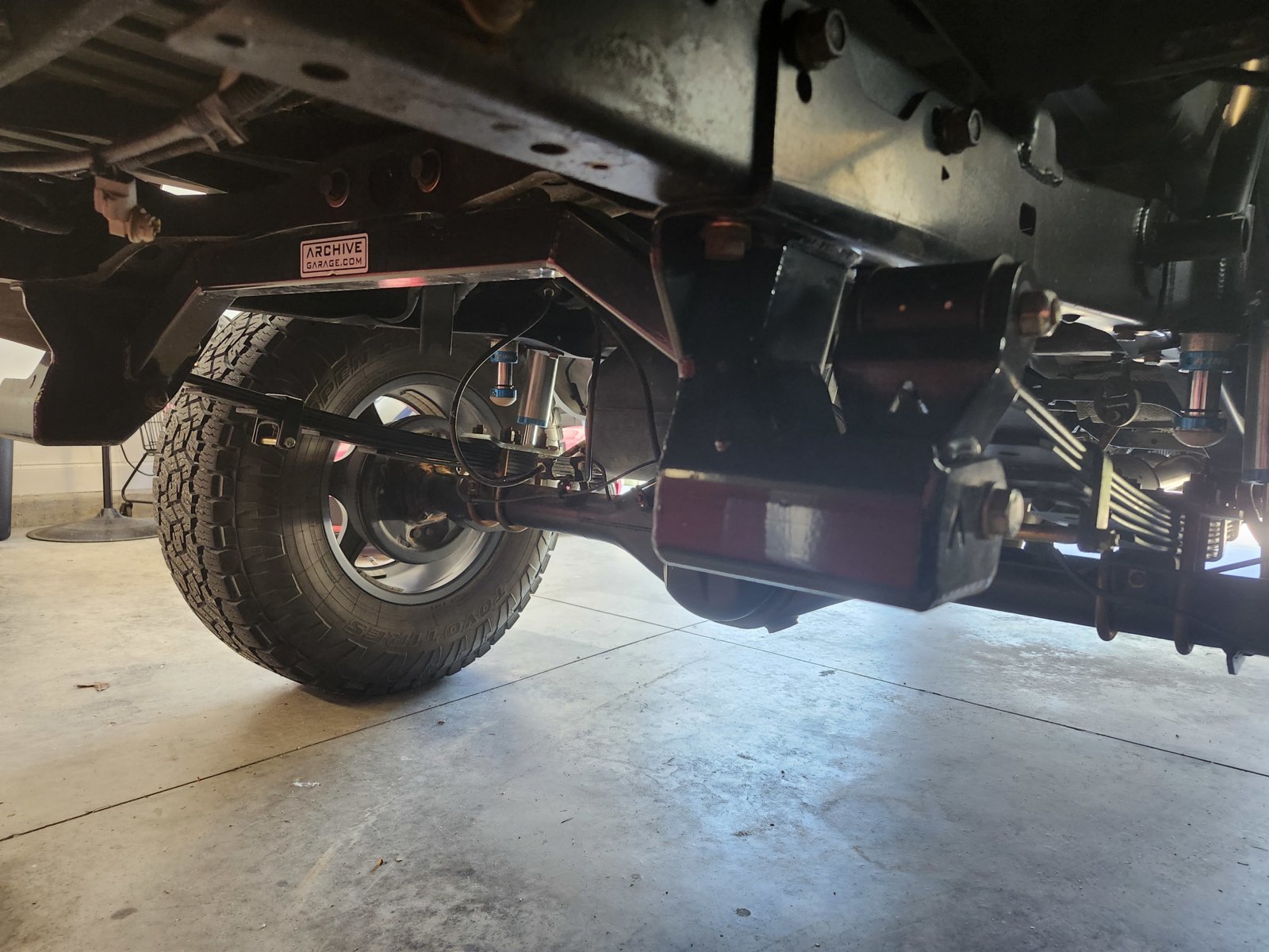

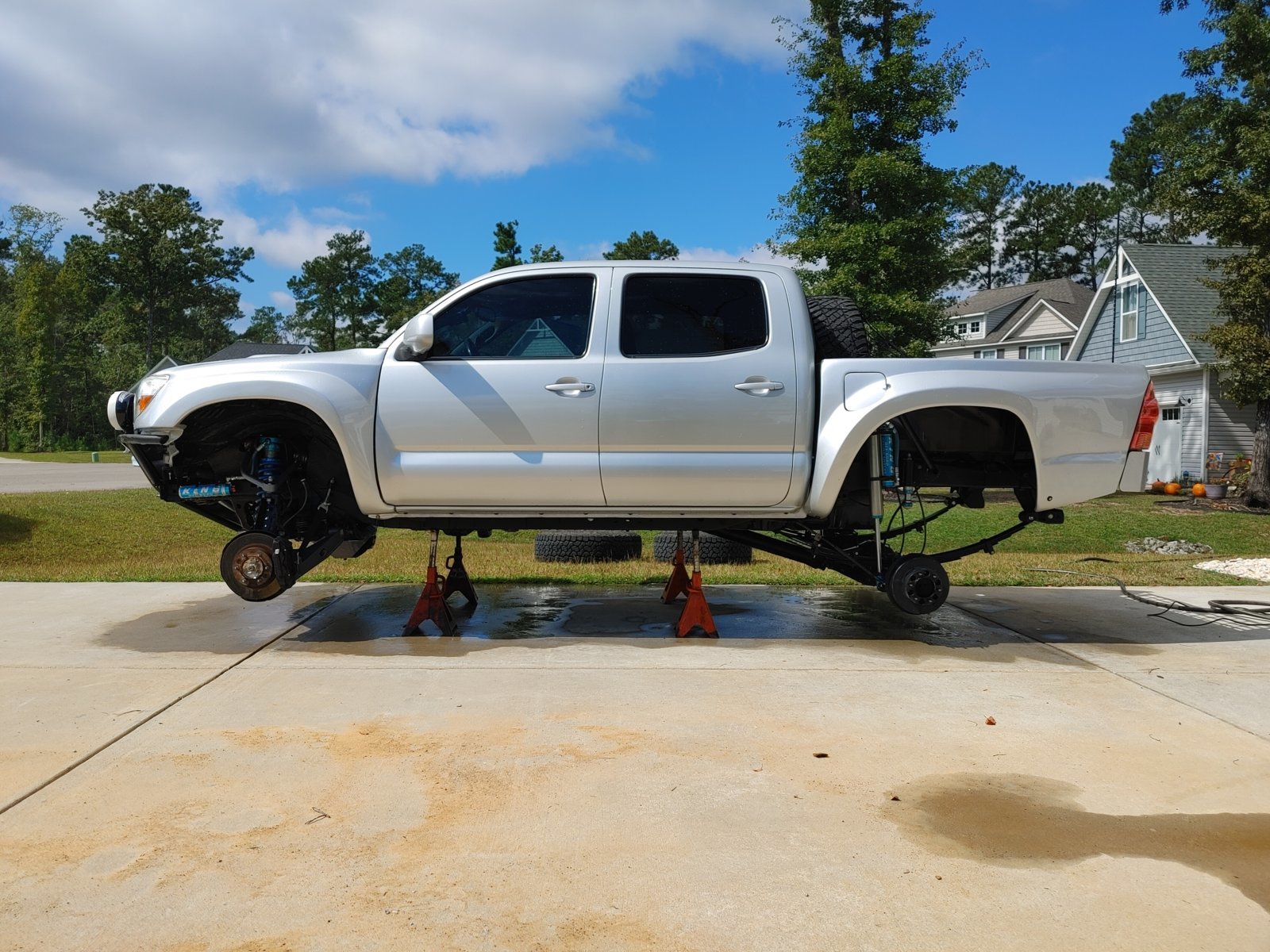

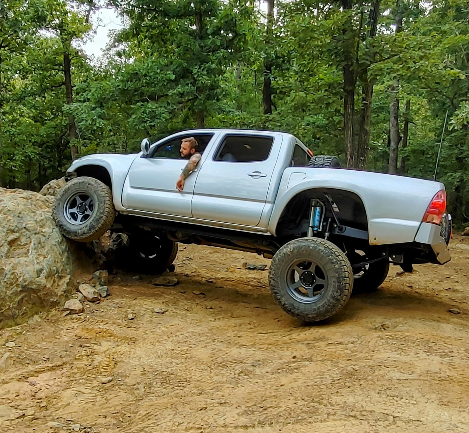

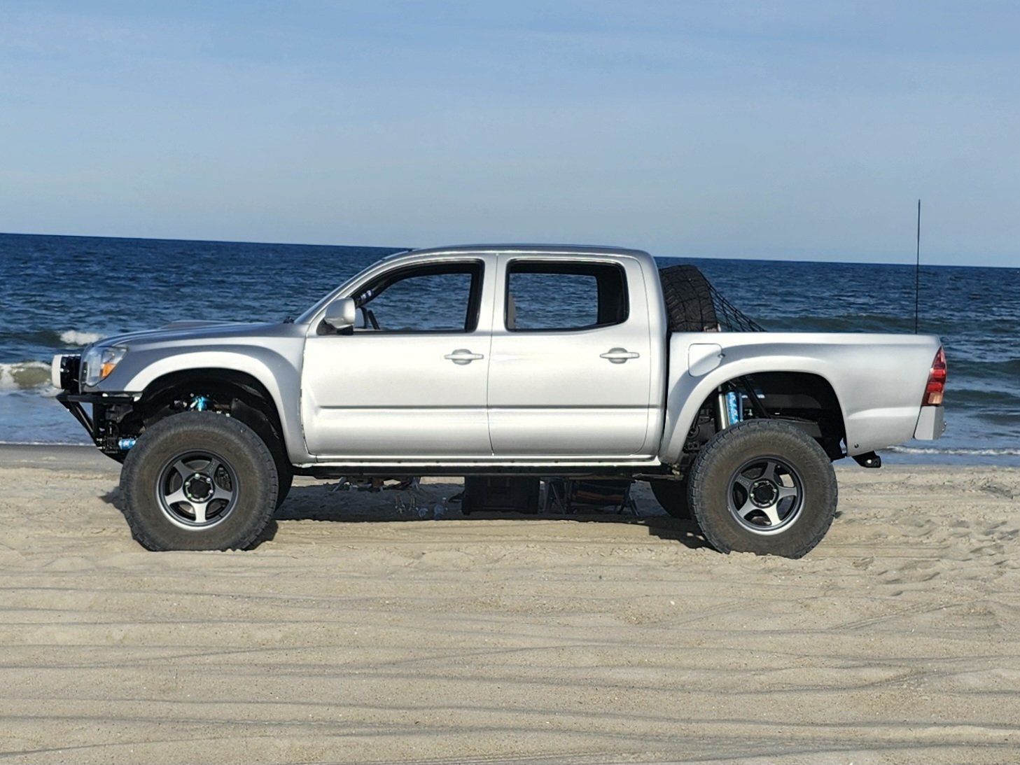

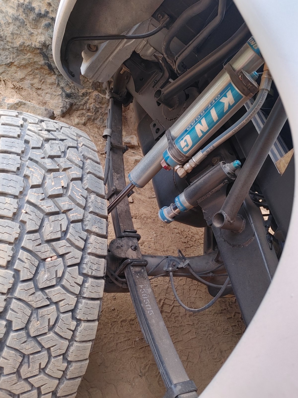

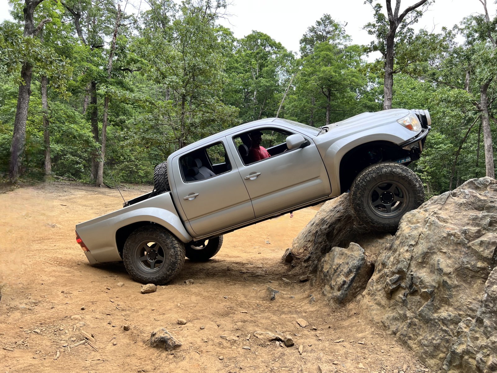

    Just a little update on my own thread from 2 years ago.
    Currently running Icon RXT option 1 with smallest leaf removed.
    Archive hangers and cross bar
    Archive 4.0 shackles
    King 14inch 2.5s with adjusters through the bed
    King 2.0 hydro bumps.
    I used the accutune archive kit shocks and made new hoses and fittings to be able to piggyback them and mount them inside of shock hoops.
    Killer setup and is very versatile. Can flex like crazy and still do higher speeds on the beach with the compression turned up. The bumps get maxed out alot when going fast but that's because I only have 5 inches of uptravel.
    Currently preparing for dmz SUA kit to complete the truck.
