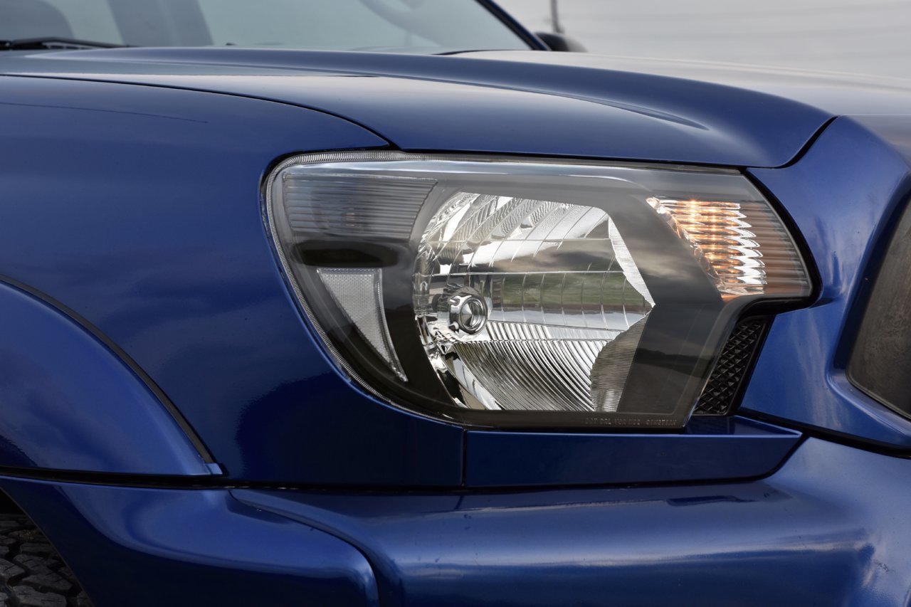

    This triple combo simply does not exist for 2nd Gen, there are no exceptions. No off the shelf aftermarket housing is bright especially those that look different than stock, they all are significant down grades. And among the worst is Spyder (the brand you linked) not only are they not bright at all and a significant downgrade from stock, they are known to leak and have lens clouding from UV breakdown. Probably one of the most complained about brands for low quality and poor performance. But people like the look.
    You can get smoked OEM chrome TRD assemblies that are darker than stock, but they still have the stock appearance. That or doing the BHLM (and risk leaks) are the best bets for 2nd Gen headlights if you want to remain legal and with good output. Both do not degrade performance unlike aftermarket housings.
    Otherwise you have custom retrofits, which are also not legal, but if done well and in an area that doesn't have inspections should avoid any legal trouble. Many retrofits are poor quality, to do it right you'd want to use OEM grade D2S components such as Lexus RX350 projectors and avoid aftermarket china products like H1 based retros as no credible lighting manufacture makes H1 (halogen based) HIDs.

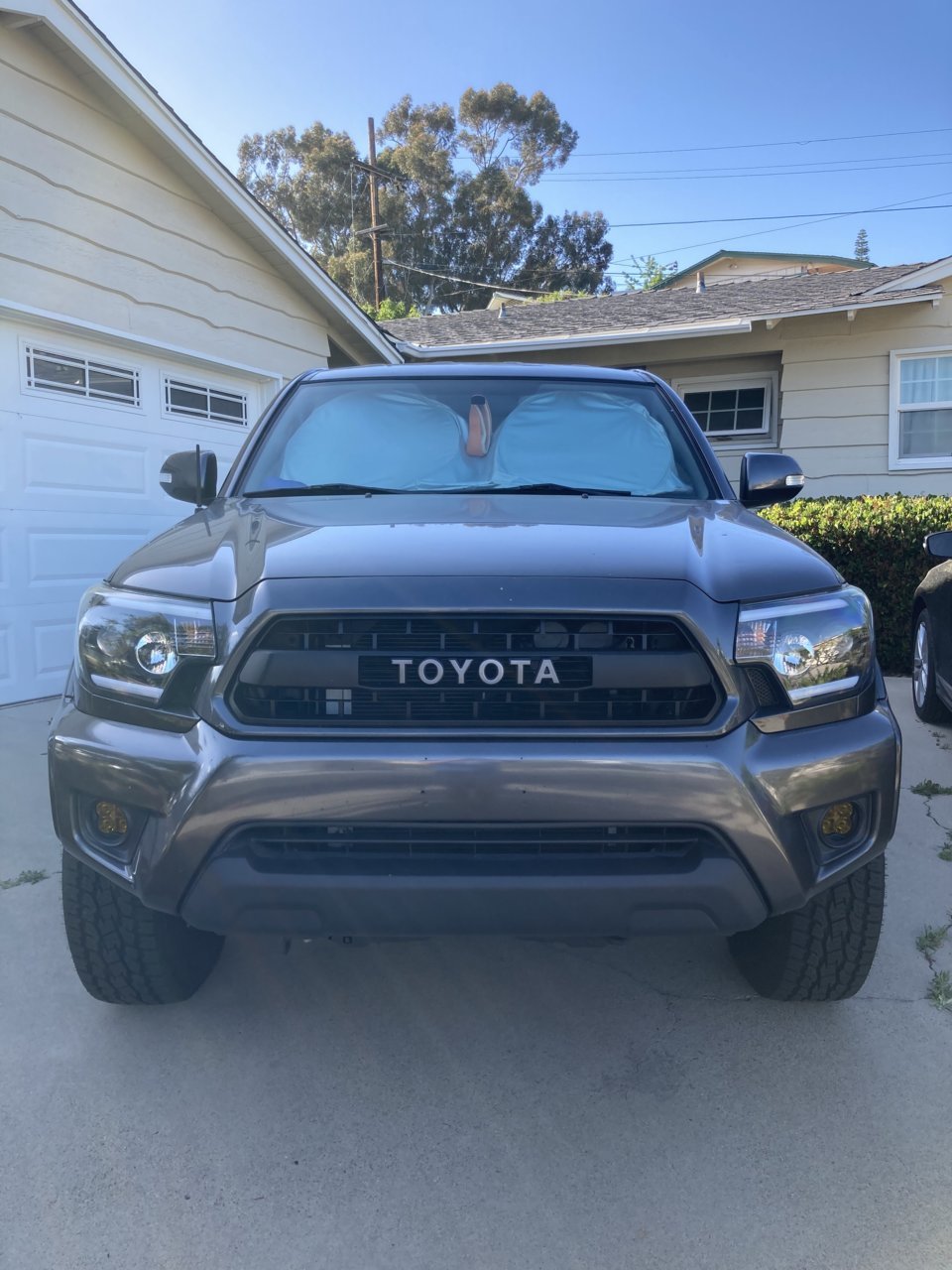

    Again, personal preference but I think the lines of these headlights fit better with front fascia of the 2nd gen. I think the other similar ones that have the white lines wrap around the outside of the headlight look better on 3rd gens. Our front fascia's are more boxy than the 3rd gen so the lines (to me) flow better. I know a lot of people on here run the other ones and they look good so no hate on them but here's a pic for reference of the ones I have:

    Nice looking lights gkomo! Glad to hear about the quality. Are they running h1s or h4s? Mind posting some night shots? Curious to see how bright they are and to see the cutoff.
    And if those dont work out I might just go for the bhlm.

    Ya i'll try to get a night shot tonight for you.
