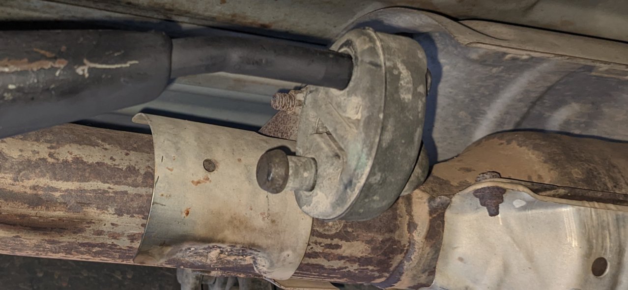

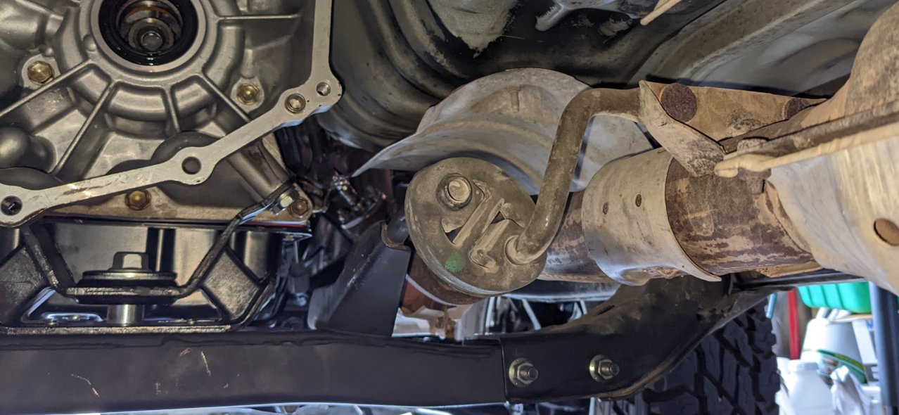

    I have been hung up with the exhaust system. Received a dented muffler & now am confused by the hanger on the rear cat.

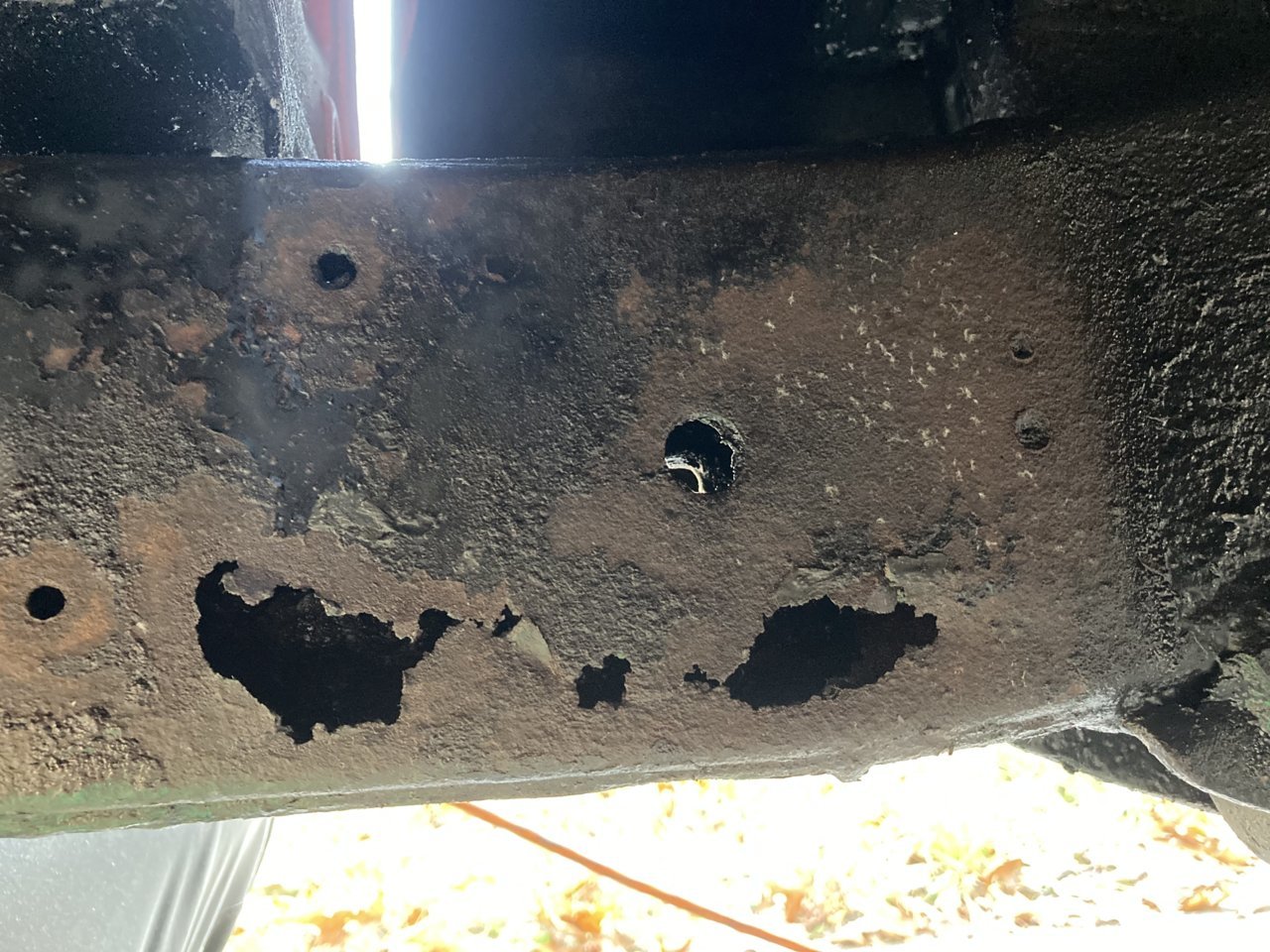

    Also concerned about a hole in my frame. It's at "the" spot in front of the leaf spring & now would be the time to get it since the exhaust is out. I have a welder. Only fired it up once. I'm a little intimidated by it & I haven't had time to practice.

    Pictures?
    For a novice welder, and probably not something you'd want to hear but I'd suggest acquiring the most comfortable welding position you can.
    In this case, it might be taking off the bed.
    I wouldn't recommend a novice to weld 3G, much less 4G (overhead).

    What is the issue with the hanger?

    Just started a thread. Thank you. Yes. Much different than mine. I am suspecting maybe something happened when they did the frame & they welded on arms.

    Plenty of room.
    Welding up front like that is called 3G.
    You can either buy, or cut yourself, flat plate that you will weld over that.
    You'd just need to hit that area (and surrounding) with a wire wheel and see what's metal and what's rust.
    Knock out the brittle stuff.
    Weld plate over it (extending beyond the rusted area) then paint and coat to your desire.

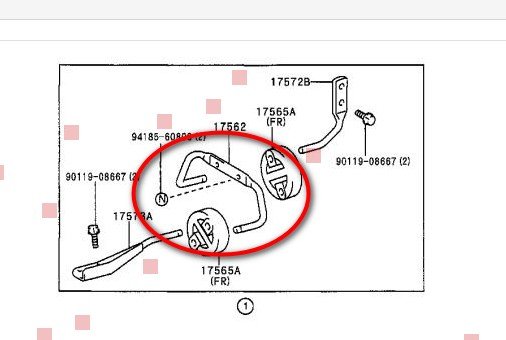

    So that would be this part, 17562? If so, do I need the 17572B?

    Over the years I have supported exhaust with Universal Hangers and clamps what ever does the job.
