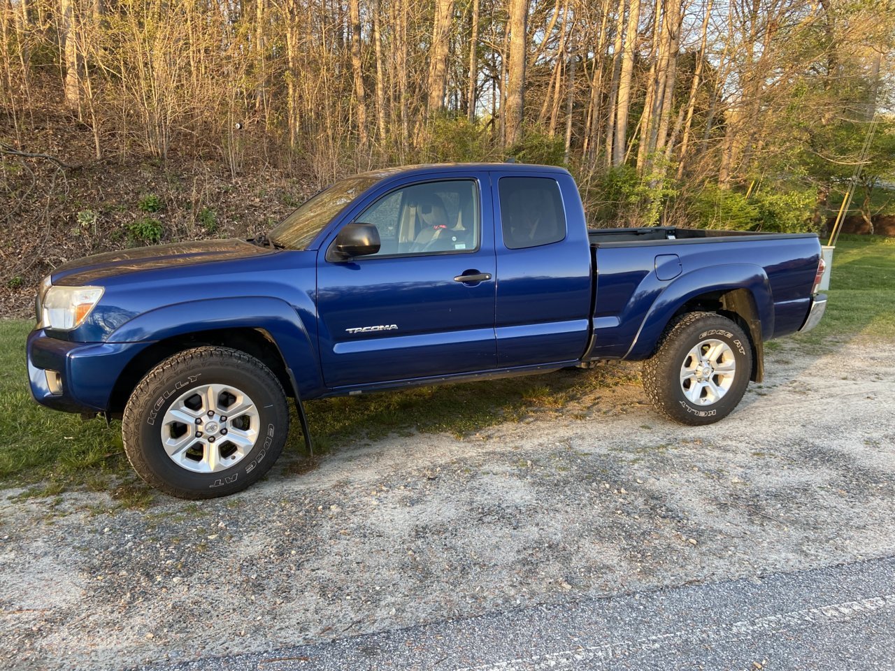

    2015 Blue Tacoma RWD
    17 inch wheels
    265/70/17. Bought it this way and it appears all the splash guards are still there.DAC983E1-6F34-433E-841E-E456D43B7785.jpg
