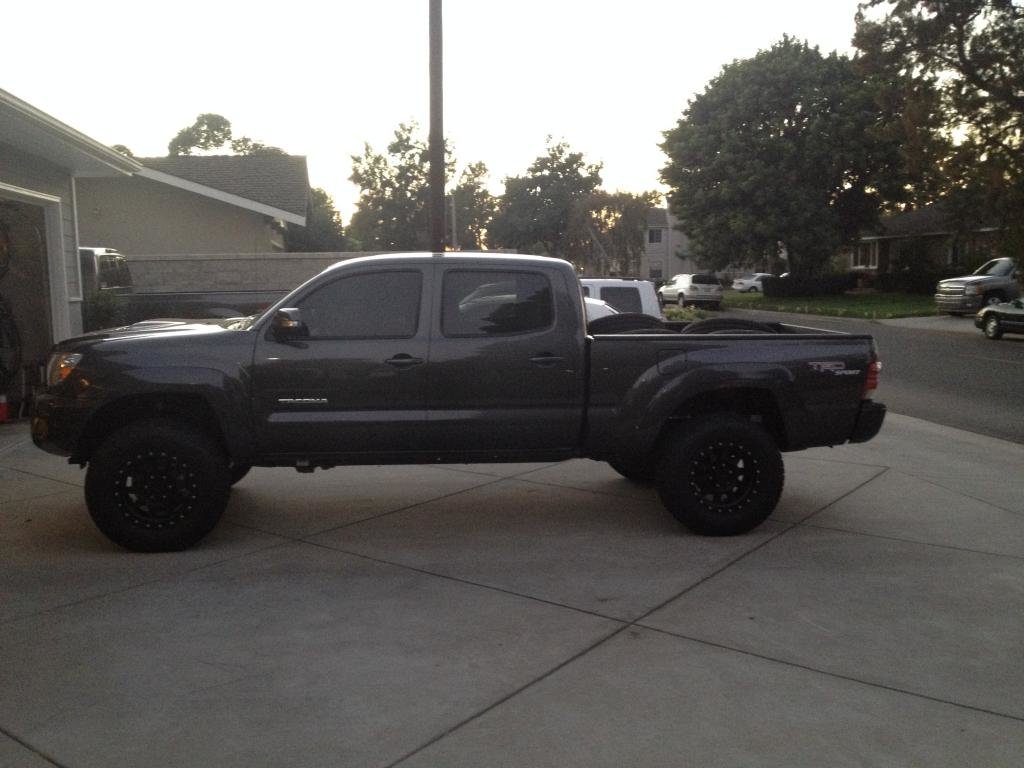

    You are going to get a host of opinions.
    I have a 4x4 DCLB. I installed Ext. Travel icon C/O (Set to 2.5 inches). Icon Tubular UCA's. Icon Rear Resi shocks. Dakar leaf spring with one overload leaf taken out. Nitto Grappler 285/70/17. Minor trimming of fender.
    Its my daily driver besides my work truck. Love the ride and IMO the best for the money. Also my opinion is to not go above 3inch lift, cause then you are talking about a lot more money. (again just my opinion, I still think they look good).
    This is with 400 pounds in the back. and my driveway isn't perfectly level.
