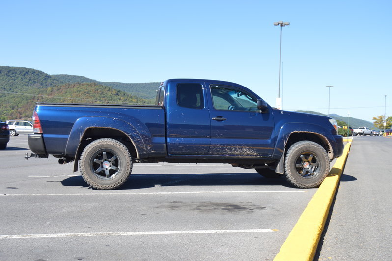

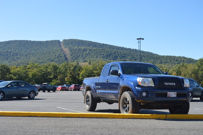

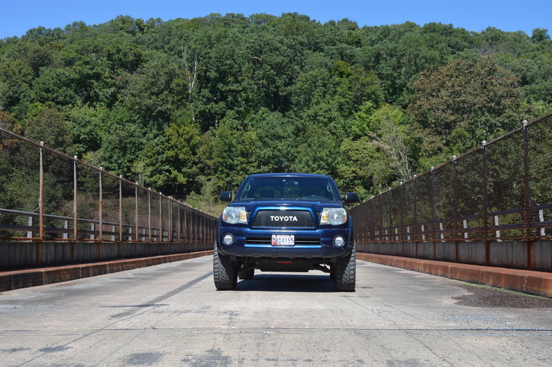

    If you want to run 32s your best bet is my setup:
    Poor Man's TRD Pro: TSB leafs, rear 5100s, front 5100s set on 0" with OME883x coils with Headstrong Offroad driver's side spacer, 1k SumoSprings, ubolts, and hardware. Cooper ST Maxx in LT265/70R17 E on 17x8 FN Konig Six Shooters in Gunmetal Grey
