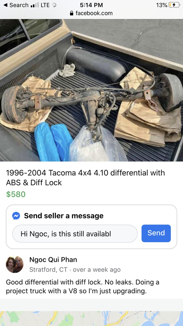

    You can get complete axle assembles for as low as $300 on Craigslist. Don’t waste your effort on fixing that
    What radio and axle do you have ?

    Depending on where you are in PA
