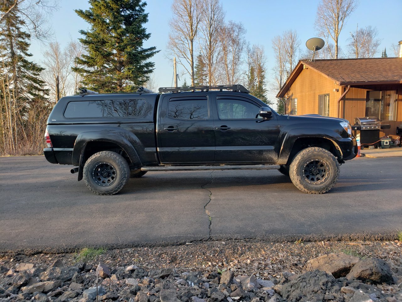

    Ome, 887 coils, Dakar pack and lr uca. Way smoother than stock, eats trails for breakfast.20190512_062659.jpg

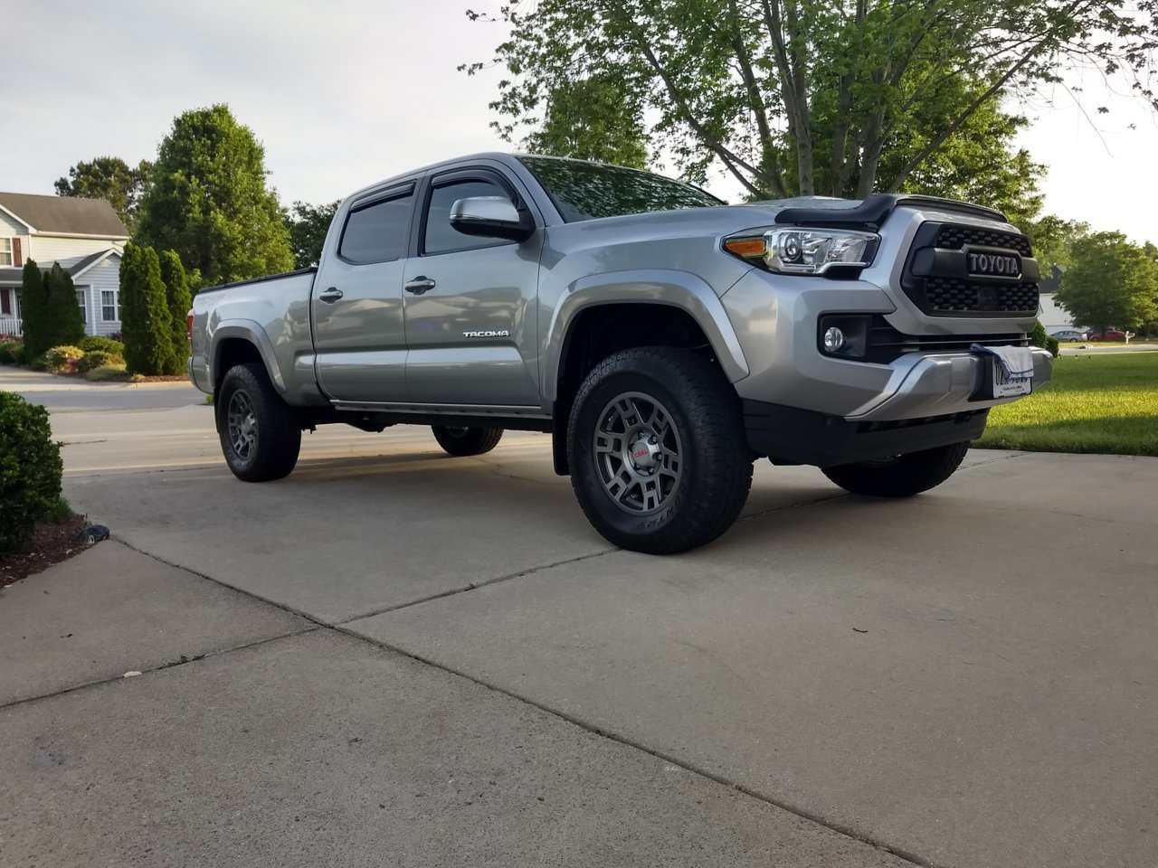

    Bilsteins 5100s on the top setting, 4runner Gray TRD Pro Sema wheels, 285/70/17 Toyo AT3s, Sumo Bump stops, TRD exhaust, ECGS Clamshell bushing, 1/4 shim for the lean and one inch rear block, OEM Pro grill and garnish OEM TRD Skid plate, TRD CAI, Demon Brackets, Rigid Industries Pro fog lights, OEM Trail Rails sidebars, Diode Dynamics LED SL1 high and low beam lights, OEM Roof racks, Clazzio leather heated seats, Remote Start, TRD Pro shift knob, tinted windows, Rockford Fosgate 4 channel amp for the headunit and sub and amp combo, OEM Puddle lights, OEM tailgate lock, OEM bed mat, LED interior lights, OEM blackout kit for letters, JLT catch can, upgraded 27F toyota True Start battery, Vleds led tail light kit with Pro tail lights, OEM Rave4 side mirrors with convex spotters,just to name a few mods.
    It's easy, I was in the same boat as you but I rarely go off road. Bilstein 5100s, set on 4th perch, 1/4 shim on driver's side for the lean, one inch block in the rear, front and rear diff drops. It sits almost level with a slight rake. It handles like my stock sport suspension and rides great, equally as well as my friend who has the same set up but with ome springs. By the way he is on the 2nd as they are sagging. For a nice ride, easy to align and a great stance which is higher than the Pro to give you some idea. I did wheels and tires too, mine looks like it came from Toyota set up this way. I think you would be hard pressed to find a better set up for the money, lifetime warranty on the Bilstein. Dollar for dollar its a great deal.IMG_20190502_071109566_HDR.jpg IMG_20181009_181855269_HDR.jpg

    What size tires?
    265/70/17 Toyo open country at2 SL tires on TRD pro Sema wheels.
