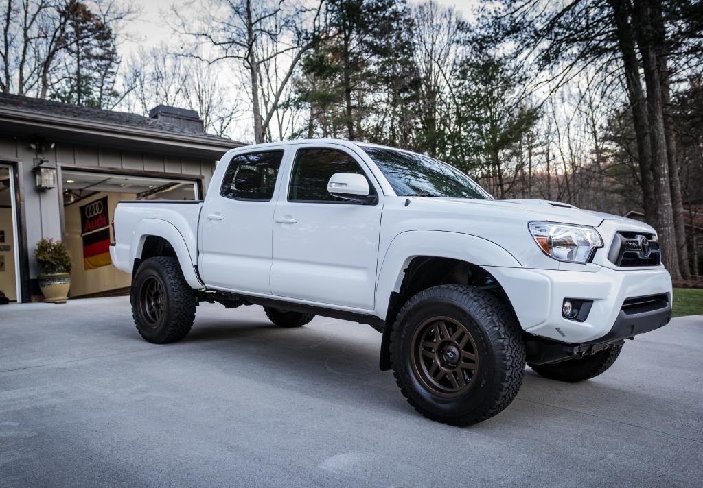

    I have 285/70-17 inch Cooper at3 tires on XD wheels right now. I’m looking for a little bit more offset maybe -38mm on some 33s?

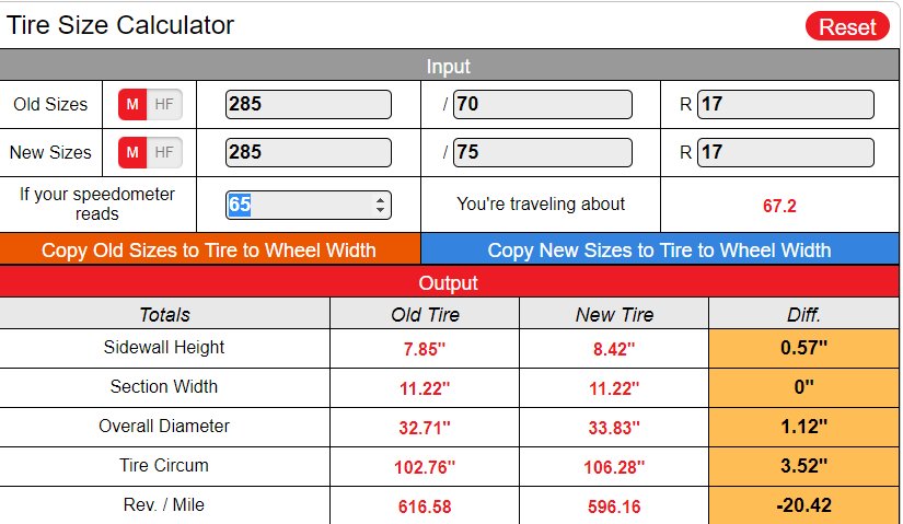

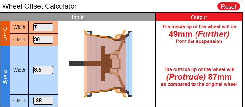

    @2011tackoo the 285/70R17 is considered a 33, but if you choose to go 285/75R17 that would put you above a 33.
    The factory offset is a positive 30 and most go to a zero offset. A -38 would poke considerably more.
    I hope this helps.

    I’m thinking about putting these on

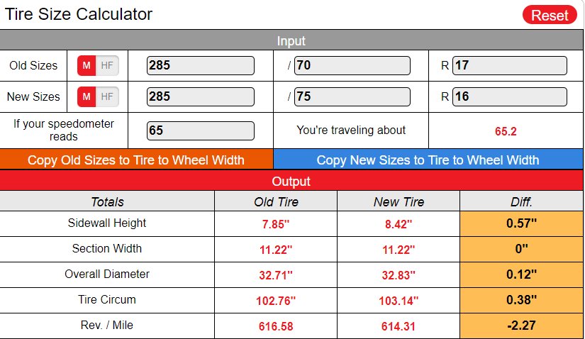

    If the wheels is 16x8 -25mm 6x139.7 what kind of tires would be best to run?

    @2011tackoo 285/75R-16 would get you a 33 inch tall tire.
