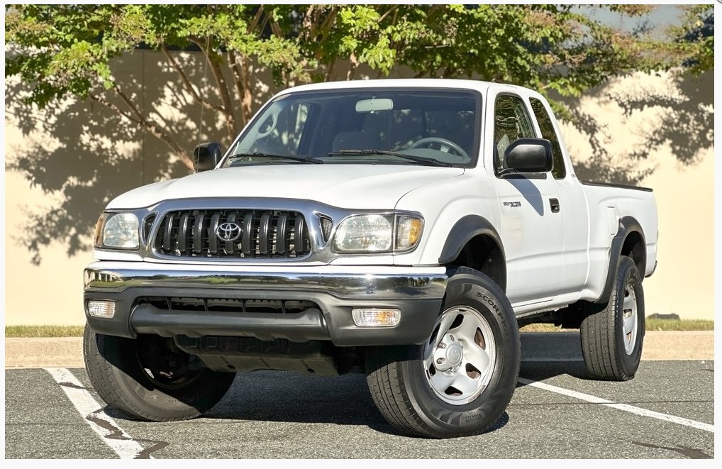

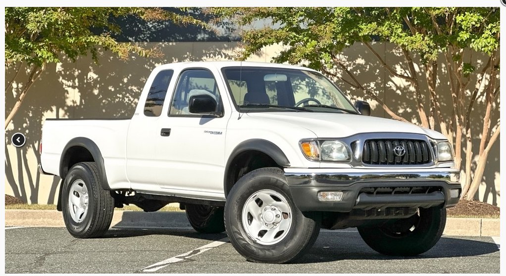

    The truck is listed as a 2001 Toyota Tacoma Deluxe 3.4L V6 4x4 5 Speed in Super White with 75,753 on the clock. I have attached a picture below for your reference.
    From an initial glance, it looks really clean right? I am out of state, outside of days drive away or I would just go and look at it instead. Well here are the things that I am curious about.

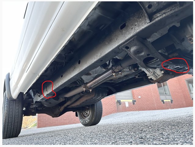

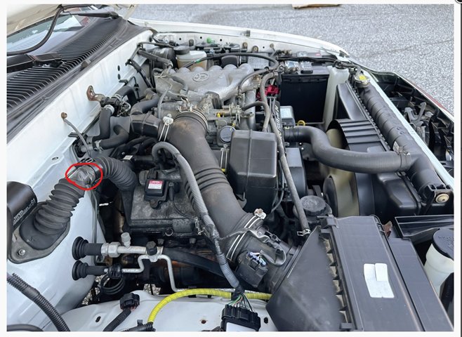

    First there looks to be some sort of tape on this connection here, not quite sure if this is normal?

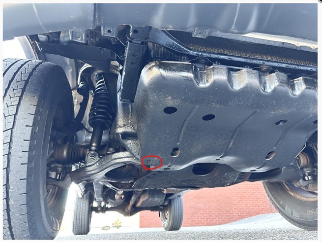

    Next, correct me if I am wrong but it looks like the majority of the underbody was covered in some sort of spray, not sure but hopefully not just black paint but in the corner of the skid plate it looks like there is a rust whole that was covered up, would you agree?
    The shocks also don't seem to stock, correct me if I am wrong?
    Here you can see what looks to be more rust or at least flaking on the frame cross bar and once again looks to be covered in some sort of black coating, hopefully not just black paint. Parallel to the frame rail, you are also able to see a good amount of overspray of whatever this coating is.

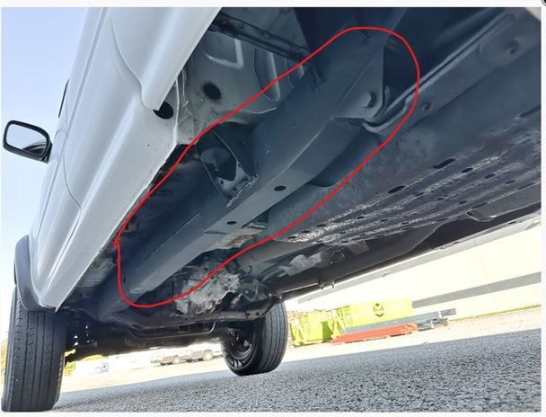

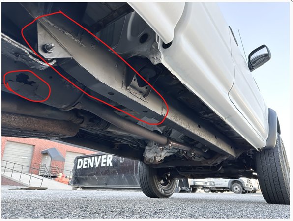

    Then my real concerns start, towards the rear of the truck there looks to be a weld that dosn't look quite factory, almost as if a portion of the frame was replaced. Does this look factory to you or was it redone?
    Looking further back, here is another picture of the frame that looks to have been redone, not quite sure if this is normal or if it is something to look out for. There is also a sizable hole in the muffler, I am assuming this part would be easily replaceable.
    Here you can see more of what looks like a partial frame replacement. Is this okay structurally or is it something that I should steer away from?

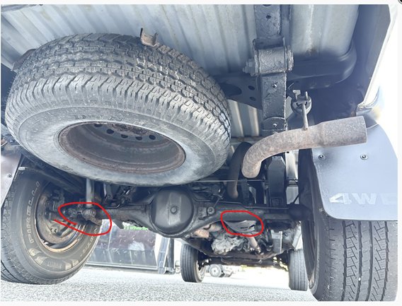

    Here you can see more of the holes in the muffler. I am curious to know what you guys think of this U-Bolt plate, does it look like this is messed up? What are your thoughts?

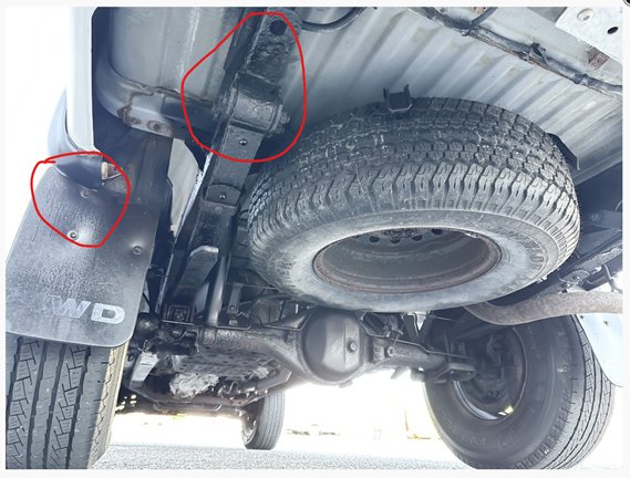

    Here you can see more of the overspray, it also looks like there is a good amount of rust flaking on the leaf springs. The interesting part is the rest of the bed and everything else for that matter seems pretty normal, especially for the vehicles age.

    Very likely the frame was rotted prior to being fixed. Probably rolled back the odometer too. You've done your homework....now run.

    if so .....your third member, axles, rear hubs, and brakes may be toast....

    The frame probably rusted out (AKA "natural disaster") and has definitely been repaired. A closer inspection is required to determine if it's a good job or not. I wouldn't be as concerned about the coating, I'd chock that one up to "lesson learned" after paying for a frame repair.
    Did I miss it or did you never mention asking price?
    Mine is an '03 and had 63K when I bought it, sometimes you get lucky, but what other posters are saying is true: 23 years old, it's going to need work, maybe a lot. That's just part of the deal with an older vehicle.
    I can't really see it. What should be there is the corner of the skid plate. The other side has a mounting bracket reinforcement bracket on it and is a common place for it to start rusting through; mine has it. The outside of the skid plate is rusted through but the bracket is welded on well and holds pretty strong.
