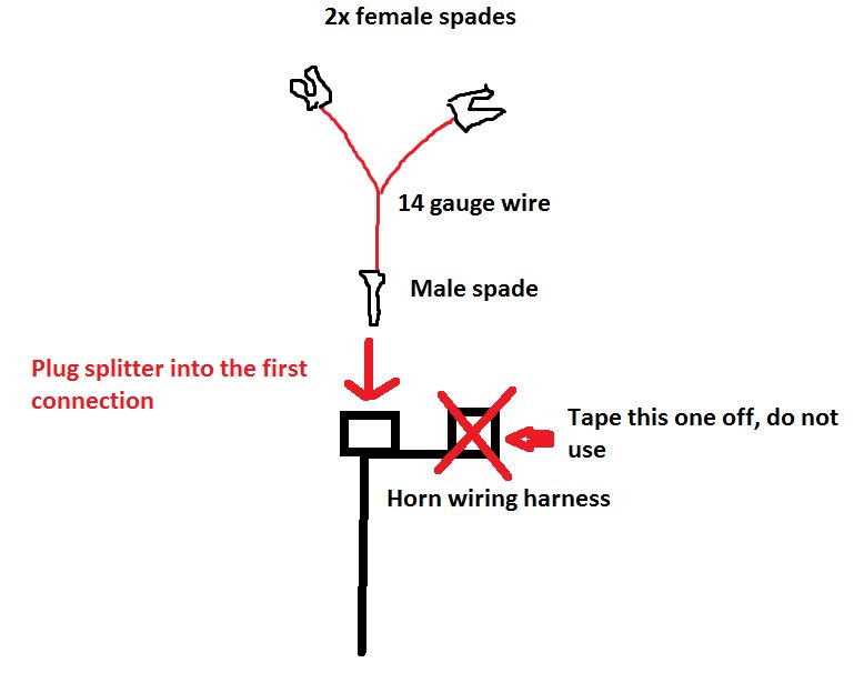

    For what its worth, you can run 2 sharptone horns (1 kit) without a relay off the stock wiring. All you have to do is make an easy splitter to power the horns.
    Edit: and make 2 simple ground straps: spade terminal on one end, ring terminal on the other, ground to horn mounting bolts works fine.
