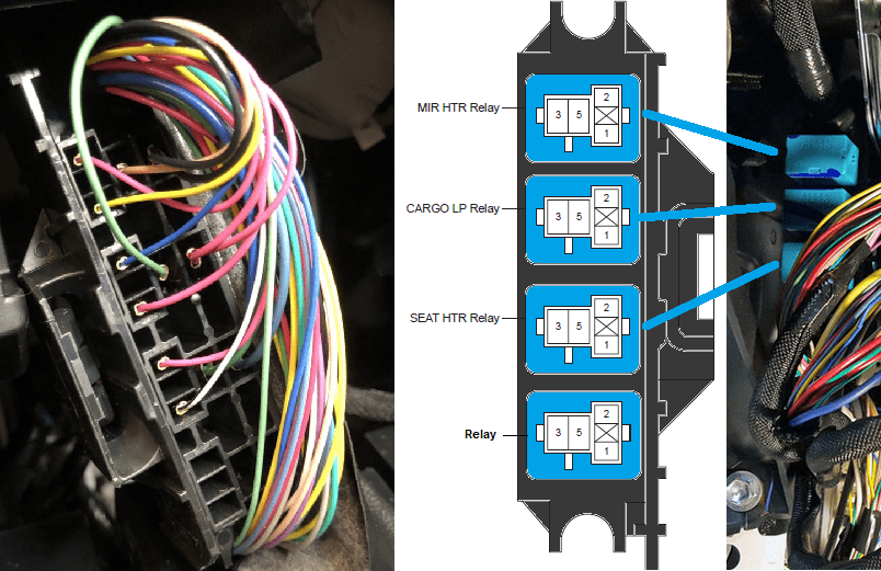

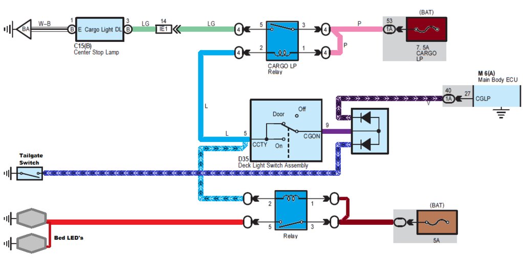

    Get parts and assemble it yourself:
    Can make it OEM style:

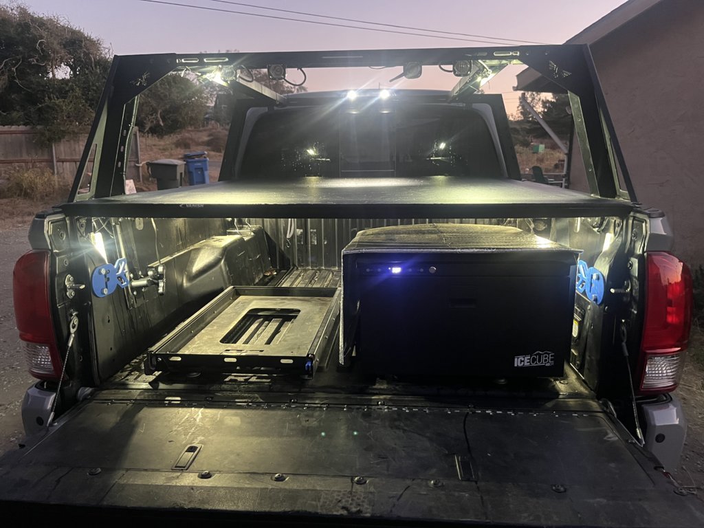

    Got the oem, and the Vleds and some extra Vleds tied into my bed rack. It’s well lit back there. IMG_1621.jpg

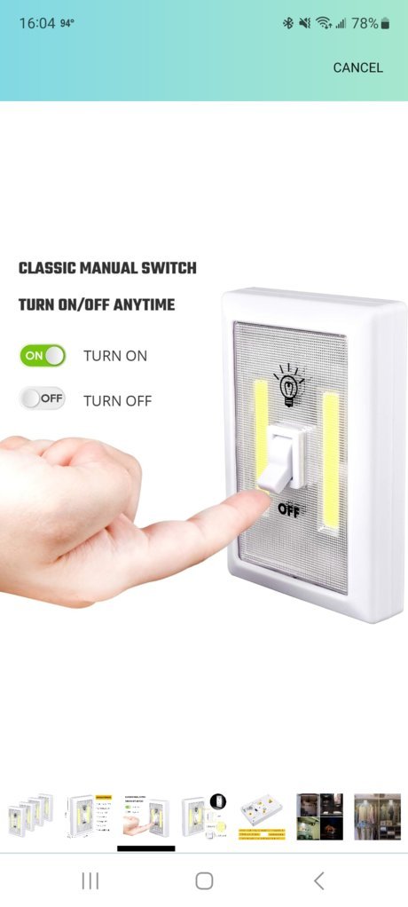

    I velcro'd one of these battery powerd switch lights to the inside of the bed. Super cheap redneck solution.
