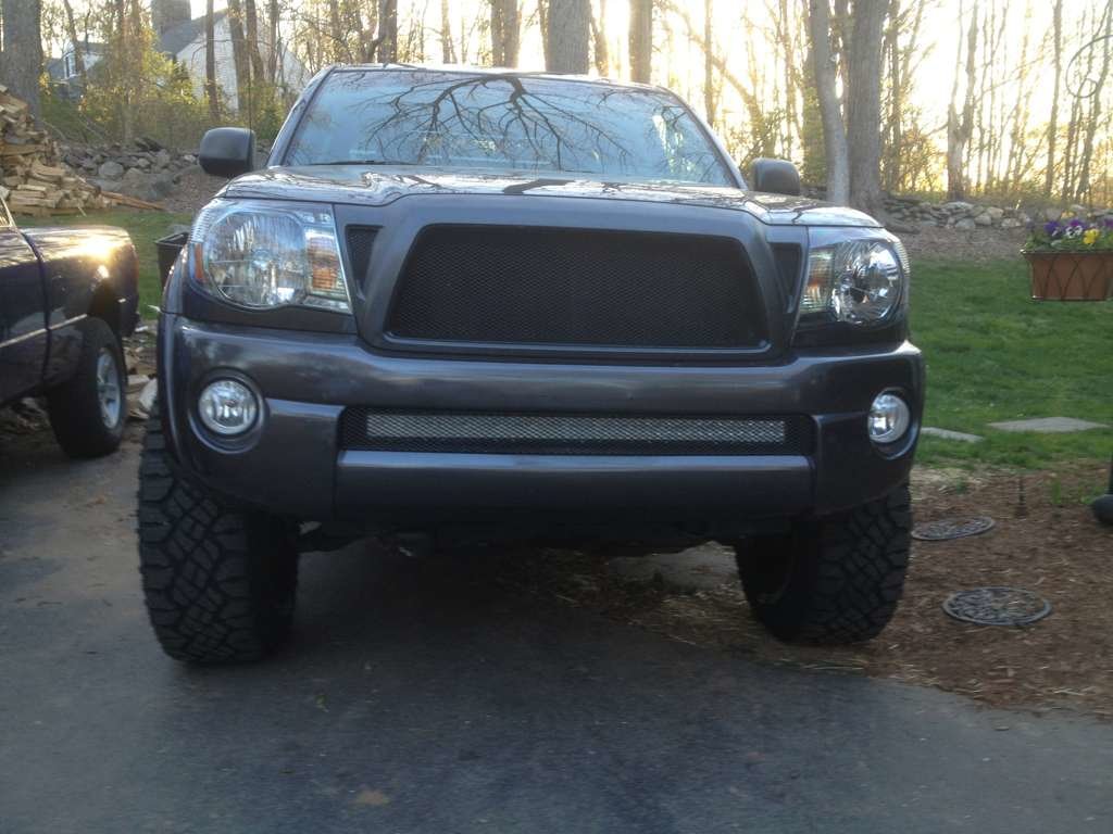

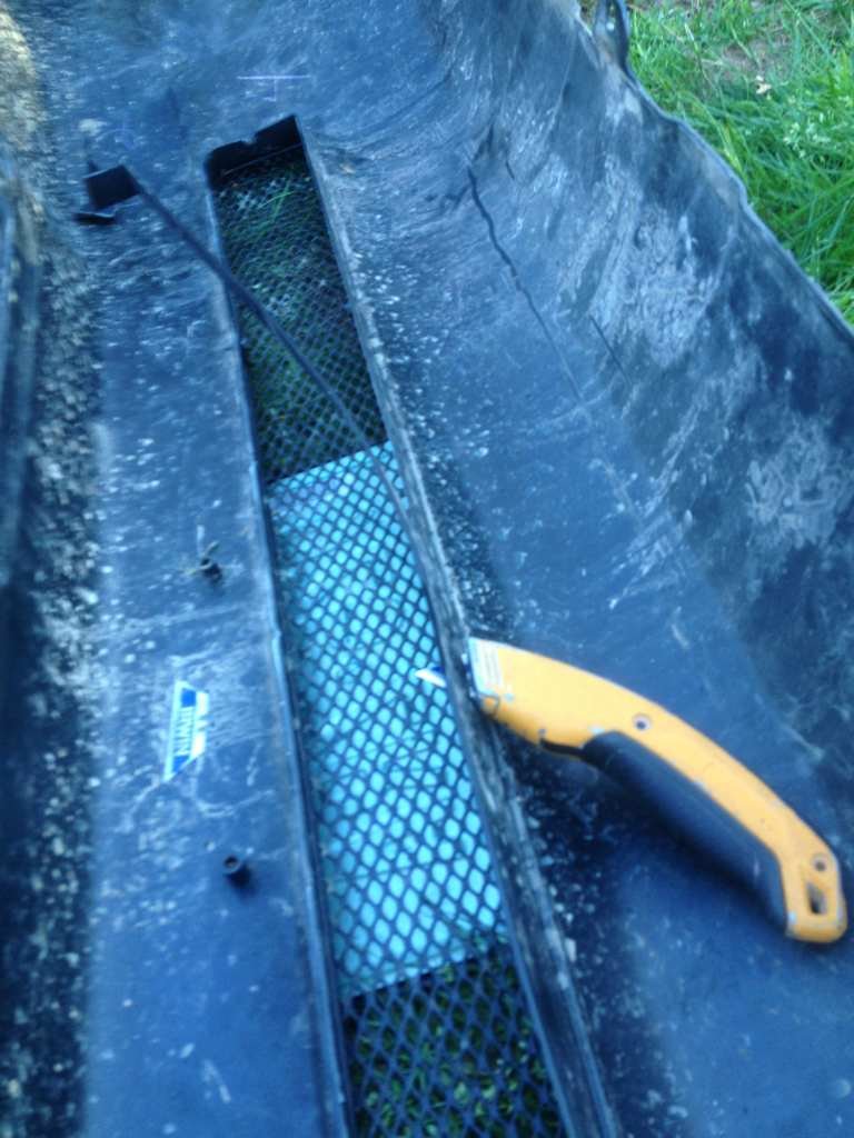

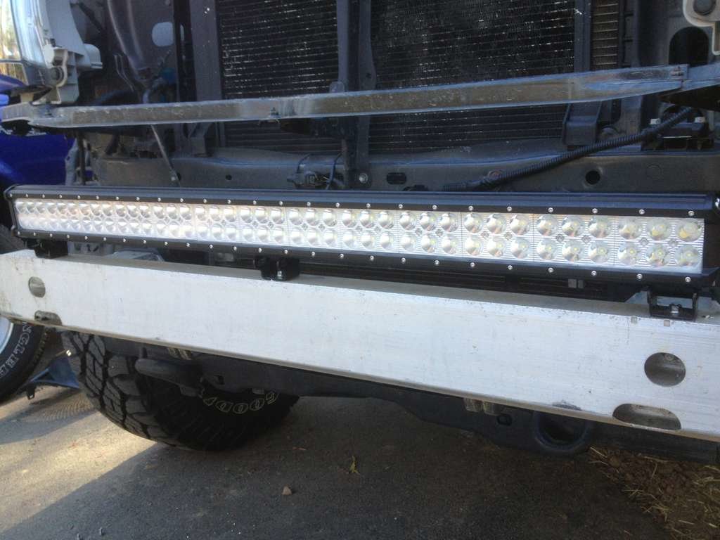

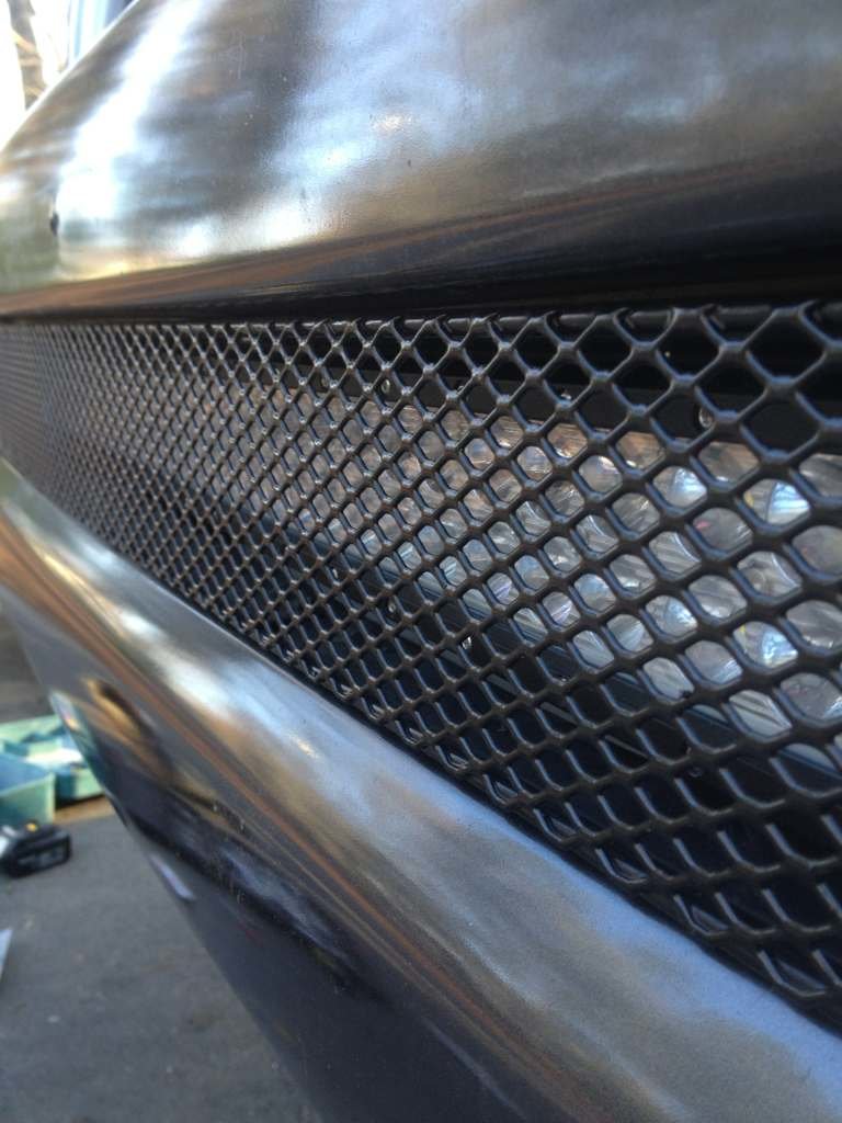

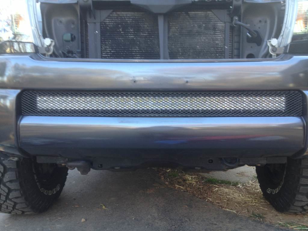

    If your looking for a cheaper light, not the best quality, KMD garage. The brackets that they use are the perfect height for mounting a light to the crash bar. Make sure you get the sliding bottom mount brackets, not the side mount. Heres my 36" bar.
    Self tapping screws holding the sliding mounting brakets to the crash bar
    A little trimming of the plastic inside the opening
    And there it is, perfect fit
