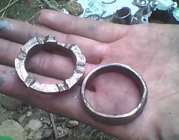

Looking for CV Bushing for Manual Hub

    The bad news, as I have ran into this before several times, is that you can not get just that bushing. It is normally a pressed fit bushing into the wheel hub itself. I have had to buy the entire wheel hub in order to replace that brass bushing. If that bushing is bad, then most likely the inner needle bearings are bad as well anyway, so the wheel hub would need replacement.
