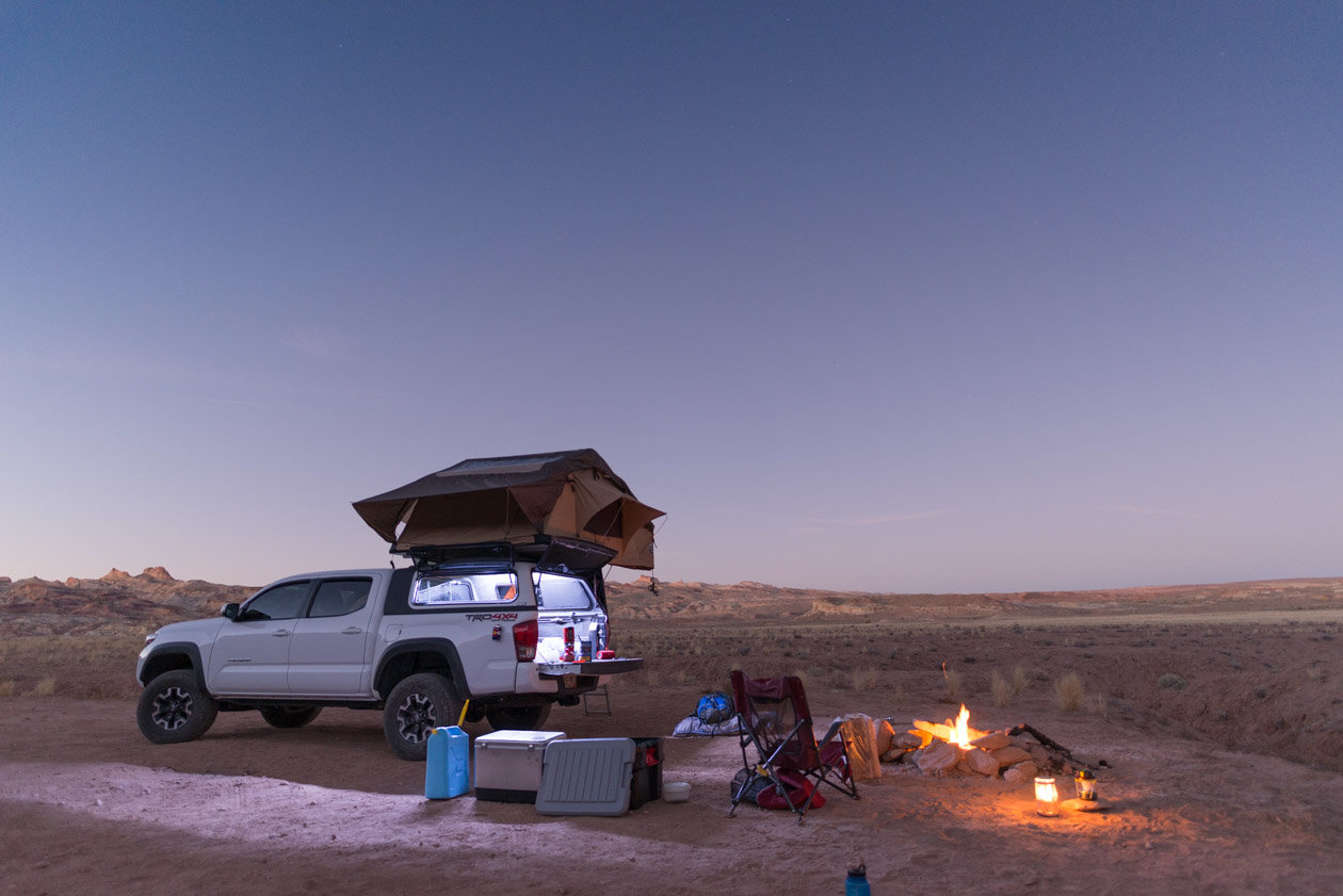

    jholc21
    jholc21 Well-Known Member
    Sep 27, 2015
    #165286
    652
    Colorado
    2017 White Tacoma TRD OR
    Bilstein 6112/5160 w/Dakars Leafs 255/80/R17 Cooper ST MAXX Skinnies 4.88 Gears TRD Pro Fog Lights Cali Raised 5D Combo Leather Seats LED Bed Lighting ARE Overland Shell
    I have a short bed but should still give you an idea. I have the 6112 with the 5160 and Dakar Medium Leafs. 6112 were set at 4/5 settings. After 3 weeks, I gained approx 1.5 front and 1.7 rear. I have an ARE Overland shell, Taco bedmat, Max Trax in the truck at all times. I also measured with a 170 lb Mt Raineer Rooftop Tent on the Cap to see how much I lost. Dropped 7/8" on passenger side and only 1/4 inch on the driver side. Not really sure why. Some variables are truck was not perfectly level with RTT on as it does not fit in garage with tent on. Also some variables could have been amount of fuel.
