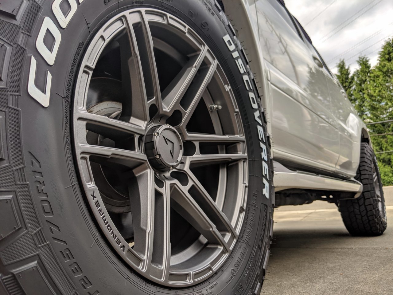

    Got them mounted!

    Your truck looks so perfect!! I wanna pull the trigger on these wheels too but can’t decide whether to do 265/70/17 or 285/70/17 (will do 2” lift) but with the 9” wheel I think I’m gonna roll with your setup so I don’t have to do a cab mount chop

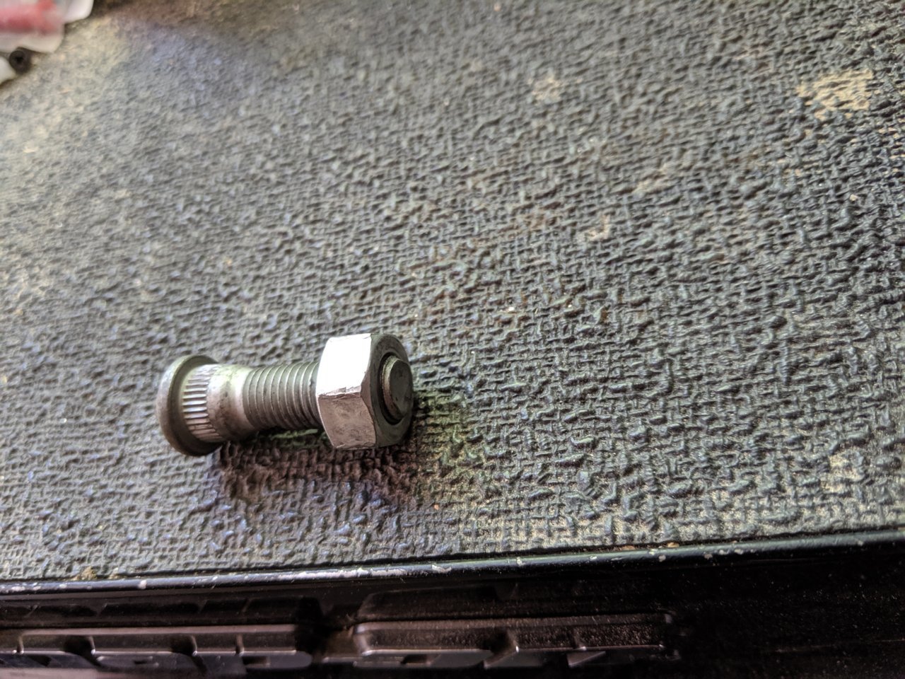

    How much thread engagement is everybody getting with the factory lugs? Did you end up needing to replace studs?

    As with most aftermarket wheels, factory mag lugs don't work with these. You will need acorn/conical style lugs, which achieve just over five revolutions of purchase on the studs. (Less than half of OEM engagement) Extended studs would be highly advisable.

    With the VR lugs on the factory studs, you’ll get 5 1/2 to 6 turns once torqued. The picture shows a standard m12 nut on a factory stud for reference, at 5 1/2 turns.
    I replaced studs. I bought a set off eBay, that were 60mm vs the stock 40mm. I ended up cutting them down to about 45mm. It looks like you can’t get anything over 50mm in on the front without pulling the axle. It seemed like 50mm was going to be too long and top out on the threads on the lugs. 45mm seems to be the sweet spot.

    I am not an expert by any means so I ask this looking for an accurate answer...I LOOKS like the nut is fully engaged on the stud. Shouldn't that be sufficient?

    It's less than half the width of a LUG nut.

    Again, just trying to understand. As long as all the threads are engaged and the lug is torqued, I would thing that would be enough. I could understand if not all the threads were engaged...
