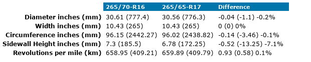

    Dropping to a 65 profile in the 17” would be effectively the same.

    I am already running 265/70/16. So going to a 265/70/17 shouldn't pose a problem right?

    That's a 1" taller tire. I'd be at least prepared to mitigate a little rubbing. It could be as close as boiling down to what particular tire you go with.

    Like jmneill said, that would be a 1” larger tire. All sizes have stayed the same, but the rim increased by an inch, so the tire increased by an inch. To keep it equivalent to stock, you would have to change the aspect ratio and have a shorter sidewall, or change the width and have a narrower tire, which would then shorten sidewall because aspect ratio is a percent of the tread width.

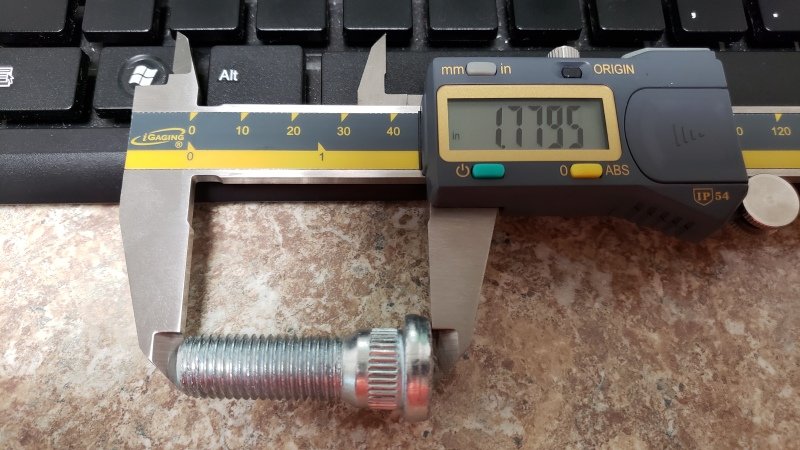

    Heads up to have you're cutting tools on hand.
    Overall length of the wheeladapter.co studs is 2 3/4. They're a full 1" longer than stock.
    If you'd post a pic when they come in I'd greatly appreciate it. (I'd like to see the overall look, shoulder, serration, etc.)
    A pic of ours, for reference.
