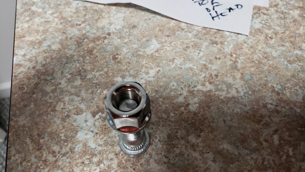

    Just a visual reference for anyone having a hard time wrapping their head around this.
    This is an OEM Tacoma stud catching 5 1/2 turns on an ordinary (short) open ended lug nut.
