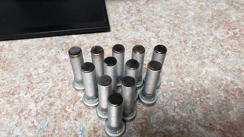

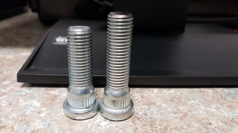

    My studs finally made it in today.
    Cut the first 12 down to just over 6mm longer than OEM.
    Used an angle grinder and Lenox cutoff wheel. Took about an hour and a half. Nothing to it.
    @Airborne22
    I'm going with the Venomrex slim spline lugs, since I already have them. I'll likely replace them somewhere down the line with some Gorilla lifetime lugs. Plenty of room in these wheels for some lugs with more beef.
    @WyoRoadDog - Thanks for confirming my measurements.
    EDIT TO NOTE: Because someone is going to wonder... The discoloration is not heat related. It's cold bluing I did after the cuts, because I'm OCD like that...

    What is the new length?

    I tried to stay between 46 1/2 - 47mm from the shoulder to end of the threads, for an overall gain of 6 1/2 -7mm of thread and an additional 4 1/2 revolutions of thread engagement.
    I'll keep 6 open end lug nuts in my gear bag in case this is too much thread for OEM lugs, in the event of needing to use the spare.
