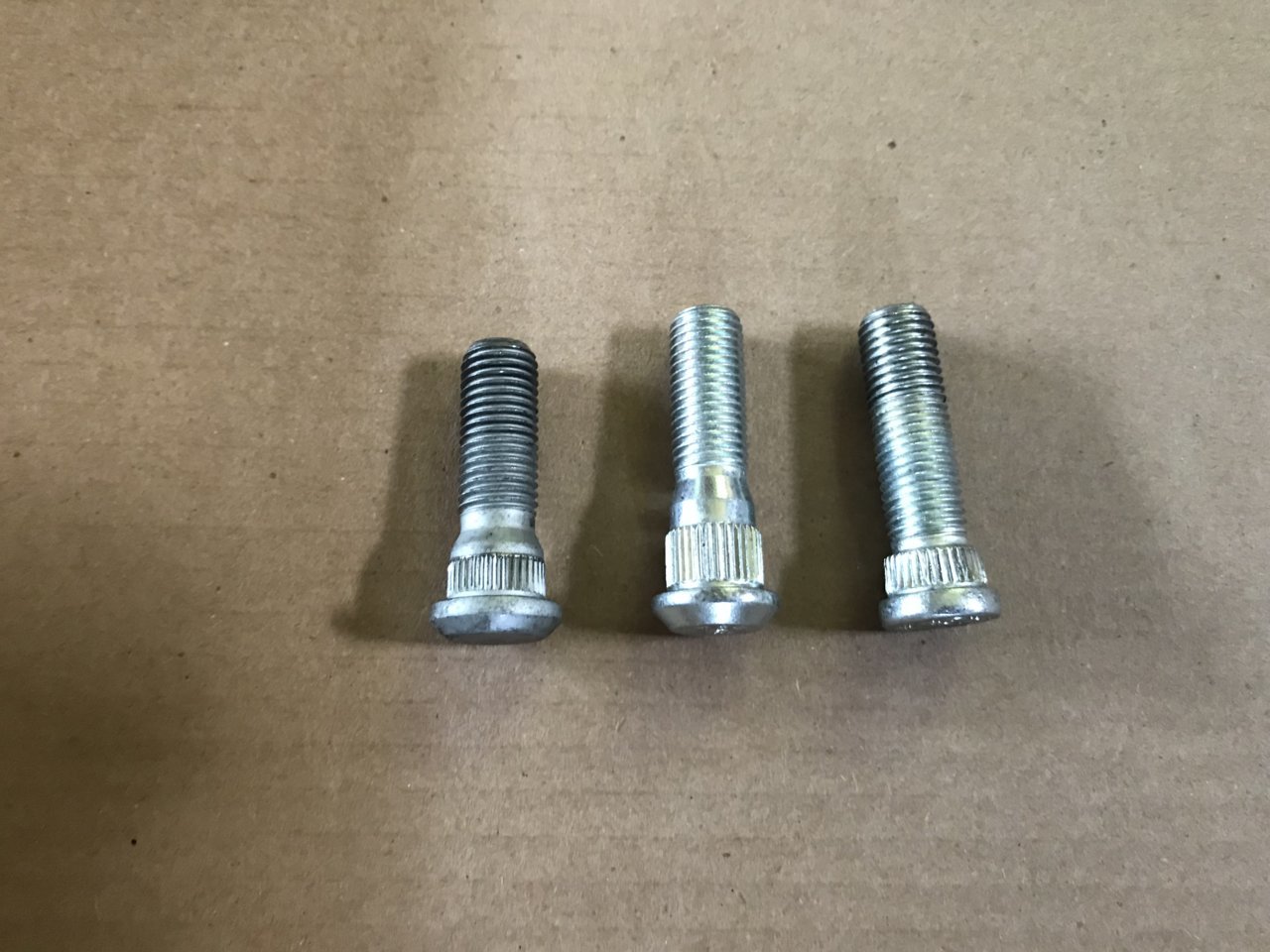

    Yes 462s. the shop put on a few 414 which worked too. I went back and corrected them over the weekend and all is good so far, you’ll get about 8-9 turns. When the shop installed them they weren’t seated all the way. About 1-2 mm shy so after replacing the drum covers I put on the ebrake and got that last turn. The shoulder is a bit longer but it clears the drum covers and bore on the rims. I think you can go with either stud there is more knurl on the 462s so that’s what I went with. The 414s are also a bit wider in diameter.

    Stock 266 vs 462 vs 414

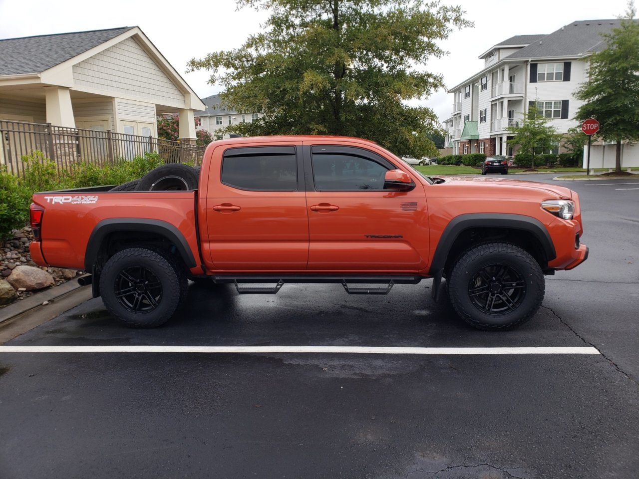

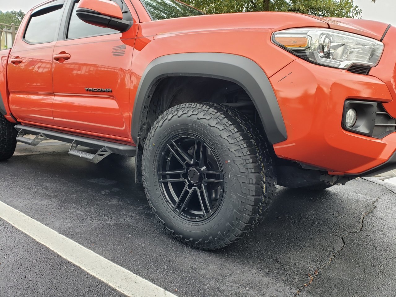

    Finally got mine mounted!!!

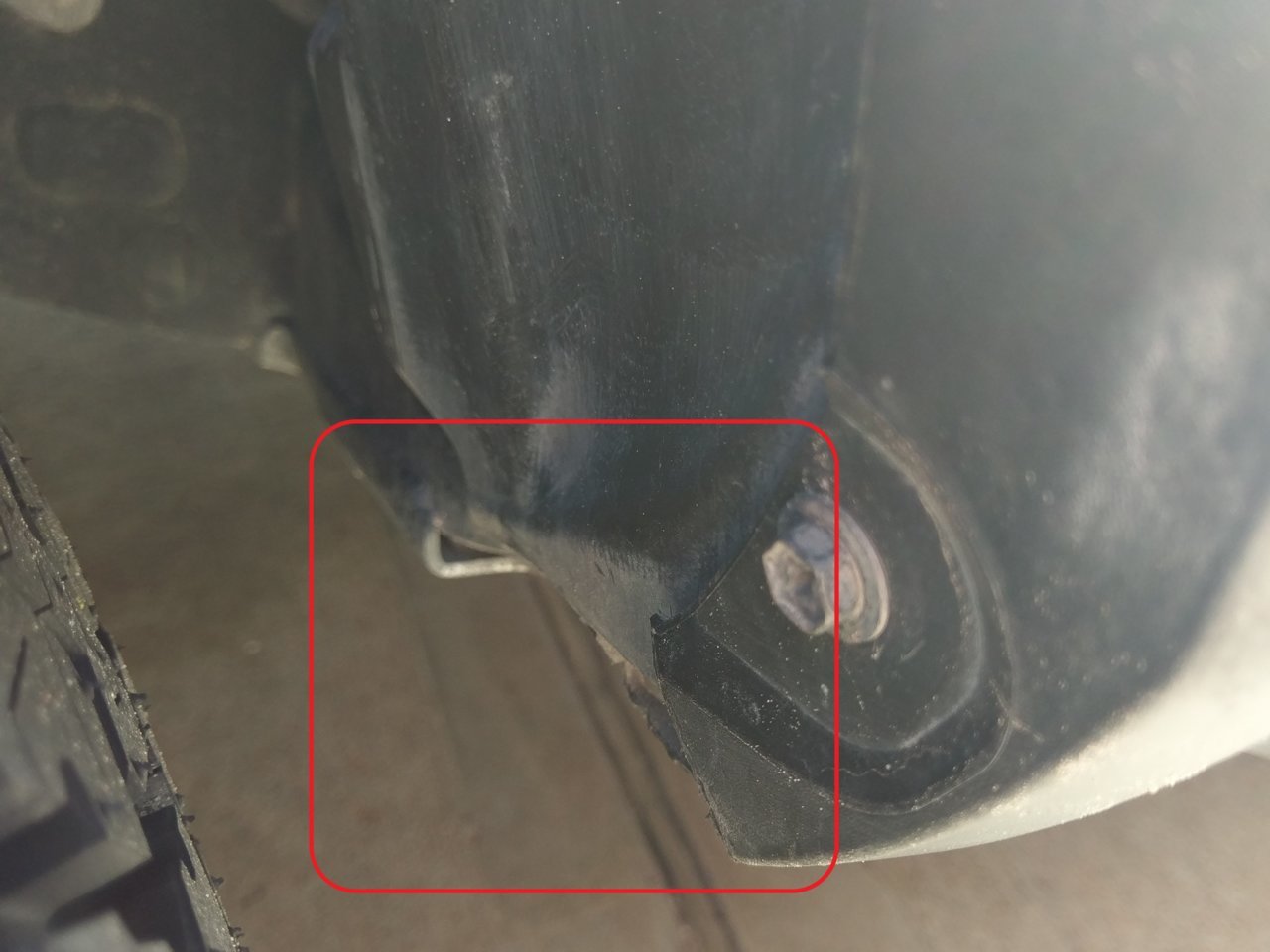

    I got mine mounted today with wildpeaks 265/70/17s. There definitely is some rubbing with that size tire.
    I didnt notice too much in the front but it was very close. The back rubbed quite a bit. I removed my front mud flaps and had to trim a little bit off the bottom of the fender flare. That seemed to have removed most of the rubbing but its still rubbing just a little when reversing. I may go back with a heat gun and shape some of the plastic a bit and see if i can get it a little better. I might also try and cut out a notch in the OEM mud flaps and see if I can run the flaps too. I prefer to have the flaps to stop rock fling.
    Here's the cut i made. Same of both sides.

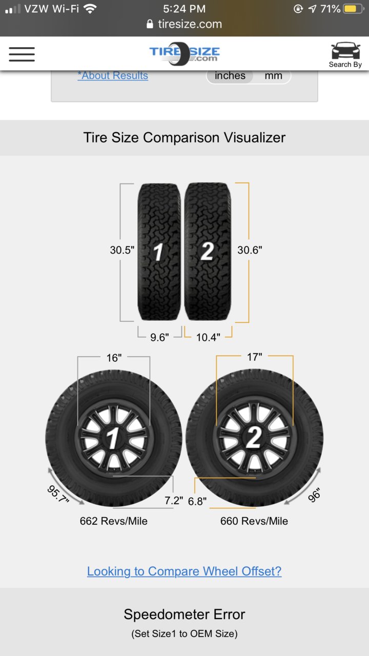

    265/65/17, which is the stock size, will be the biggest size with zero rubbing (i think). If you bump up to 265/70/17 you will have trim a bit. I'm on 285/70/17 and had to trim quite a bit, adjust caster, and do a CMC so that I didnt rub.

    Stock is 265/70/16

    265/70/16 = 265/65/17 for all intensive purposes. The OR comes on 16's and the sport comes on 17's. Also, these wheels are 17s, so those are the specs I was giving him.

    Nice! Yeah I ended up changing out the studs. At first I was trying to seat them flush with a breaker bar and it was taking forever. Finally got fed up and bought an milwakee m18 impact. Got the job done in like 1.5 hours after that. Also, I think the dorman part number is 610-462, not 642?
