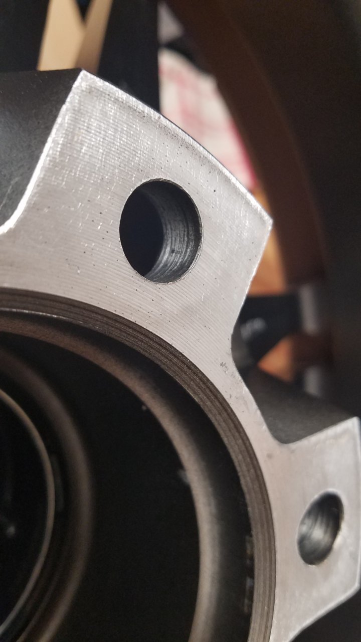

    I decided to take a pic of the thickness of the wheel mounting surface to the bottom of the 60 degree lug seat. This appears to be 3/8". Why is this considered "thick"? How much less could it really be? Is any other wheel much less? The issue is the short studs on Tacomas.
    I will say that this batch was on backorder direct from Vorsteiner. Perhaps mine are thinner than previous batches? Maybe I got lucky...for once!??

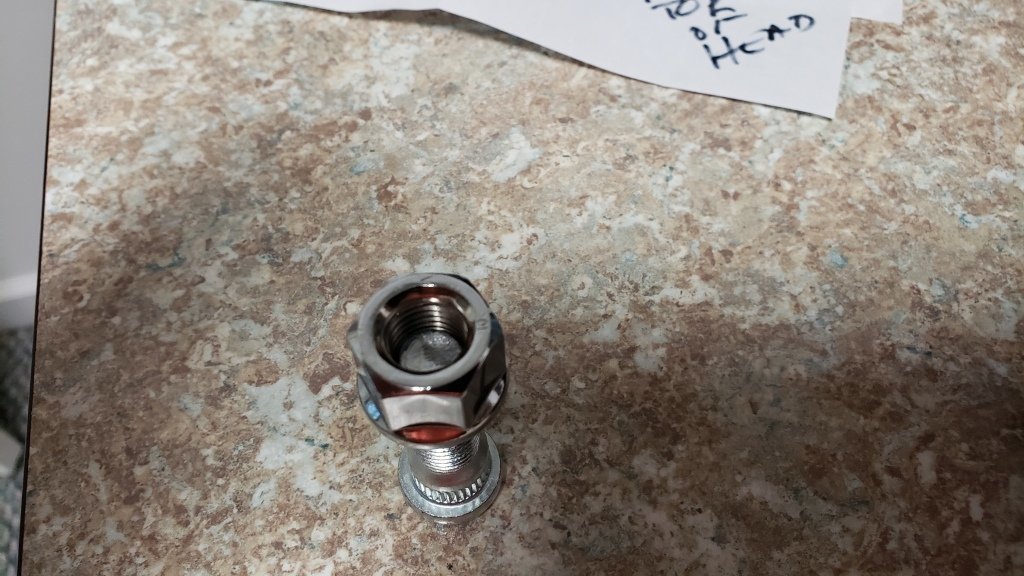

    Just a visual reminder with an open ended lug nut of what the 5 1/2 revolutions of bite actually looks like.
    Maybe that's enough, maybe it isn't. Time will tell.

    yeah that’s scary, and what does the normal amount of revolutions look like?

    OEM setup is triple that. ~

    From my (Pretty Basic) knowledge of thread engagement for a bolt you generally want a "few" threads showing on the outside face of the nut. But on a "lug nut" style nut with a closed end, the general rule of thumb is you want to get thread engagement equal to the diameter of the stud. So, in this case I would say its sufficient.
    Now with that said, I would definitely change my studs if I was putting these wheels on my truck.

    I agree with your analysis with the exception being that these are 12mm studs, and while I don't hand the parts in my hand at present, I don't believe the math works.
    Before replacing, I was getting 5 1/5 ~ revolutions of purchase on the OEM studs.
    @ the 1.5mm thread pitch X 5.5 revolutions, that comes up significantly short @ only 8.25mm of purchase.

    I hear what you are saying. I don't know how much the lug nut threads onto the bolt with one rotation. Nor does it matter that much to me.
    To cover 12mm you would need to use up about 8 threads total. So that is all I would pass on to anyone; If you feel like you got 8 threads, run it. If you don't, get some longer studs.

    Agreed, and that's a number that in my experience, is not happening with these wheels without new studs.
