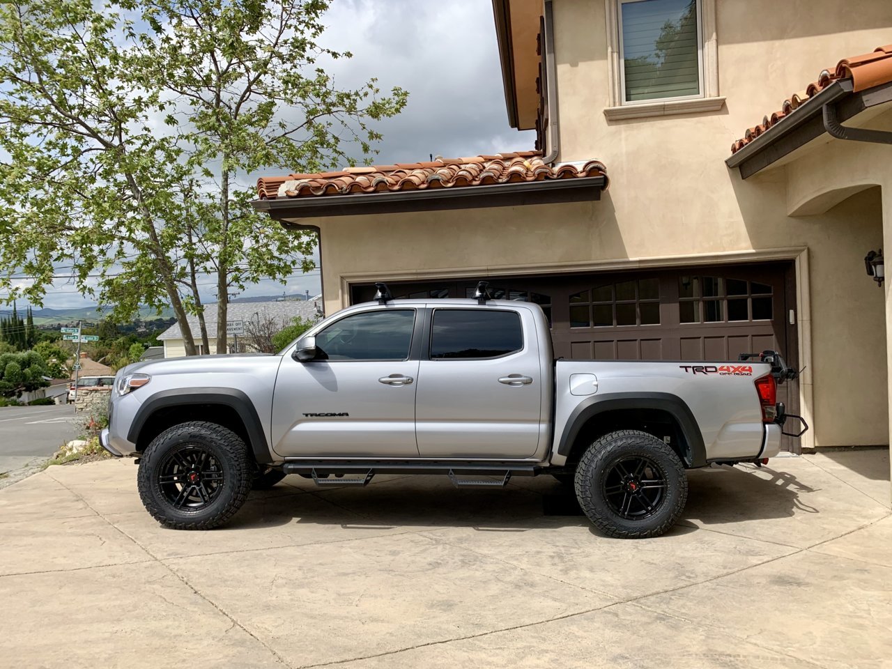

    Stock off-road with 265/70/17 K02’s. Like the rest of you I have some rubbing which I attribute to the offsets and wider rim. It’s a very small amount of rubbing (by only a 1/4”) that you could live with, but it surprised and irritated me because I specifically did not go 275/285’s because I did not want to lift right away. Oh well it just pushes my timeline to put in 5100’s immediately. By the looks of it nothing an 1.5” of level won’t completely cure.
    (Oh and almost forgot to add the most important part: these were not my 1st choice of wheel and I did want a quality higher end wheel but they turned out even better in person than I anticipated would recommend them to anyone)

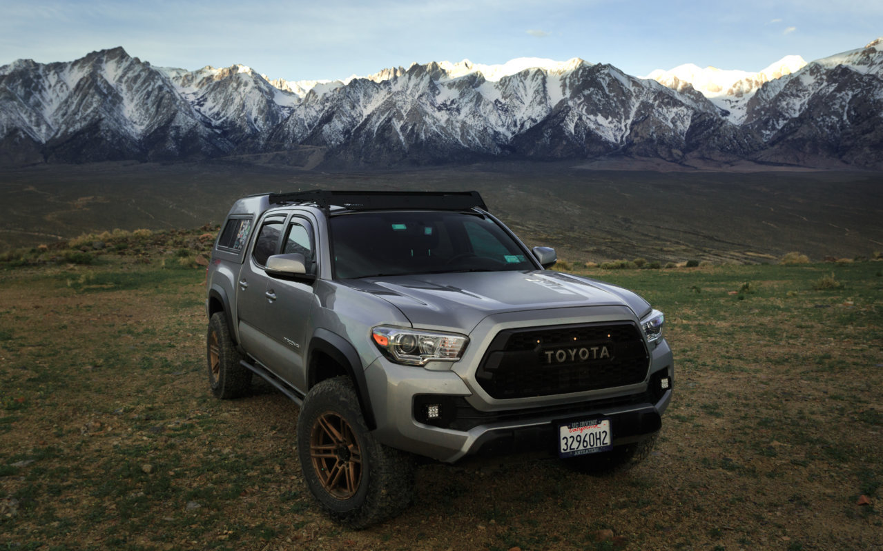

    There'll be more photos, but here's one for now! Love the wheel and tire setup. Expect to see much more of this truck :)
    Thanks again to Airborne22 for hooking up the discount!

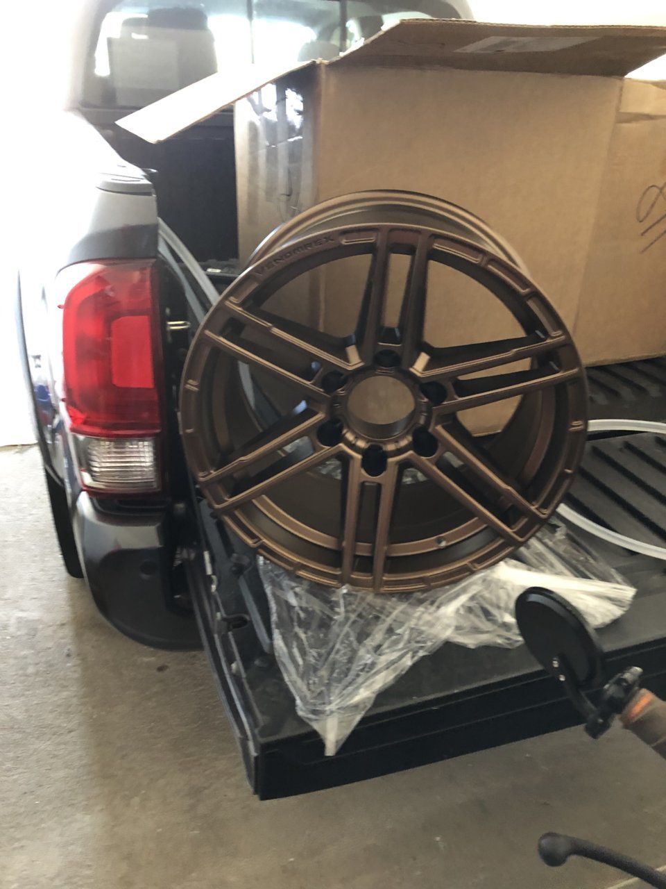

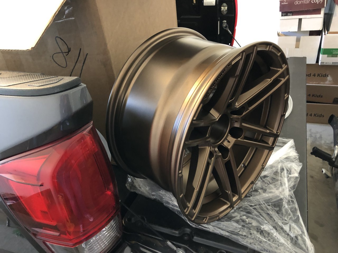

    Got mine in yesterday thanks to Airborne22. Looks like they were well taken care of during shipping. Only opened one box though until I order some tires. No one up here carries the ridge grapplers that I want so those will be special order. Hoping the bronze doesnt look wrong when they get mounted against the MGM paint.

    Whooo!!! Good choice on the bronze. Was kinda hesitant about going with bronze myself, but they ended up looking so good once mounted.

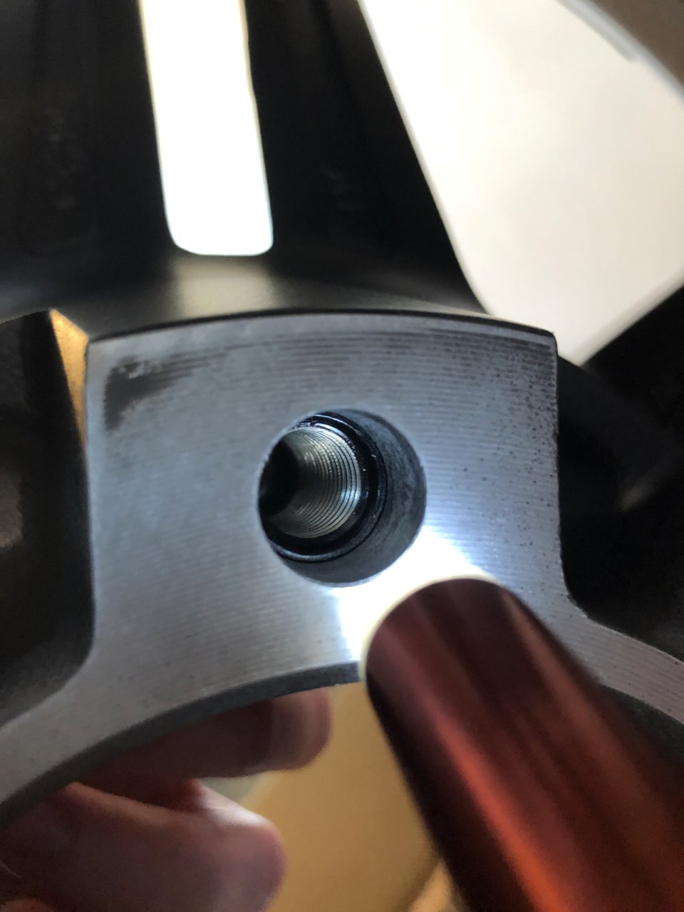

    A few....
    Not sure I'm understanding this. It seems more than one person involved in this thread has used the lugs you say won't fit. The product description on Amazon states
    • Narrow lug nuts and key fit in virtually all aftermarket wheels
    Are you sure you have the correct Gorilla lugs? If so, what are you planning to do??

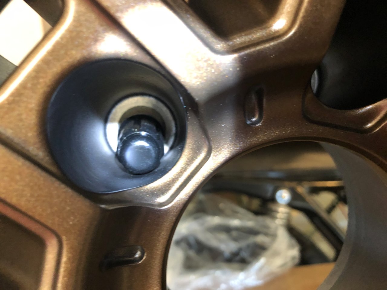

    The lug nuts fit just fin inside but they don't seat correctly. After measuring I'm not sure how anyone is running the extended threads with them seating properly. They will bolt on but the conical seats wont line up. Only option is to get the standard length lug nuts. And a 21mm standard socket fits inside these so since there is so much room I may end up going with a 19mm standard hex lug nut. I've uploaded pics for reference. Pretty much the edge of the lug nut rides on the edge of the seat on the wheel upload_2019-4-13_14-55-12.jpgupload_2019-4-13_14-55-26.jpg
