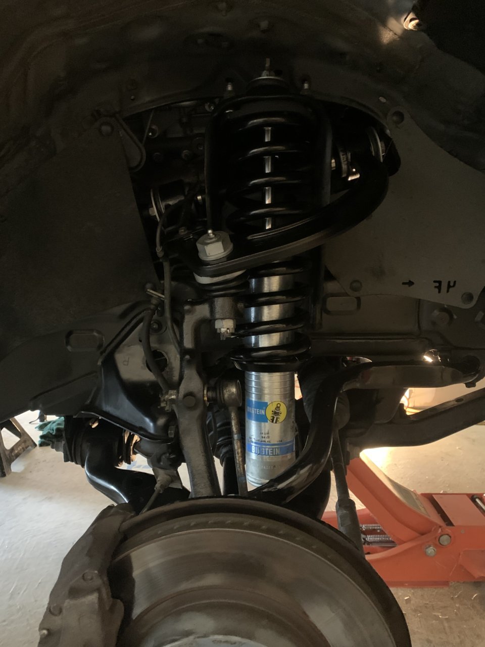

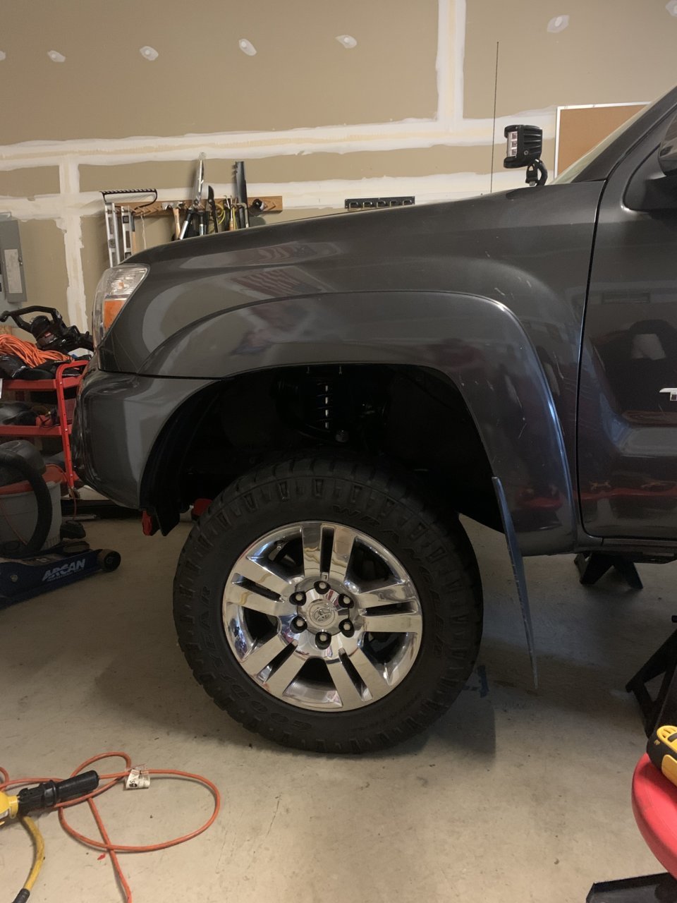

    So I finally got the 6112’s installed up front with the new UCA’s . I’ve the coil overs set at the 5th ring for what is supposed to be 2.5” but after the install, it’s more like 4.5”.. will this settle after I get the alignment and finish the RXT leaf pack install in the back? Those are my stock 18” wheels and it seems really high

    lol, something isn't right here. pics of actual suspension mods?

    front passenger

    Are those the standard 600lb springs? Maybe its just the smaller tires that make it look goofy. Either way, if those pics are right after getting it off the jack stands, it should settle.

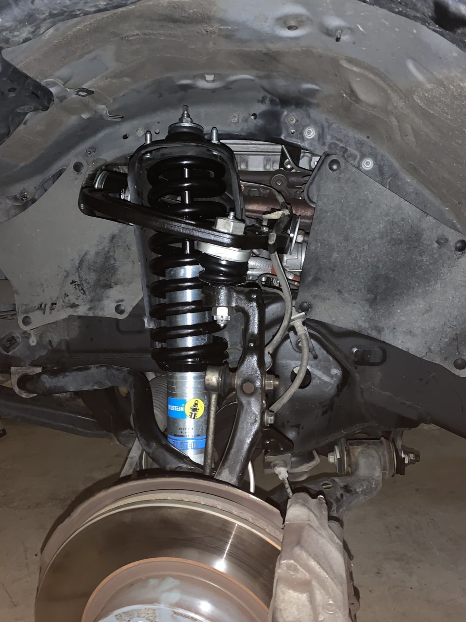

    Looks like the spring perch is on upside down. Could you post some up close pics of it?

    Without knowing if anything is installed incorrectly, have you moved the vehicle yet? When you back it up the suspension will lose some height compared to when you just install and drop it back to the ground. Probably not 2 inches worth of height but it will be some.

    x3 on getting the suspension cycled a bit by moving it. You'll likely lose 2 inches of height or so.

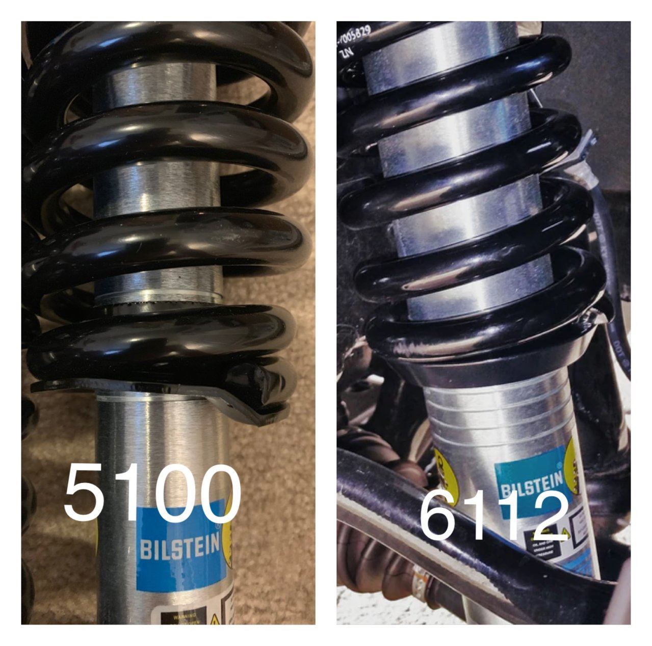

    The 6112 perch is different than the 5100, it actually looks right for the 6112.

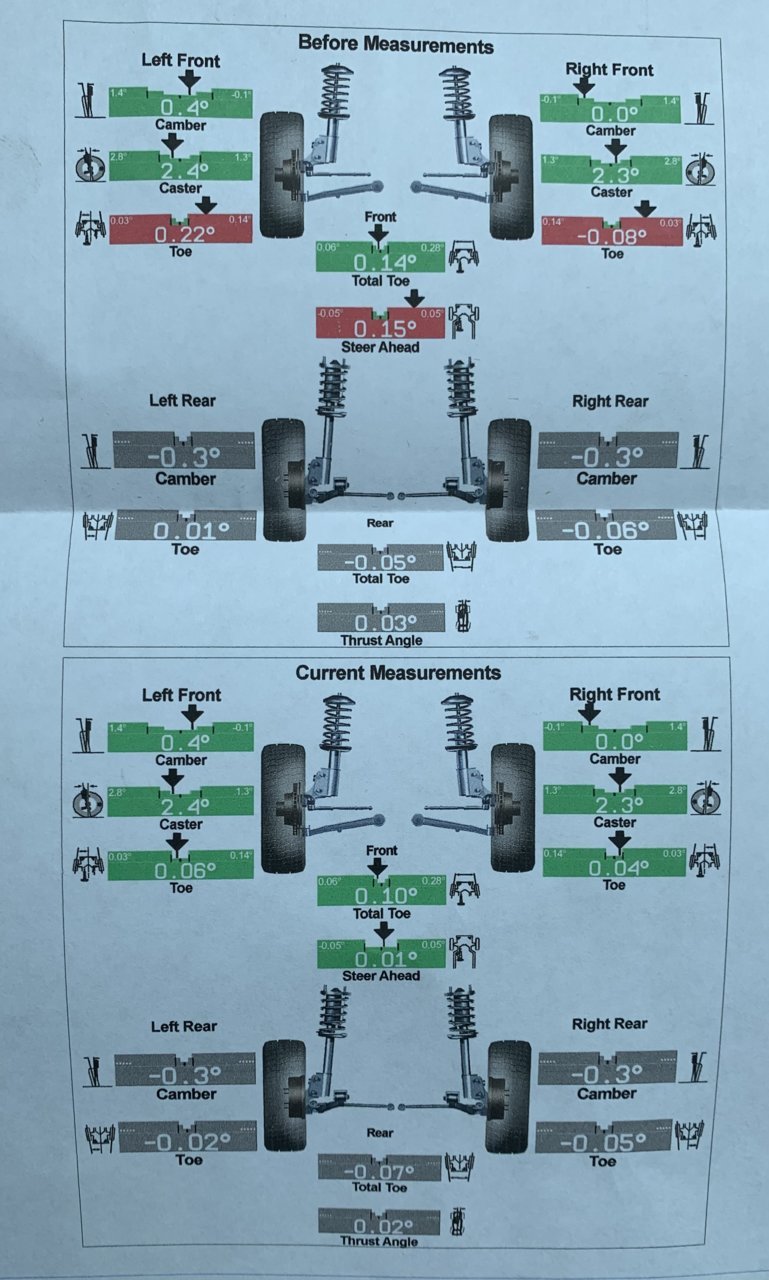

    Very pleased to note that my alignment is within factory specs…

    Update: having learned a LOT from this experience it was well worth doing it myself. Once I took the truck off the jack stands and got the alignment, the hight was exactly as I had expected. Thank you all for the great help. I’ve put about 3,000 miles on the new lift and jut freak’n love it!!!
