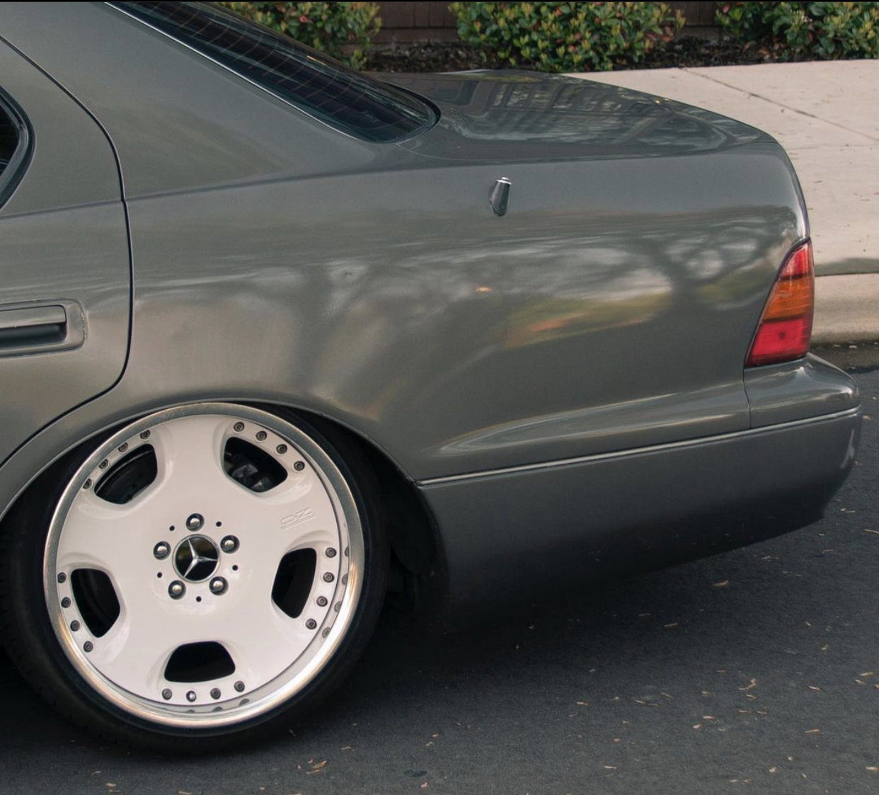

    The white looks really good (from the front at least)! My friend has a set of white wheels on his slammed 1995 Lexus LS400. His LS400 is like a cement gray color though
