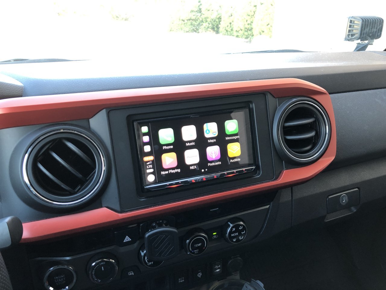

    anyone have finished install pics of double din HU? Looking specifically in 3rd gens.

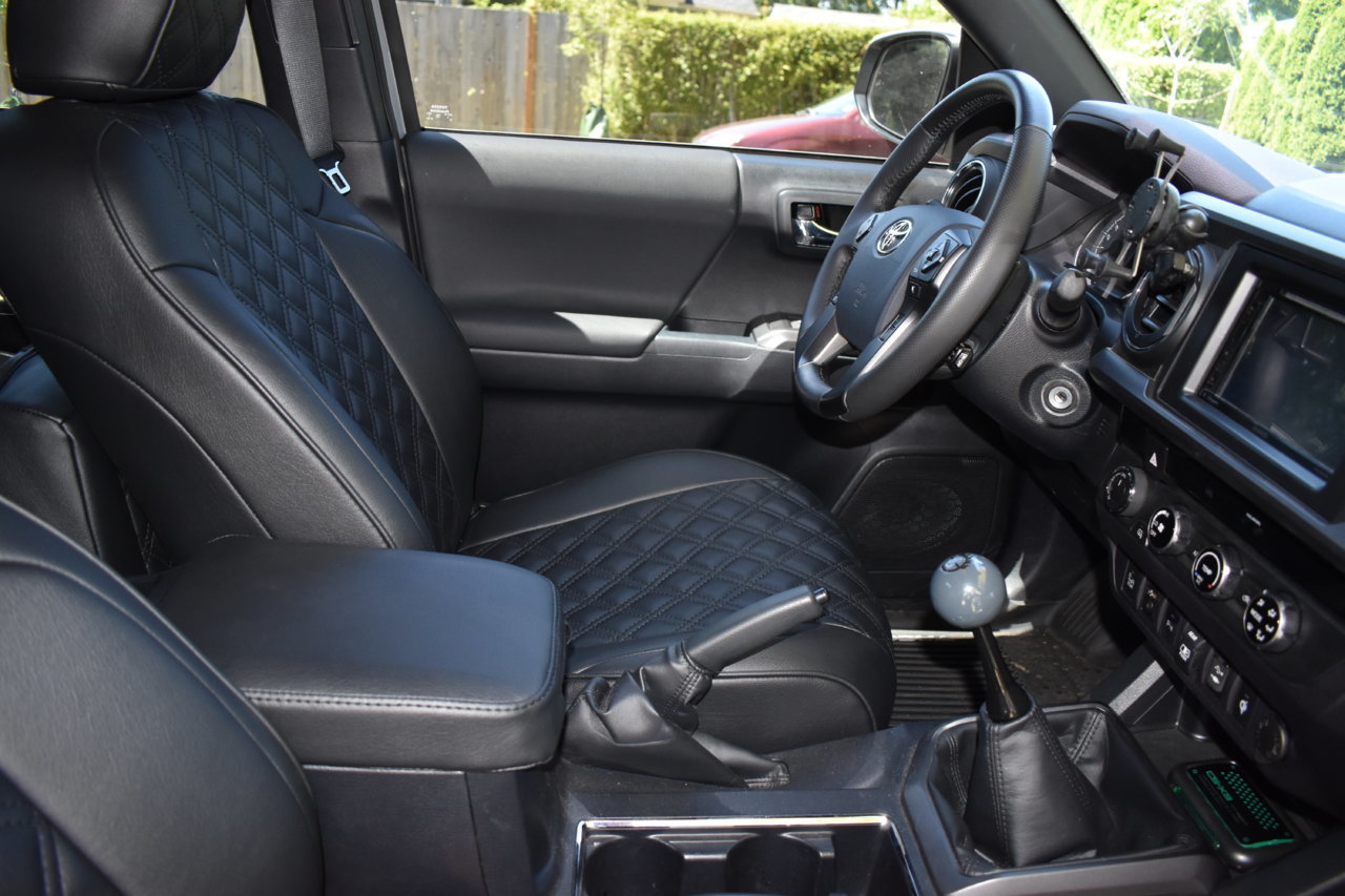

    You can just barely make mine out, I can get a better picture if you want.
    I personally would recommend a Kenwood over Pioneer unless you are planning to spend the extra cash on a capacitive touch screen. The Pioneers models that are on the low and midrange are noticeably slower when using their functions and changing screens. I've had both and will use Kenwood from now on. Both will be better than stock though.

    I've got the Pioneer w8400 in my truck and the w4400 in my shop. Love them both. Wireless CarPlay and Android Auto is wonderful.
    You can't go wrong with Kenwood or Pioneer. I install tons of both and they're both fine. I personally don't like Kenwood's menu layout, but I'm used to the pioneer menu so that's understandable. I can't say I notice much of a speed difference in the two when equal-price models are compared. My wife has the older Pioneer 1330 in her car, and it was the cheapest model with CarPlay. It's still very snappy and responsive. But no negative experiences with Kenwood either.
    Make sure to update the software ASAP on whatever you go with. These radios sit in boxes for months after being manufactured and lots of new firmware gets put out for them in the first few months of life (as well as after phone software updates)
