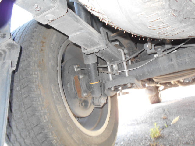

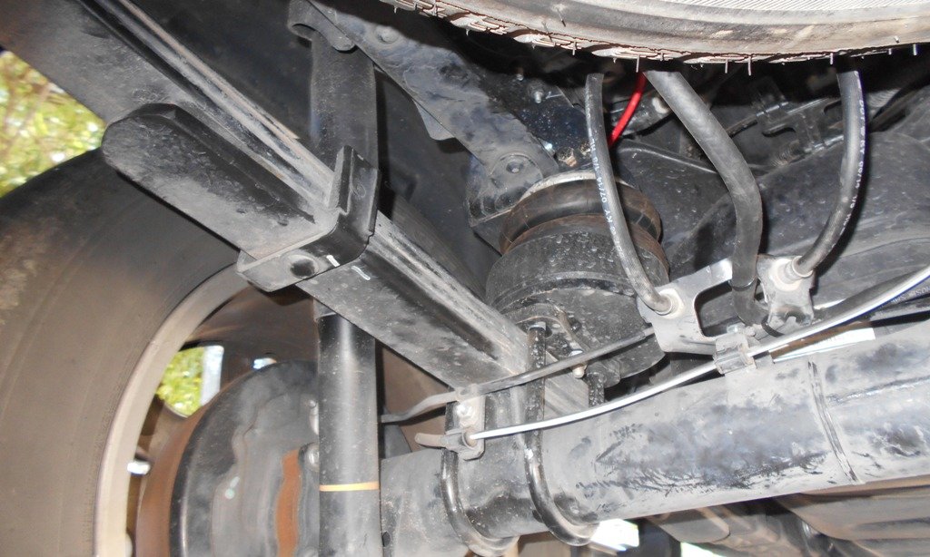

    I've had mine on for years - can't be beat when adjusting for load. The Daystars are 3/4" thick as I recall, so that's all the uptravel you can lose. The small bumpstop built into the inside of the bag (for internal self protection) plus the Daystar disc are easily accommodated by putting 5 pounds of air in the bags. Mine leak down in a week. I've bubble tested them numerous times - dunno where the leak is but it must be tiny. In all of the years, loads and road conditions mine have seen - I've never heard the "clapping" sound that others seem to hear. All I can figure is they've removed the valve stems or some strange thing like that and driven flat out on a washboard.
    These cups have been mounted on an All Pro U-bolt flip - 3/8 thick base plate welded on. The bags are not bolted to the bottom base so full drop of the spring will allow separation - like jacking for a tire change won't try to stretch the bag.
