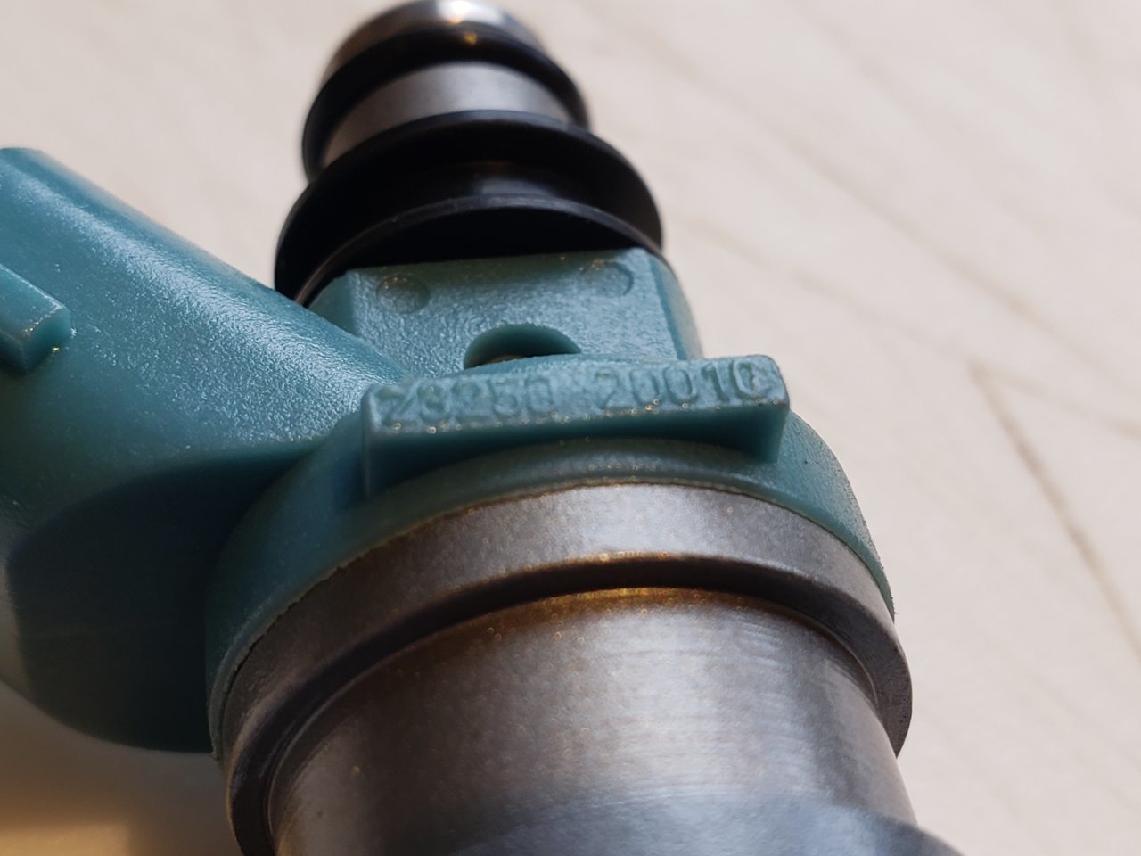

    FedEx delivered the reman injectors from motorwest today.
    This is what I ordered for my 95 3.4:
    https://motorwestperformance.com/product/mp210-6pack-l1/
    I received a set of 6 of these. Which are part #23250-20010.
    I can't find any reference to that part number on this site, and the google machine pairs those up with the 3.0 liter in the camry/solara/lexus.
    I spoke with motorwest and they assured me this is correct. I'm more than a little reluctant to do this job and then find out there's an issue.
    Thoughts?

    In this case I would trust MotorWest and install the injectors. I think the number on the injector casting is the number for the casting and not for the entire assembly.

    You have a picture of the whole injector? Those look right though.

    You'll be fine. Just go slow and be careful with the harness and connectors.

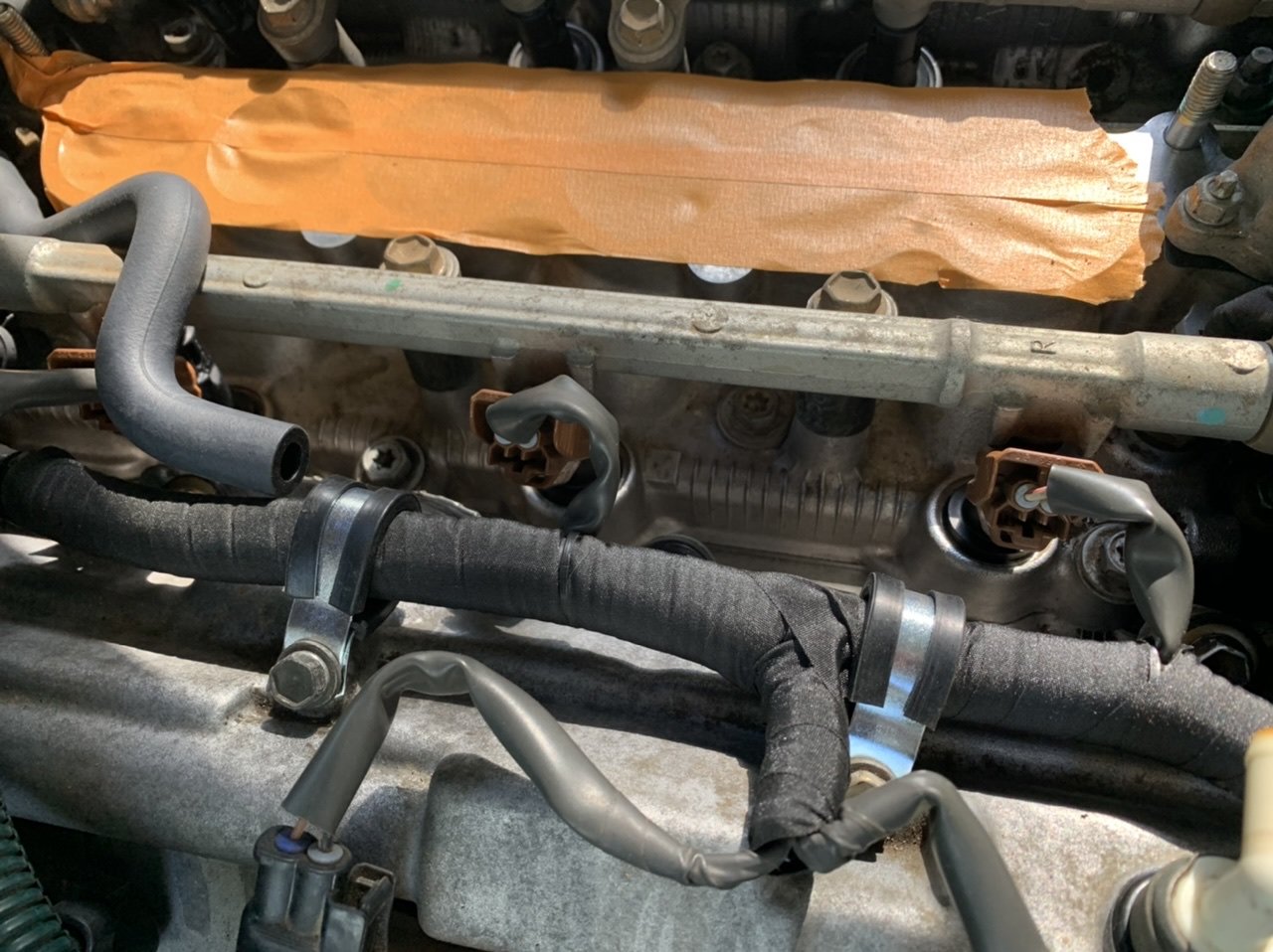

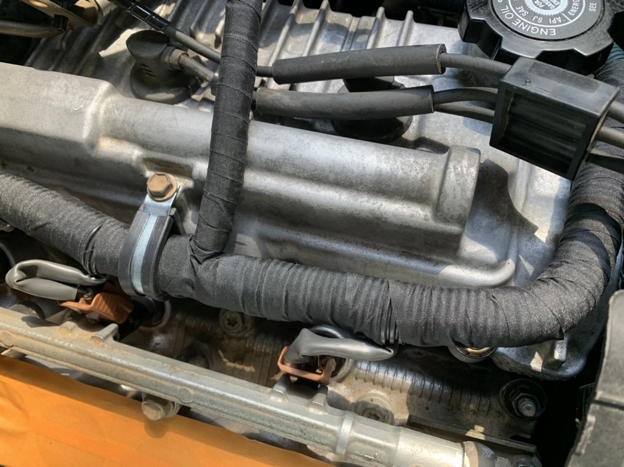

    Re rebuilding/wrapping the top of engine harness, I’ve done it twice. The first one I did the tape directly on to the wife itself. Second time (pictures here) I put split loom on the wiring first, then the high heat Tesa tape over the loom. This gives more protection from heat and a anrashion to the wire. It also lets you easily cut the tape off with a hook knife without harming the wire.
    Also- the first time I did this several of the fuel injector connectors were damaged. I bought pretty affordable replacements from Ballenger Motorsports and used crimps/glue lined heat shrink to splice them to the existing wires. Was a nice refresh for a truck with 320K miles.
