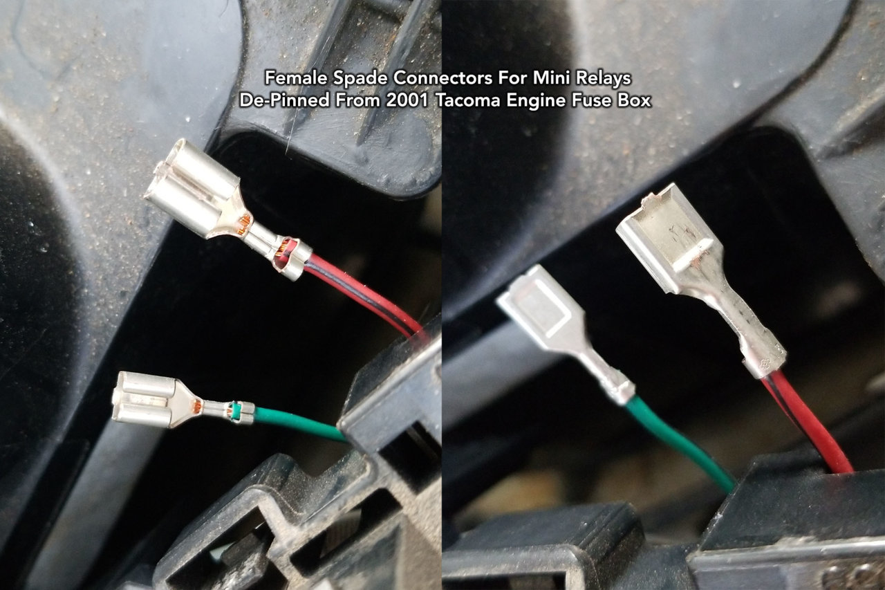

    I need some of these connectors to replace in my fuse box. I have never seen ones like these. The are for the small relays with the 1/4" and 3/16" spades. If I can't find these exact ones are there other ones that will work in the stock fuse box locations?
    Thanks
    Bill

    I am quite familiar with many types of connectors. None of the ones listed with your link appear to have the same locking mechanism as the stock ones I show in the photograph. I don't want to buy every type that exists to find one that might work.

    If you have a pick and pull or salvage yard in your area you may be able to pick up a whole fuse box for cheap.

    I have been thinking about having to do that, but I'd like to have ones that I don't have to splice the wires on if I can find them.

    I wouldn't know where to say to look for just the pins (maybe someone else does) most of them your gona find will already have wires. If your handy with a soldering iron it's no big deal to solder and heat shrink the wires, I do it all the time for wiring repair.

    I run into this quite often special application things built just for the manufacture .
    Only sold to the vendor that builds the Toyota wire harness .
    Your choices are sourcing used or finding male and female terminals that will also work in this application.
    Cheat use super glue to hold the female terminal in place this has saved me lots of grief .
    Good luck.

    Have you checked the Toyota terminals and connectors manual (available a number of places online, including a sticky in one of the subforums here, I think).
    That manual has for almost every connector a reference to the Toyota replacment connector part number. They're usually supplied as the connector pre-crimped to a short pigtail. Not exactly what you're looking for, but it might give you some ideas.
